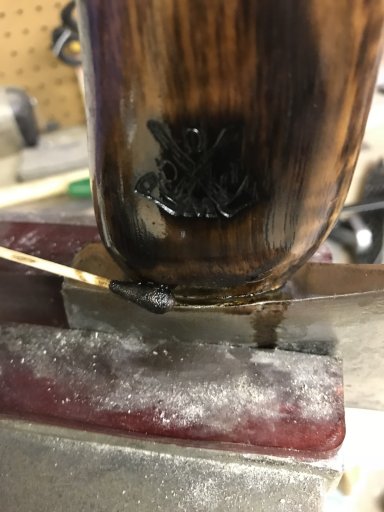

Use a q tip to apply the oil at the base of the handle and head as well as the top of the tool.
