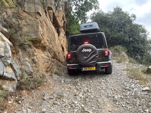

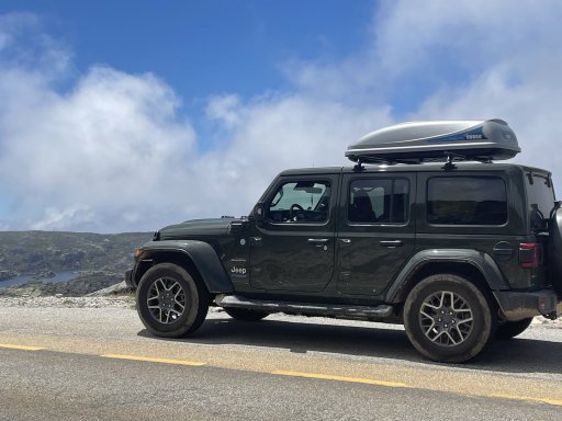

Honestly I would go a different route. You can get something like a thule roof box, even in a small one you would not believe the amount of crap you can put in one.
It is secure, locked, when you park some place., or maybe spend the night in a hotel on occasion. It is weather proof. It will do wonders to wind noise and fuel economy compared with those square boxes. Of course, an ammo box is a lot sexier and looks more like a serious overlander.. :)

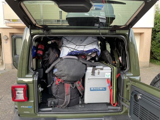

I had a medium size one, I would fit a 2 person aussie swag -those are huge - camping table, 3 sleeping bags rated at -10 - so big ones as well and 1 big camping chair for the bloody dog. That means now you will have space for your 12v system.
In the trunk I had Fridge, 2 maxtrax, 2 backpacks, another 3 small chairs, grill, stove, gas, all the small items., Ecoflow , foldable solar panel. I could not use the backseat - got a kid and a dog..
A jeep is pretty pathetic as inside space..
