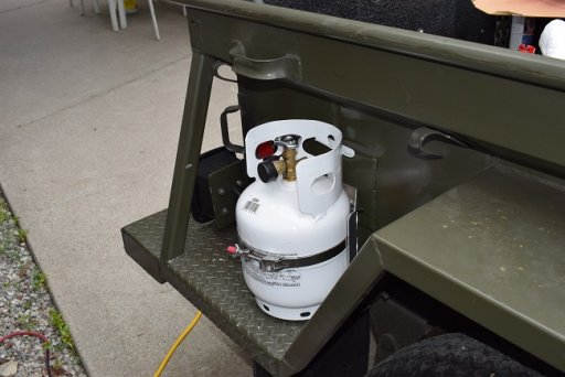

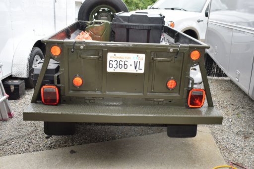

To start off, I cut off the tail light mounts and welded them towards the rear and lower so I could use the area for a propane tank mount, I mounted the Propane tank (Looks Nice)
Manchester Tank Equip 10054.3 5lb Propane Tank
though the tanks are also available at Ace hardware and your local propane company.
I am having an aluminum top made by Webb Welding in Spirit Lake, Idaho. I just got off line ordering the hinges, lift shocks and latches for the new top, also ordered two 10 liter jerry cans and mounts, Now I'm trying to decide whether to take the spare tire mount off the front and mount the it on the rear tailgate in order to facilitate a trailer tongue box up front. View attachment 59127 View attachment 59128

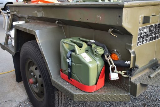

I tried installing full size Jerry cans and while I got them to fit, they were just to closed to the edge and I could see them getting hit on trees and rocks in tight situations, then I tried laying them down and I just didn't like the look, so I ordered two of the 10 liter half sized jerry cans which will still allow me to carry 5 extra gallons with me and move's the cans closer to the trailer body and away from danger I also added some pretty hefty chains for security purposes, Sadly there are to many sticky fingers out there today!

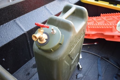

I also tried one of the Scepter Jerry Can Mods, where you attach a hose bib and a Schrader valve to the cap so you can pressurize the can and use it as a shower. I guess it works good but truthfully when the sides of the can bulge outward from the air pressure it makes me a little nervous, I may try the Black 4" ABS pipe shower mod instead. Looks a little more sturdy to me. I would hate to blow out a Plastic Scepter Jerry can and loose 5 gallons of water out in the middle of no where! Both the Jerry can mod and the ABS shower mod can be found on YouTube.

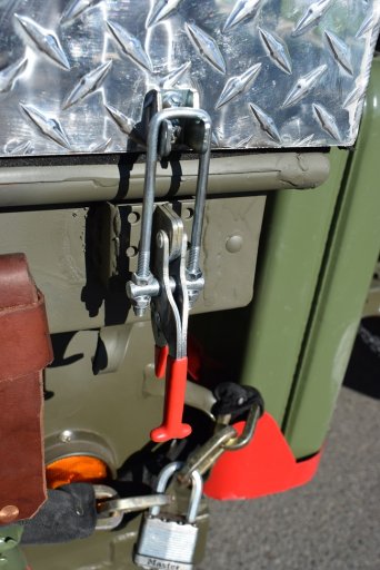

Lots done. I'm tired...lol. Mounted new aluminum top and a handle on the lift side, installed a Jerry can on the front with a small military storage box above it, mounted an axe on the body, a fire extinguisher on the fender and a shoval on the lid. Mounted a lockable hasp for security and made a battery tray on the left rear step. Mounted Escaper Buddy Traction devices on the aluminum top. it's coming along nicely, I bought to heavy of lift struts for the top so I am going to have to get some with less pressure. Lids weighs about 80 lbs and I got two 150lb struts which was way to much.
