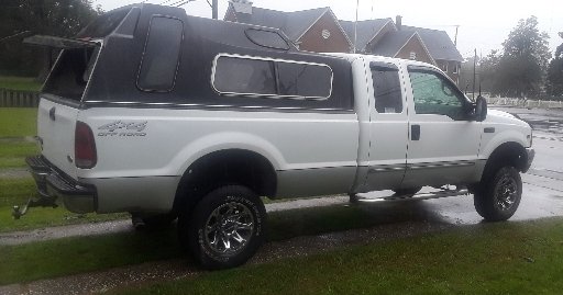

My 2000 Super Duty XLT has 215000 miles on the original 5.4 Triton 2V, is it fast? Nope. Does it make huge torque and horsepower? Nope. But for all the cussing and discussion of the Triton (& I don't trust the 3 valve either) this old first gen with standard type spark plugs has been reliable. Of course I don't rock crawl or climb extreme hills, but it does perform well in many off road conditions.
