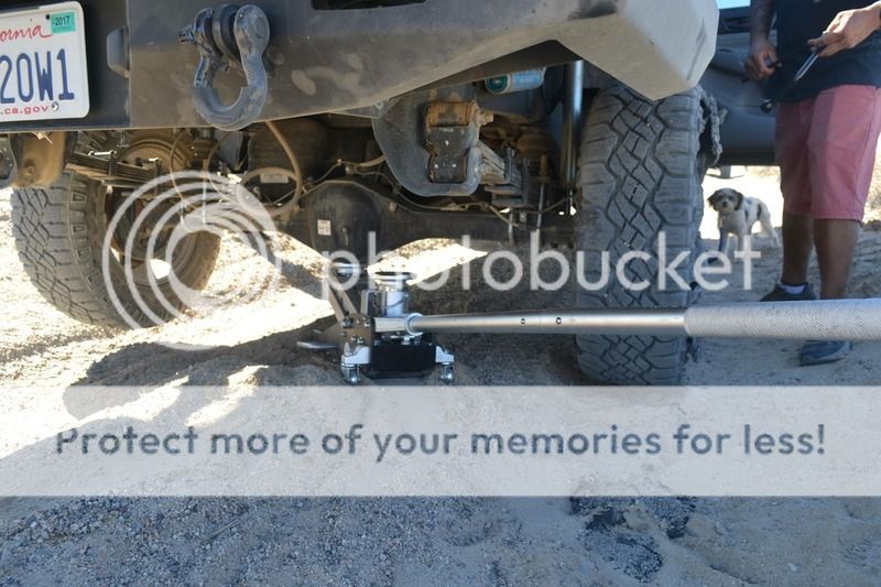

Here is a photo of a tire replacement we did a few weeks ago where the floor jack was awesome. To get the wheel high enough with a Hi-Lift, it would have needed to be near the top of the lift due to the amount of wheel travel he has on the rear.
I was concerned with the height that the Hi-Lift would travel to clear the tire, after that I started strapping the axle to the frame. Now it takes very little to clear the tire.
