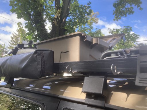

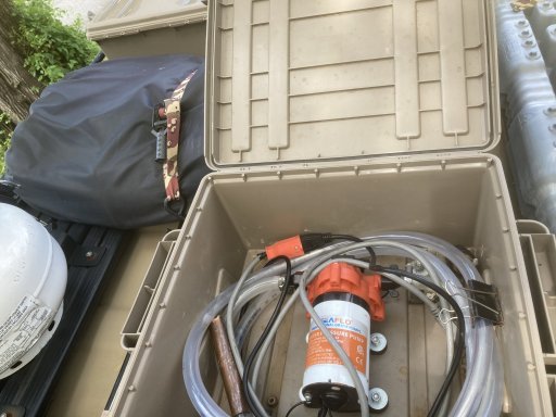

We have a 110v water pump on ours. Pulls up to the pump on the racks then back down to the heater. The pump, all the quick connect water lines and the 110 line are bolted into a box that is bolted to the rack. Open the box, pull hoses out, one to draw, the other quick connected to the heater, which is hung from the racks. plug it in to power inverter, And the gas line to the bottle up on the racks, deploy shower stall, rinse. It does take about 10-15 minutes to set up. If it quits raining tomorrow I’ll post up images. Currently in the Pisgah NF. Rain

the pump is bolted into the box, suck hose slips into the open window where 7 gallon jug is strapped down, quick connect is used to the heater, that hangs from the hooks, plug goes into power inverter.
