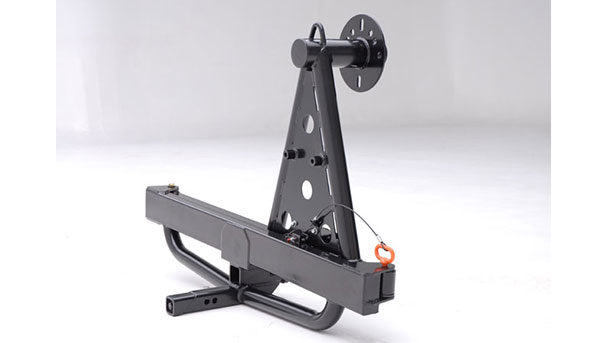

I'm looking at getting a Hitchgate or one like it. http://www.wilcooffroad.com/shop/hitchgate-tire-carrier-toyota/

I'm not sure I would trust it, a tire is pretty heavy and there are multiple potential failure points on that: the hitch itself, the hitch pin, the hinge on the carrier, the arm, and the studs. A 265/75/16 BF Goodrich All Terrain in an E-load rating is not a lightweight bit of kit. Every bump will multiply the weight of the tire and how far it sticks out will multiply that weight again.
Honestly, I think a proper bumper that ties into the chassis would be much safer and last longer. Plus it won't drive you mad on a washboard road with the rattling.

I can't tell for sure but those look like double-shear hinge and pin. I would not hesitate to put a large tire on that at all, looks overbuilt to me actually, plenty strong. I don't have one, nor do I need one but if I was in the market, that would definitely be on the list.
It looks like they sell a double gerry can carrier as well, and that would add another 100 or so lbs. To me it looks like the only issue is the rattle thing on a bumpy road. ...just don't go on any bumpy roads! :tonguewink:

I have wheeled with people running a hitchgate and they work. They work well. You can build one cheaper, but they do as intended without worry.
I saw them hold up to tons of rough road and trail use with 33-35 inch tires as well as extras, like hilifts and shovels.
I built a fold down version before my rear bumper was done and it worked, but was in the way alot compared to one able to swing sideways.
Reactions: SLO Rob

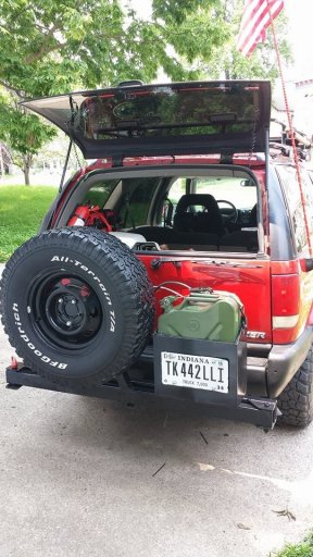

I have been planning on getting one since no one makes a rear bumper for my truck. I know two people with them in the local group, one holds a 35" with a steelie and the other holds a 40". Neither have any trouble with them and they've been on for just over a year as they both bought them at the same time.
It also goes with the modular nature of my build. I'll take it off when I don't need it; like I'll do with my lights and rack.
