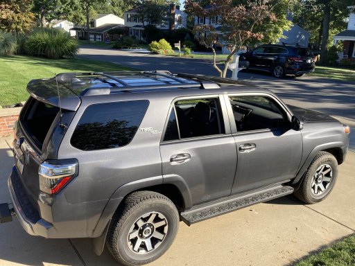

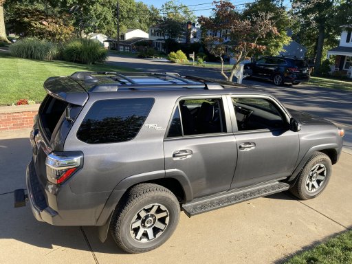

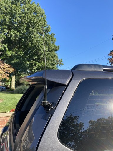

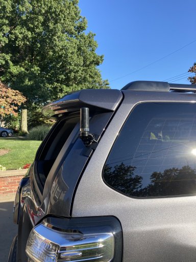

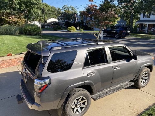

Hi Folks - I did some mobile antenna work today. Installed a new lip mount on the rear of my rig. Have 3 antenna for various scenarios. All are dual band UHF/VHF for ham & GMRS (I'm licensed for both)...
  1. Stealth / Low-profile - everyday around town use, in and out of garage without removal.
  2. Flexible / Med-profile - on the trail use to get through the trees and such.
  3. Tall / High-profile - long-distance comms, or for use with handhelds while the mobile radio is in cross-repeat mode for hiking or other regional use, good for when parking at top of hill and hiking down into valley.
Connected to one of my handheld units for now. Next step is to get the ICOM 2730A mobile installed.
Comments and suggestions welcome.
