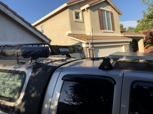

KN6JJS
Just installed this President magnet antenna I had. Was going to use it for my wife’s BMW X1 but changed my mind. I’m sure this one is taller than the one that will come with my Midland MTX105 coming on Thursday. 35AC082F-E179-4702-AF24-D12049835BA9.jpeg
