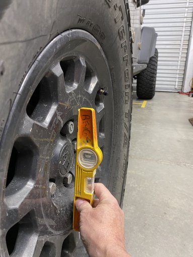

First person to guess whats happening and why its happening gets a Directors Challenge Coin. What is the reason?

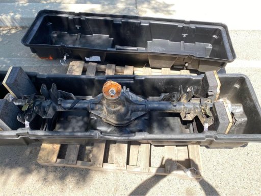

This picture might help figure it out
OB Executive Director
Well looking at that angle I have to assume you bent the old one somehow?
Yep, thats the answer and the fix is to replace it with a beefed up Dana 44. The ideal fix is to put a Dana 60 under there but that requires new rims also plus allot of $$$.

This now leads to the question of how it got that way in the first place. Was it the weight of everything in the bed plus taking bouncy trails at speed? Did you consider the Dynatrac Dana 60 floating axle solution which is engineered for the JT and also retains the Jeep wheel bolt pattern?
Reactions: Kent R
Dynatrac is defiantly what I am saving up for but that will be some time. ;-)
I have access to an older 60, but that is now out of the question due to replacing the rims. So the bandaid fix will need to work for some time.
As for the weight you me well enough to know I wont tell and take your own guess about the speed :sunglasses:

How did you notice it?
Axle seal, alignment or just looking down the side of the vehicle?
How did you bend it and get positive camber?
That's almost a sideways stuff the tire thing.
I've seen a number of bent axles from offroad but this is only the second pos camber one I've seen.
Reactions: Kent R
A member stopped by and was checking the rig out and noticed it just looking at the rear. Who knows how it bent it does get hard use, could have happened during our last trail guardian event in the Mojave National Preserve.
