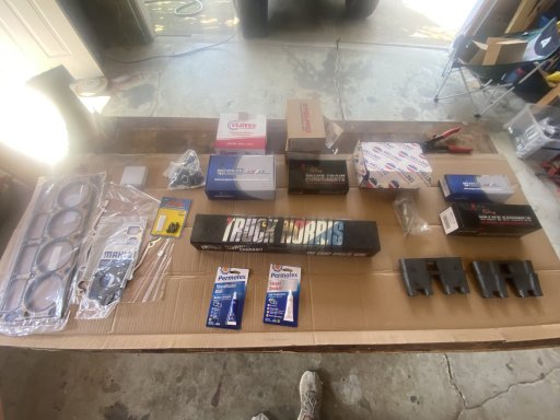

New heads went on, but not without me thinking I should probably do my lifters and rods while here, but didn't. Six months later, a persistent valve-train tic told me I should just do what should have been done in March and take care of the entire valve train - so I whipped out the card and made an order:
Brian Tooely Racing "Truck Norris" cam, new lifters, rockers, springs, rods, gaskets, trays....and "while I'm here" new oil pump, timing set, sensors, etc.
All in all the job went simply enough, though I did wind up with some new tools (harmonic balancer puller, installer, valve spring compressor, bigger breaker bar).
Got her buttoned up, and maaaaannnnnn did she run rough. Turns out, you MUST tune this cam. No way will she idle without.
