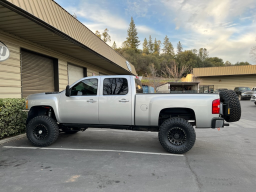

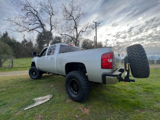

Finally picked it up yesterday... so far so GREAT. The quality of WFO's work is outstanding, as is their customer service. I was mistaken, the ARB actually got tucked up behind the bedside on the passenger side (hidden, and protected by the inner wheel housing) and I have a quick-connect up in that wheel well.

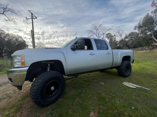

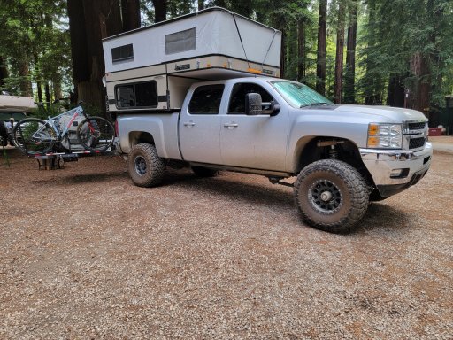

Little update...
So we did some measuring, here's a measurement at the rear fender *BEFORE* any changes:
It's probably 45-5/16" but it wasn't that accurate of a measurement so let's just call it 45.25" to make it easy.
Here's after:
We'll call it 46.5". So the rear only went up 1.25"... but remember I went from 35" tires to 37" tires (same brand/model tire) so I'd say 1" of that was from the tires. In other words, negligible rear lift.
Here's the front:
Let's call that 48.5" so the front is a full 2" higher than the back. Obviously this wasn't ideal. Further, the Deaver "mini pack" we put in only replaces part of the stock leaf pack but we removed the over-loads so they don't get in the way of articulation (since I run air bags they're not really needed) and we had to retain the 1.5" lift block I had in the truck previously. All-in all I'd say the spring pack ended up with about the same height as the stock spring pack, maybe .25" higher and then it has the 1.5" block. So, I ordered up some Deaver full spring packs that area 4" lift. In theory these should sit ~2.25-2.5" taller than it does now, which would bring the tail slightly higher than the front which is ideal (like .25-.5" higher).
Of course, changing the rear about 2" I'm going to have to revisit both the rear driveshaft and the shocks. I think the DS will be fine if I leave the shocks as-is, since the total droop of the rear axle relative to the chassis will be limited by the shocks, and therefore the same. But, I might need to run a longer-yet shock (these are already longer than my previous set) to maximize droop (and ensure I have some down-travel) at which point I'm prob going to have to get a DS made.
I'm a little frustrated I'm having to figure this stuff out now, but it's all part of the game.

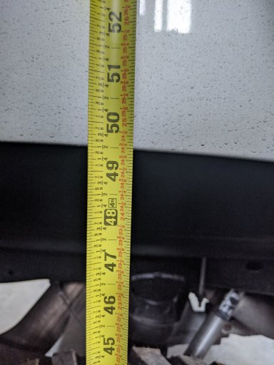

More fun with numbers... finally got the truck onto perfectly flat/level concrete and re-did the measurements.
Front:
Rear:
I'm going to call the front 49" even, and the rear 47-5/8". This is with the Deaver "mini pack" and a 1.5" block in the rear. You might recall I ordered a Deaver 4" lift complete spring pack, which showed "in stock" at the Dmaxstore. Well, it is actually 6-8 weeks backordered. I canceled that, and just ordered up a 3" lift block and new U-bolts to replace my 1.5" block. To be clear, I'm not thrilled about ending up with a block in the equation still. But I want to at least get things settled out and at a height I like before I figure out what springs I need and wait the ~2 months for them.
By my math, the 1.5" additional should bring the rear to 49-1/8", aka 1/8" higher than the front which would be perrrrrrrrrfect IMHO.
Next, we tried to figure out how much down-travel I'll have with the rear going up 1.5", but keeping the same shock (it's the limiting factor for down-travel in the rear, the front has actual limit straps). We also needed to figure out at what point the air bags separate from the cradles. So we started jacking up one rear corner of the chassis, letting the axle droop, and this is about where it was when we got the sliiiiiightest bit of separation between the bag and the cradle:
We'll call it 49-1/2. With the new blocks the rear will sit at 49-1/8, which means it'd only have 3/8" of down-travel before separating from the cups, which isn't ideal IMHO. Obviously the cups are specifically there to allow the bags to separate, but I think it'd create a lot of clicking and clunking with them separating that soon. Luckily there's a nice simple solution, Air Lift makes 2" spacers for these bags. That'll put it at 2-3/8" down-travel before they separate, which should only really happen under extreme articulation (or if I jump it, lol - hopefully that never happens).
Next, I wanted to address the fact that I really have no rear bump-stop limiting up-travel, basically the bags are the only thing, but they were not the internally bump-stopped style. So I ordered a set WITH the internal bump stops to swap in. Now, this is going to be trail and error. With the 2" spacer the bags will be a bit compressed at ride height, which means they'll have less up-travel until they start to get into the bump. This could be a goo thing since it's a progressive bump (pic below) or, it could create a jarring ride and limit articulation too much. At full-full articulation right now the tire will just get into the front edge of the bed side, so I do want to limit up travel, but I want to limit the least amount possible. Basically, I need to get them in, and take it out and flex it and see how early the bumps limit things, and also see if it feels like it's getting into the bumps constantly going down the trail.

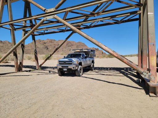

4-day trip around Joshua Tree, down to the East of the Salton Sea, then up to the Lake Isabella area:
Overall things went well, and worked well. MPG is definitely down significantly, more like 14.5-15 MPG freeway at a ~75 MPH cruise (down from 17ish) and 12ish on 2wd sections of trail, 10ish in 4LO. Still, range is a non-issue with the 60 gallon tank. The biggest "problem" I had was side-to-side chucking on a particularly bad part of the Red Canyon Jeep Trail. It seems it was the "perfect storm" of a softer, sandy surface that still had enough dirt/rock to not be soft enough to conform as I drove through, but not be too solid to avoid developing staggered "whoops." I say "whoops" in quotes because generally I encounter whoops as even "lines" across a surface (that left and right tires hit in unison). These were staggered such that you hit left-right-left-right-left-right... which obviously wanted to toss the truck side-to-side. This is one area where the stock IFS setup as superior, as the solid/solid arrangement let the truck lean back and forth. As a SxS owner I hate to say it, but I'm pretty confident it is SxSs that create this type of chatter. Either way, it sucked.

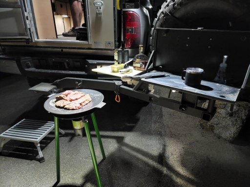

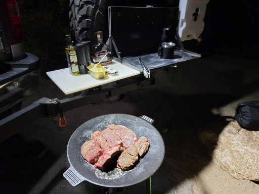

Also did some full on Broverland camp cooking with my Oris Skottle. I added their wind guard, which was a total game changer. Sat night was pretty breezy, and I don't think I would have been able to cook without the guard based on previous experience.
Sat night I made a creamy lemon sauce pasta with chicken, mushrooms and asparagus:
