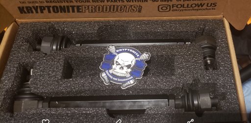

Arrived yesterday will use these Kryptonite Tire Rods as spares for now but once swapped with stock believe these + Beefier ET CV Half Axels will be all I need for some time on the front ...
I'm interested to see how those hold up for you.

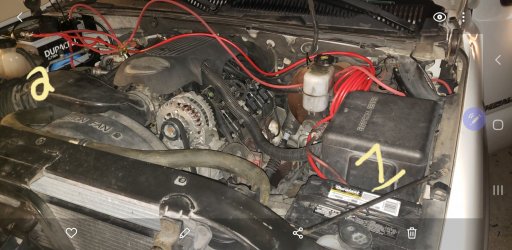

Dual Battery Setup w/Dewalt 1000Watt Inverter completed this week just because i would rather have it and not need it than need it and not have it...
Keyline Iso-Pro 140 Smart Isolator stays on as long as Starter batter is above 13.3V And cuts off when Starter Battery drops below 12.8V eliminates me having to wire to ignition fuse...
Still need to mount Stinger fuse box and the Isolator on the Firewall and zip tie cables left lots of extra cable till i finalize location of everything

Very nice, I just ordered that battery tray for our truck, and I'm starting to work on the dual batt setup for it as well. I'm planning on bringing ours up to TP2 spec, which has been an adventure in getting it spec'd out and figuring out the schematics and whatnot.
Rambling-Rams
1,473
Houston, TX, USA
Henry
Jackson Jr
25192
Is TP2 an efficiency or durability rating?
Was slightly disappointed on the amount of space in my second battery compartment was only able to fit a group 34 battery as i don’t plan on getting rid of the outter bracket bolt down area
After don’t know how many trips to the store mapping out the detailed schematic first is the way to go have $170 worth of 4 gauge wire that i need to find a home for due to lack of detailed planning
