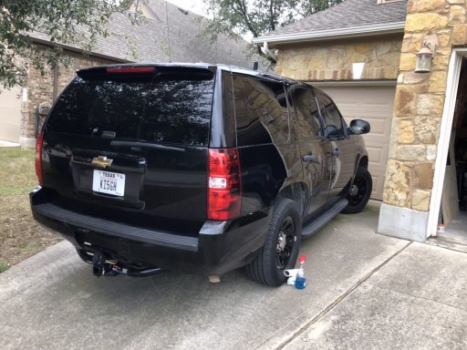

I already had the ham antennas so used them. I do have separate antennas however, I’m not trying to feed two radios into one antenna. I use dual band ham antennas for gmrs, because run what you brung. The swr is not an issue.
I do tend to swap them out depending if I’m at home versus out in the wild, due to garage clearance. The ones on the right side of the roof are the antennas in question.
