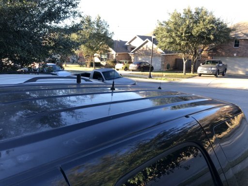

I only have three on thecopcar. Theothertwin has 4.
The stubby is set for uhf in this shot. The Tram is on dual band. I prefer the taller antenna for gain, but the stubby comes in to its own if I’m going into low garages.
