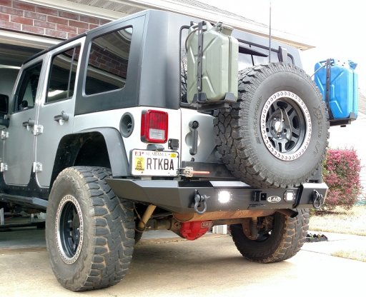

Old thread, but I'm adding my vote for the "GERMAN" style (made in Croatia I think) large mouth metal Jerry cans. The only drawbacks are they are heavier, the spouts can be difficult to find (so it's best to order a couple of them), and the spouts are *not* compatible with the NATO spouts that everyone else seems to run. Another drawback is that they are metal in general, and this might be an issue for folks who want to run antennas close by.
I've run various cans -- Scepter, MFC, Wavian, and the like, and found that the German wide mouth cans are much more durable. They never leak. The large mouth pours much faster with or without the nozzle, and the steel seems to be thicker than the other options. I have run these on the back of my JK for almost 11 years and have had zero issues. They do very slightly expand during the heat, but nothing like my Wavian cans did, and it's probably due to me filling them up to the necks. The best place to find them is Colemans Military Surplus, and the SKU # is 456001. I just checked and they are $59.95, but I have seen them go on sale and/or coupons in the past.
Pics below of the German style versus the NATO style. Note the difference in neck/mouth.

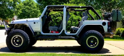

I've been running German NATO cans for over 20 years. I only had to replace the gaskets a couple of times on some of the cans.

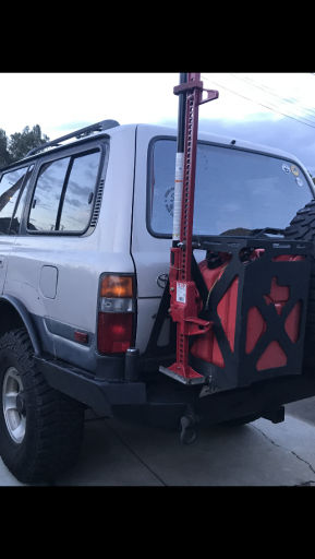

Going to see how these basic gas cans work on the roof rack for a couple of days. Only bought them for bug out situations. They are empty right now. 1B67023F-9E6F-4186-A2E2-92578E54F773.jpeg6B4F5189-DD59-43EC-9959-074C427335FC.jpeg
Going to see how these basic gas cans work on the roof rack for a couple of days. Only bought them for bug out situations. They are empty right now. View attachment 104637View attachment 104638
Fill one with fuel seal it up and set it in the sun away from your rig, and your house. If it handles the fuel’s expansion as the temp rises without leaking vapor or fuel then I might consider trying one on the vehicle for a bit before I tried more. The MFC fuel cans I bought are STOUT plastic and they still balloon a bit after sitting in the sun. It’s not a problem if you know it, expect it, and plan for it.
