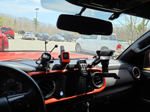

I have a Garmin InReach Mini mounted to a suction mount in the left lower corner of the windshield, it gets GPS reception there.
But I have to say, the device itself is rather underwhelming in the whole GPS reception area – it takes forever to actually acquire, has worse reception than an old iPhone, overall just not a good device. I have an old Spot 3 device, which just works so much better (quicker GPS acquisition, less button pressing to get something going, etc.). If it wasn't for the fact that Spot just sucks as a service, I'd happily switch back to it.

Yeah, I went to the InReach because of the more features (two way comms) and the hopes of better GPS reception. The SPOT3 was actually a bit better at tracking reliably for me, it was definitely much faster in starting the tracking after having been off for a while. SPOT has changed their plans quite a bit so they aren't THAT far apart.
I think if I had to get a device again, I'd get the GPSMap 66 or Montana 700. The InReach Mini is just a bad device in my personal opinion. Usage is a PITA compared to a SPOT3.
But whatever, I use this:
To mount to the windshield (lower right corner) and a short RAM arm plus the RAM cradle for the InReach Mini. The cradle needed some trimming with a sharp knife to make it usable, but overall it's a workable solution.
