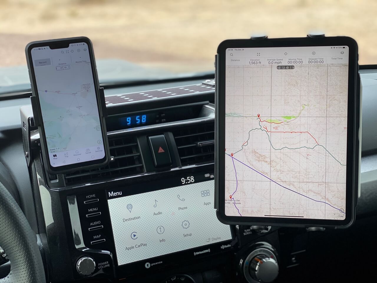

My iPad Pro has Cell. The GPS has been very reliable. (See other nonsense below)
You can always pair the InReach with your iPad and use that for messaging via the iPad vs phone. Then you would not need the extra Bluetooth puck. I know it is expensive to add the "cell" version of the iPad lines in order to get GPS but it is very convenient. One less thing to worry about. My vote is go iPad with Cell. I have had just about every version of the iPad. My latest is the first with the GPS chip. No regrets. You can sit by the campfire and use Gaia, etc without the need to pair to anything.
I use Tackform mounts because I simply believe they work better than the RAM Xgrips. I have owned both.
The Xgrips interfere with both the iPhone and iPad buttons. With the Tackform mount there are no issues with my case or leaving my iPad pencil in the case.
Other Nonsense:
I have a data card in my iPad but that is not required. I use Google FI for a variety of reasons (OFF TOPIC) including that in the US it typically uses T-Mobile whereas my phone is Verizon. Some places I get better coverage with Verizon and others with Google FI (T-mobile) it is nice to have a back up. Anyway, I use the InReach mini with my phone as the interface for messaging. I also use Google FI with my phone. Verizon is eSim and Google FI is a traditional sim card.
