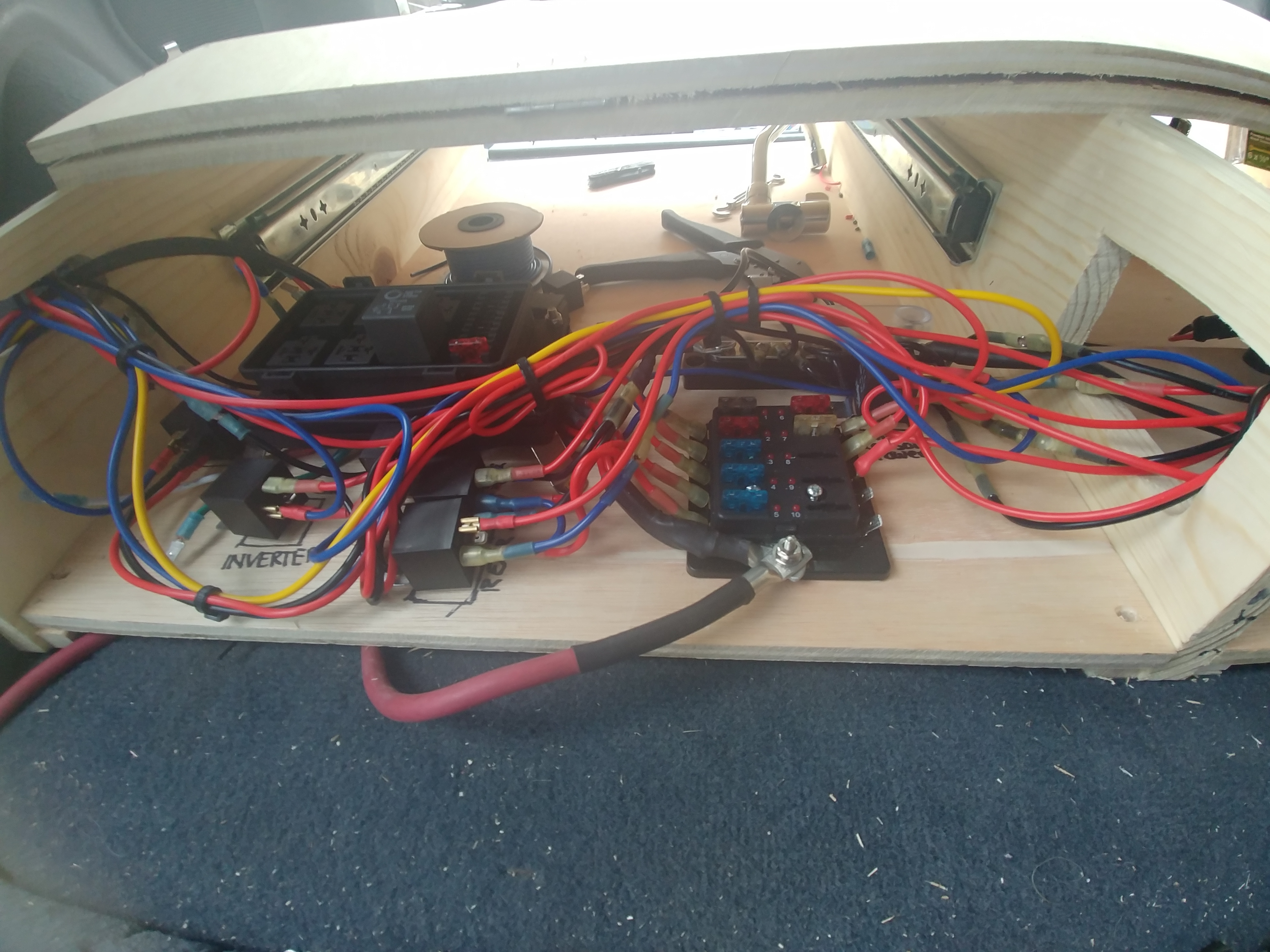

Alright ya'll. Hopefully you are all out camping and or on the trail... Unlike myself. Too many projects to get done this weekend.
Anyways, I am starting in on my biggest project of the day... The Fuse/Relay box that Michael did a video on. I have to say, this took me a minute... Okay okay, an entire day of YouTubeing... to get it BUT I am there.
Wish me luck!
-Dan
Wish me luck!
-Dan

Thank you!!!
I think I am going to look into the wire gland nuts.
Just got done with wiring the box, although, I am missing 1 relay. More on order.

Do you have a Forum thread or video or instructions to build new box? Parts list?
Thank You for your consideration and time.
This is very similar to the box I built originally. Then I rebuilt it using a new box I found on Amazon that shrunk the whole thing way down. New box on the left, old box on the right.

Looks awesome, very nice. Here is one I did for lights and power in the back of my truck
What canopy is that on your Gladiator? Am in the market for one; once I have something I'll build a "secondary" power setup back in the bed and your pretty colored light box intrigues me :)
@Life Line Overlanding - sorry got nothing for you on getting wires into the cab of a non-Jeep.
I installed a Voswitch 8 relay remote power setup last weekend - $300 on Amazon and I am impressed with the build quality. I'll never dissuade someone from DIY'ing it (and learning) but have to point out that you don't need to spend a grand to get a quality pre-built switcher setup.

I just finished building a new storage system, and rerouting all my secondary electrical yesterday.
The only thing I can think of that I want to add later would be a fridge, and I still have two unused spots on my fuse panel open (or maybe it was 3)...
100A panel, and if everything is running, my fuses will allow a max of 92A through the panel right now. I may look for a slightly higher amp panel before I add a fridge though.
