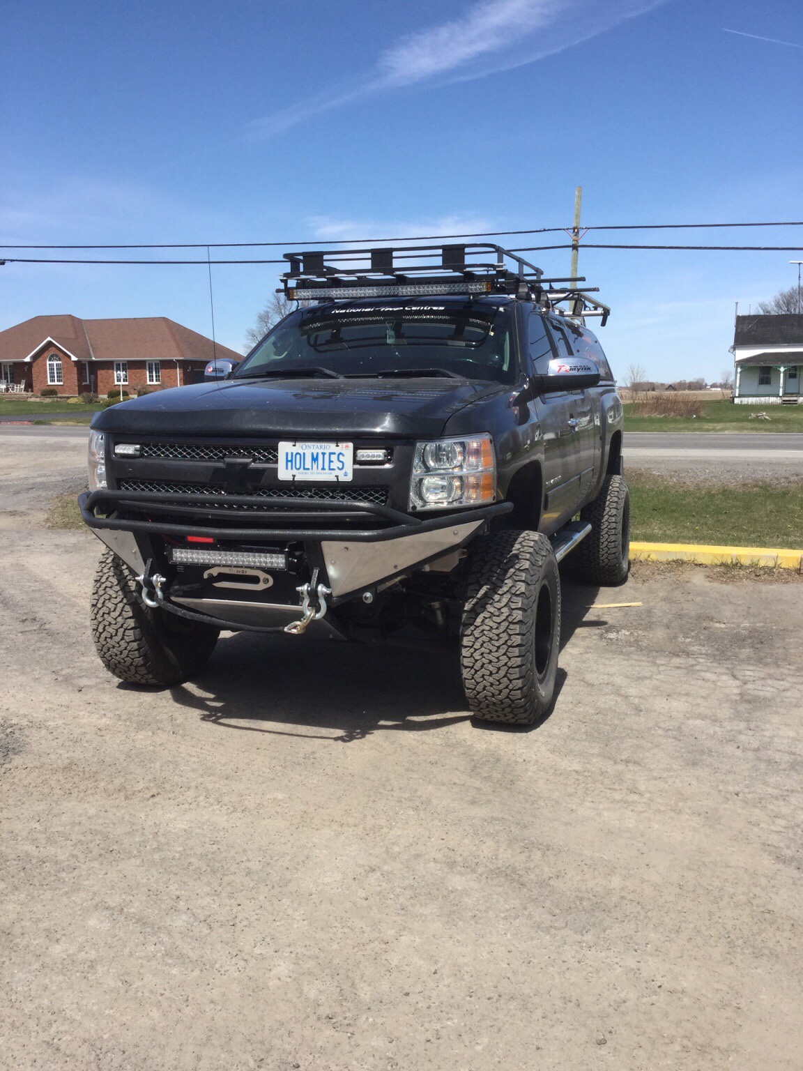

Full sized Over Lander "Silverado"
2011 Chevy Silverado LT Extended Cab
*Rough Country front cross members
*Ready lift tie rods
*Pro Comp pro runner struts
*Custom upper arms
*Built steering rack
*All balls racing joints
*Custom wheel bearings
*Frame is reinforced in front and back.
*Custom Traction bars
*Rough Country kicker bars
*4 Pro Comp pro runner shocks
*7" blocks
*2" add leafs
*3" accessories body lift
*BFgoodrich Km2 AT 37" 8ply
*Fuel Racing 17x10 Mavericks
*Custom skid plate
*Custom bumper
*12k warrior winch
*2" rear wheel spacers
*G2 gears "5.13"
*G2 diff cover
*New axles all around
*HD 6speed transmission
*Gm 5.3L built motor "not explaining what all I've done"
*Magnaflow 10 series race pipe
*K&N intake
*LED Concepts headlights
*Rigid Industries D2 2" x4, SR 10" and E2 20" LEDs
*Unibond 22" led and 50" and 2 7.5" LEDs
*PIAA LED headlights lows
*PIAA halogen headlights high
*Baja over rack
*Thule bars
*3 40w solar panels
*3000w inverter
*Bed rug
*Smittybilt tactical gear bags
*Smith & Wesson knifes
*Bushwacker flares
*Custom mud guards
*75w CB
*JL Audio 6 comp speakers, 2 12" comp subs
*Alpine deck
*JL amps
*Weather tech mats
*Viper security system
*Wheelen strobes to flash with the security
*2 secondary security batteries
*4 deep cycle batteries
*1 main 1100 cca battery
*GPS tracking 24/7 "even runs off of solar"
*Digital battery isolator
Depending on the trip the load out will change.
Turns out 496hp on average and if turned up will snap drive shaft in one pull..
Average fuel economy is 14L/100kms "cylinder shut down helps"
To come :
*LS3 Gm motor or Blue print 427
*Fiberwerx fender flares
*40" Pro Comp tires
If your thinking I'll never get my money back out of this truck, ha your already wrong. I've met some of the greatest people traveling with this old girl. The best it yet to come I imagine.
Sent from my iPad using Overland Bound Talk
Very nice rig. I really like the clean look of the winch bumper on the front. Nicely done.
Man that's beautiful. I know this is an old thread but please put up more pictures! I need the inspiration.
