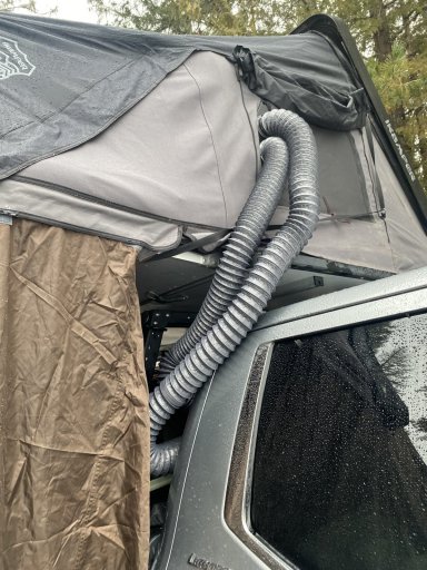

Tent Heater-
the full diy write up Propex Heater Build to iKamper Roof Top Tent
Bought a nice 5lb propane tank mount for my rack off Etsy for my next project because now that my wife and I live up in North Idaho we decided to invest in heat for our RTT set up because it gets cold! I decided on a forced air propane heater due to nearly zero maintaince and I already carry propane. Now we have heat!
[IMG]
Camping Diesel Heater Rotating Dual Tent Vent Assembly - Etsy
This Car Accessories item by CounterCultureShop has 44 favorites from Etsy shoppers. Ships from Garden Grove, CA. Listed on Jan 26, 2024
[IMG]
www.etsy.com
[IMG]
Propex HS2211 6500 BTU Exterior Gas Air Heater
The Propex HS2211 is a weatherproof, externally mounted gas air heater, perfect for keeping your van warm during cold weather while saving space!
[IMG]
vancafe.com

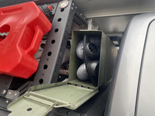

Workflow: pop the tent, open the ammo can, pull out attached hoses and tent window pass through, power up the heater from the master switch, select temp in the tent on the control panel and bam! Heat!

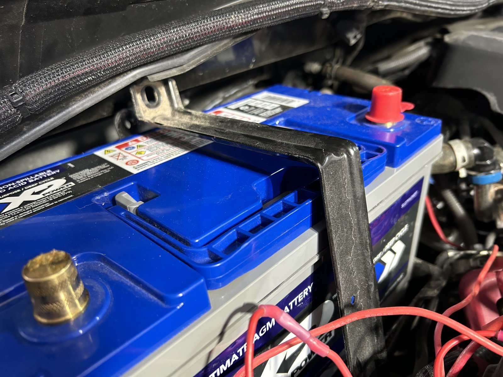

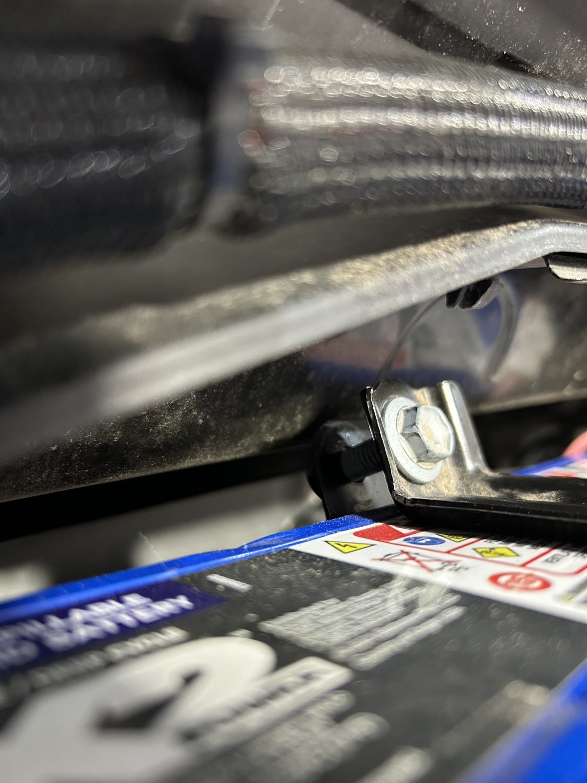

I installed an X2 AGM battery to replace my stock 75AH battery with 92AH. The X2 Group 94R fits nicely as a direct replacement and has 81AH 159 reserve minutes of capacity. I opted for the larger X2 27F which has 92AH and 190 reserve minutes of capacity. The 94R is 7.4” (about stock) in height whereas the 27F is 8.75” so I thought about getting fancy and making a new center bracket. But I didn’t.
There is a bottom bracket which secures the battery into place and the center strap is secondary. I reversed the bracket and bent it to fit. Isn’t too pretty but it fits nice and snug. The battery cables reach just fine and overall pretty easy.
Reversed the bracket then gave it some mallet love
The bolt is cinched tight

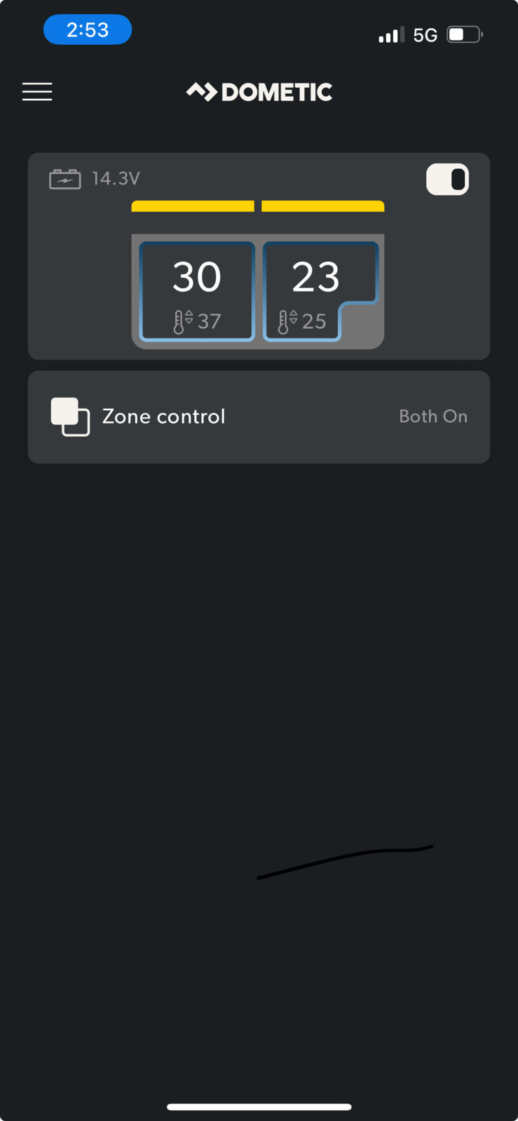

This screenshot is of my fridge when going about 60mph and it’s registering 14.3v which is enough juice to top off an AGM nicely

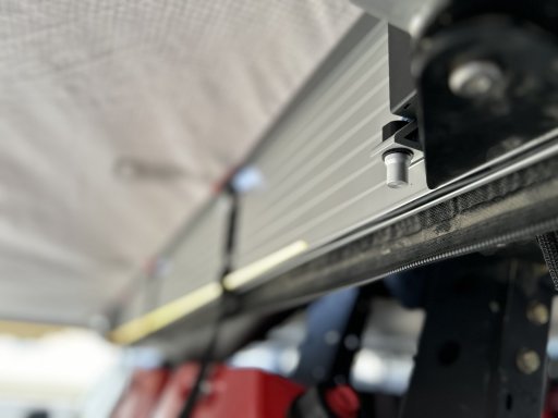

I added solid LED’s to my 270 awning, used a project box for my electrical junction box, and bought a dimmable switch that is fully waterproof. I put the LED’s on every other support bar so it wasn’t too much, it is camping after all……ha

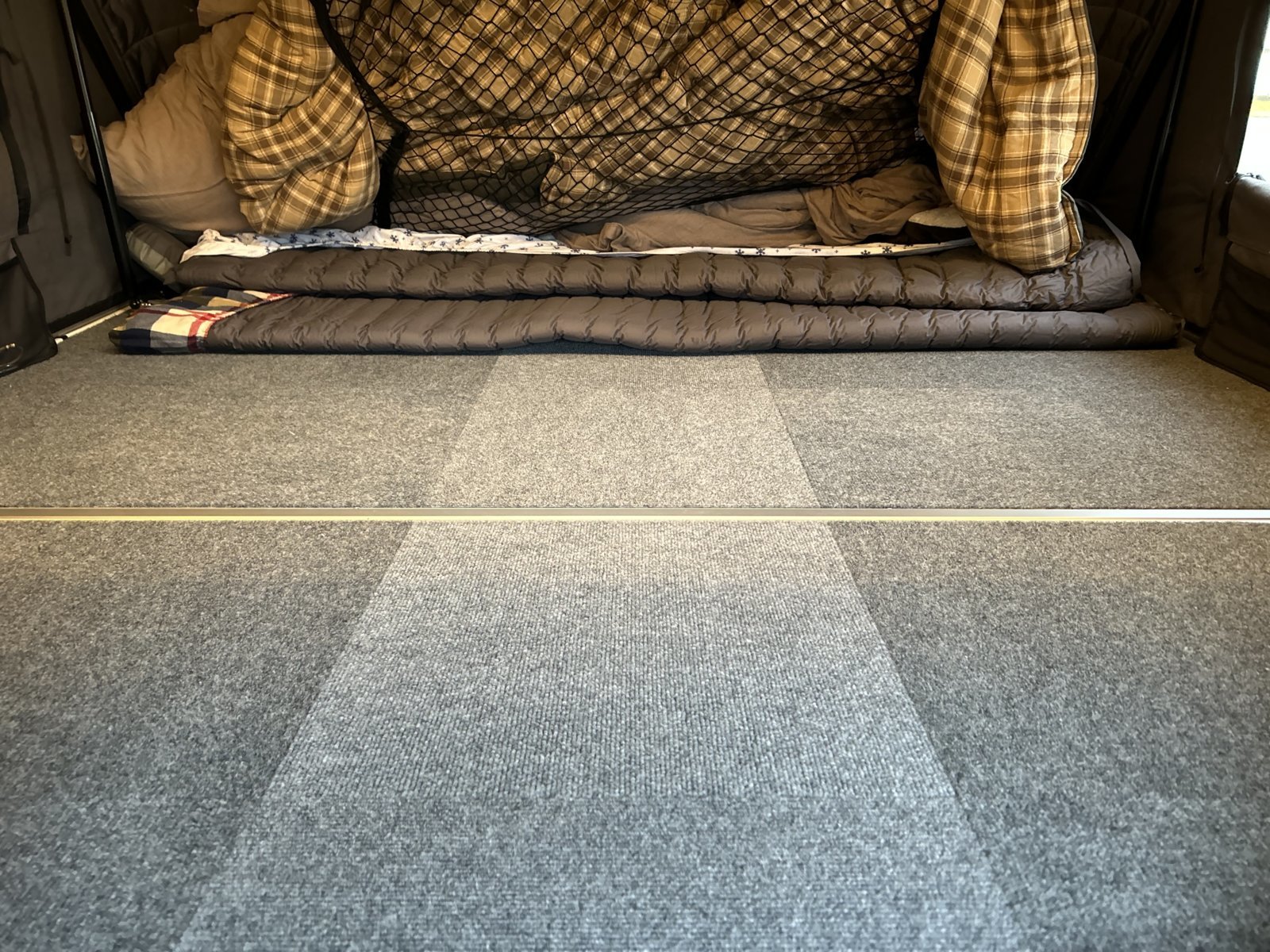

I placed carpet tiles on my iKamper base, helps with the cold and the knees.

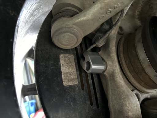

I added SDHQ ABS Guards. Simple mod that can save a lot of headache and repair if you off road. They protect the sensor from a broken branch or something catching the loop and ripping the sensor wire out which would cause a lot of problems trying to drive the truck. They don’t cost too much for the protection

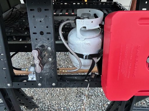

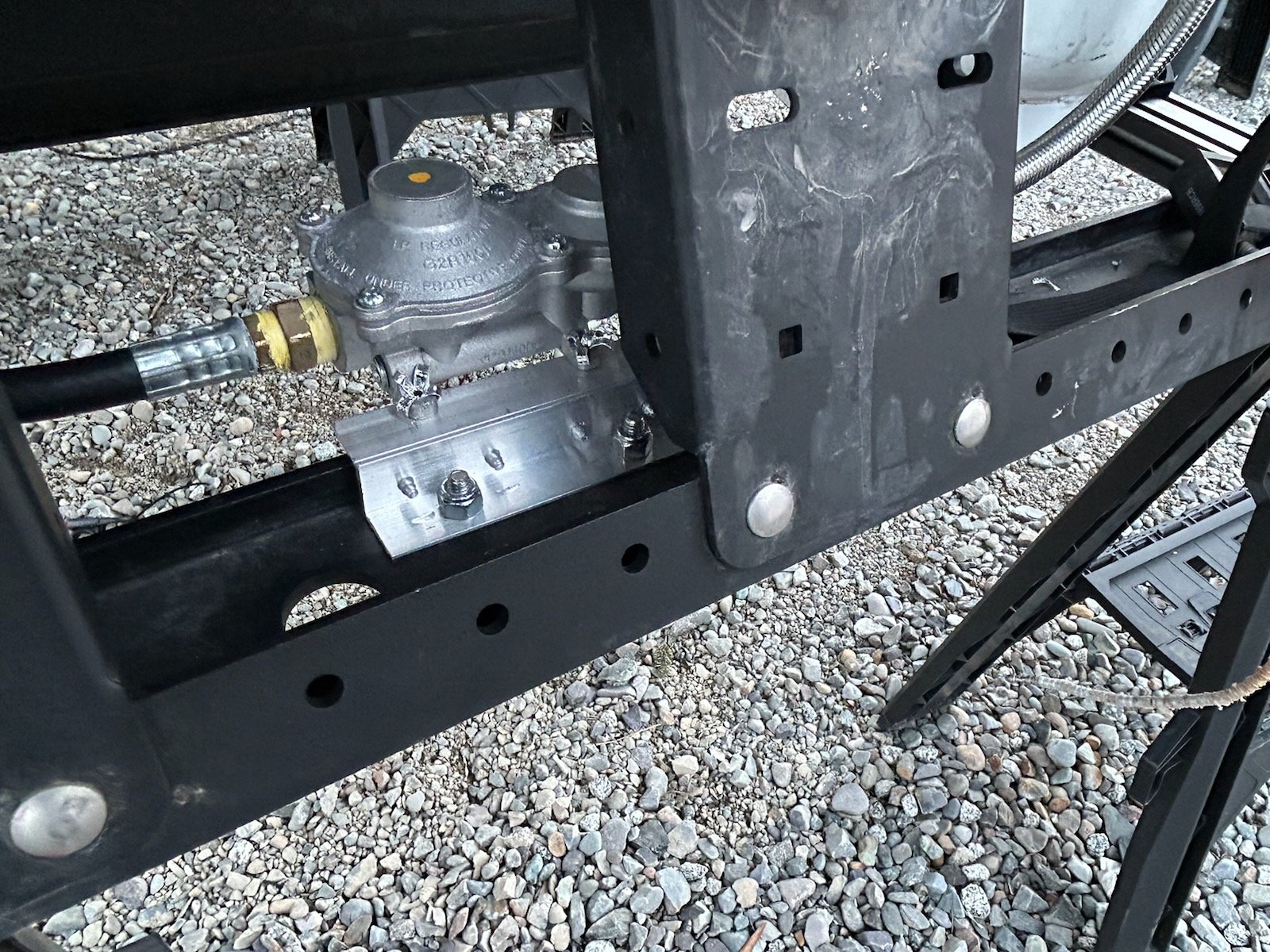

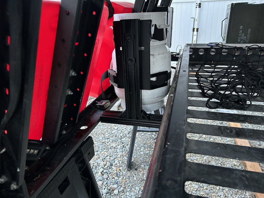

I installed my 5lb propane mount and given the clearance of my KB Voodoo rack I placed it to the side of the slide out cargo tray underneath. It’s plumbed in and I just need to open the valve to run my heater, or remove it for my fire pit if there’s a regional fire ban in the summer.
5lb mount off Etsy
Extrusion mount I threw together
Regulator mount solution with quick connect

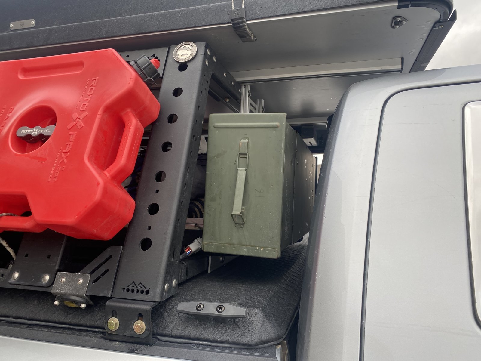

With the Rotopax locked on it‘s a little harder to steal
I made an ammo can fire pit, I added rounded lava rocks later. I made a mistake on the cut so I fashioned a fire emblem to cover it up

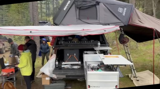

The North Idaho OLB group had a trip to Lake Pend Oreille and it is very satisfying to have all your gear work well and make sense for what you need to do!

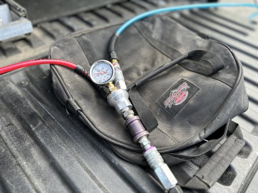

For Memorial Day I got up early to find Horse Haven back country air strip. Easy drive up the mountains but I like to air down for comfort and reduced wear on the truck. I made my own 4-way inflator a couple years ago, it’s a different design using Y connectors and zipper sleeves to keep debris out went you toss out the lines to the tires.
The Y connectors and sleeves make it very easy to roll up and the red line has a quick connect air chuck at the end so I can double the length if needed by connecting the blue line there if needed to reach a long ways.

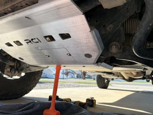

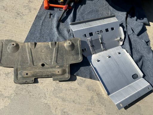

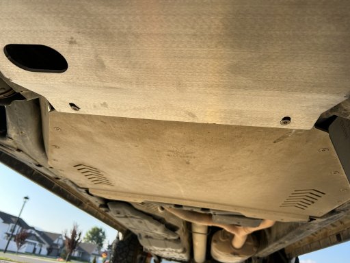

Finally got skid plates on. These are RCI aluminum skids, with 37’s I don’t hit much so it’s just a little extra protection.
I had to trim a little off the front so it lined up with my winch bumper.
