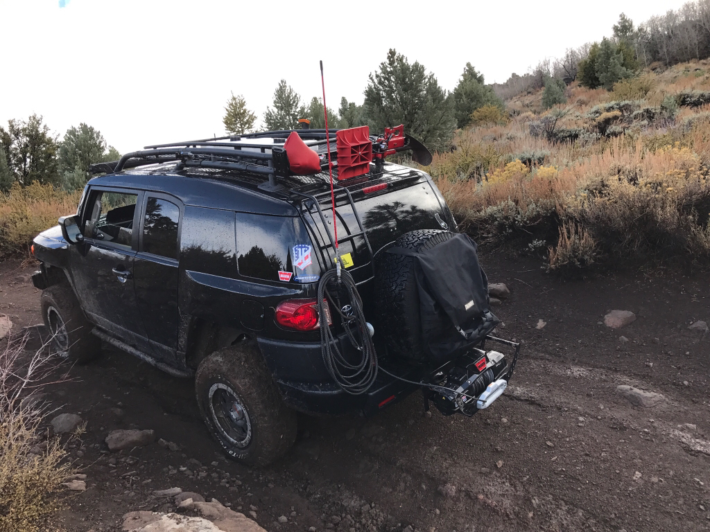

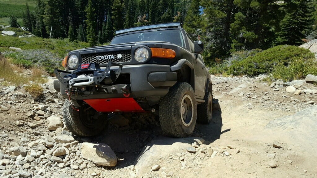

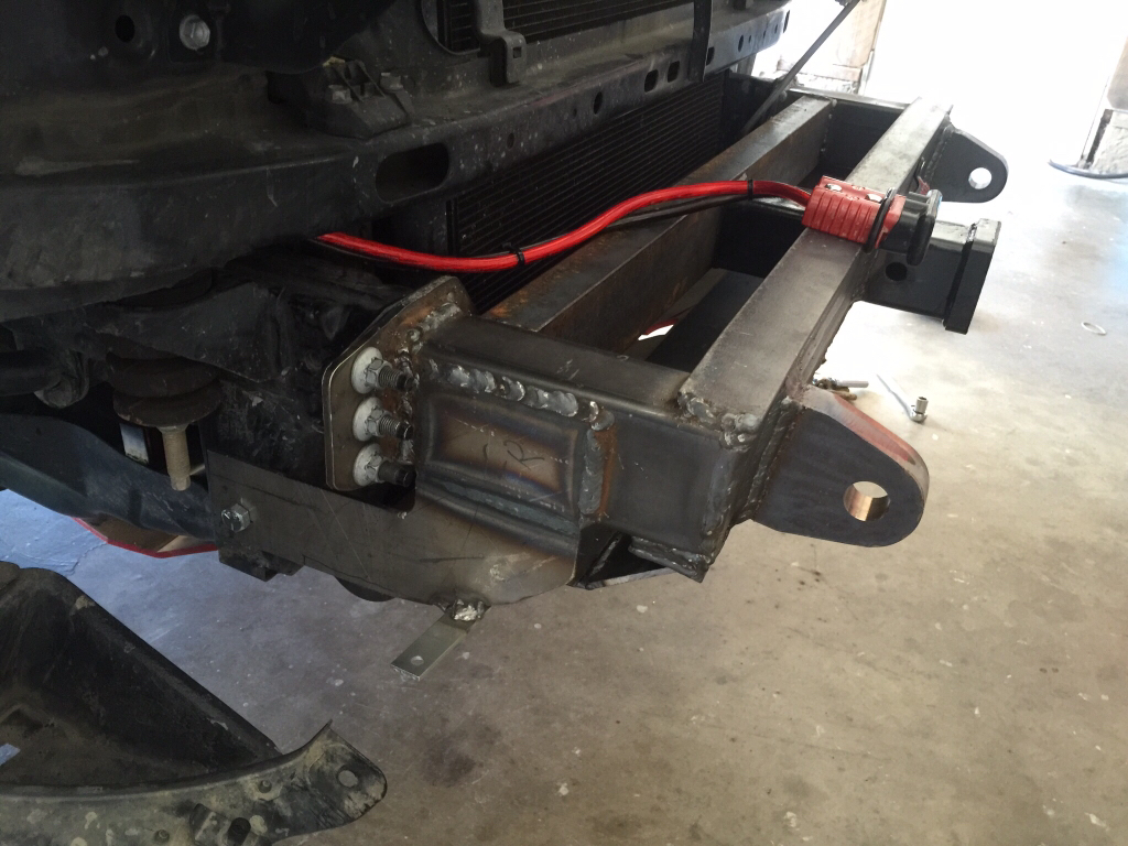

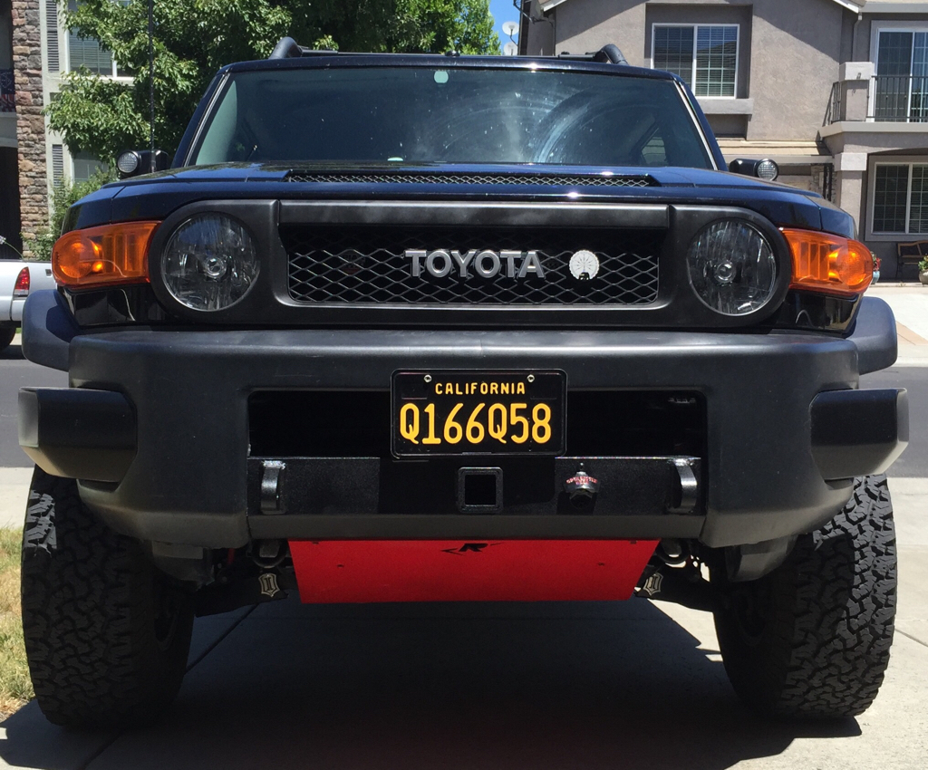

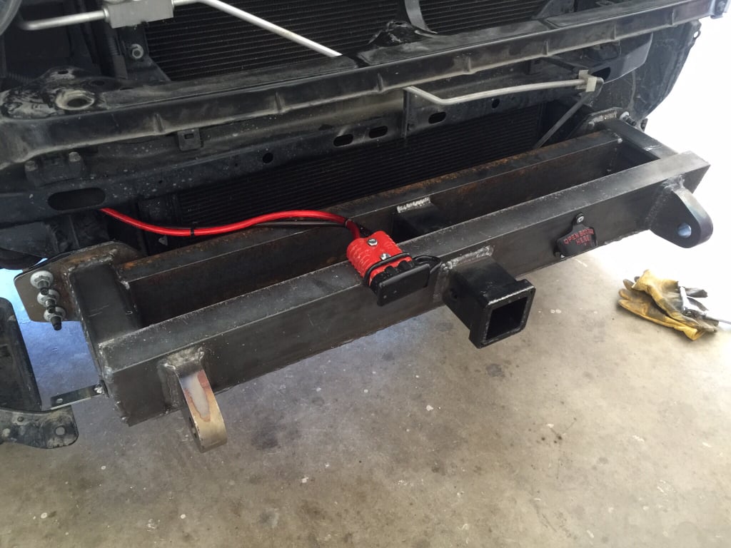

KK6WPP
If you have, or know anyone with, a welder and skills you could make one. A friend and I spent about $150-200 in metal and parts and made one for my FJ Cruiser. I love the ability to move my winch to the back and easily rescue friends who get stuck on the trail behind me!
I do like that bumper, very nice FJ.

Thanks! It was a lot of fun making the bumper. I love a little creative challenge. ;-)

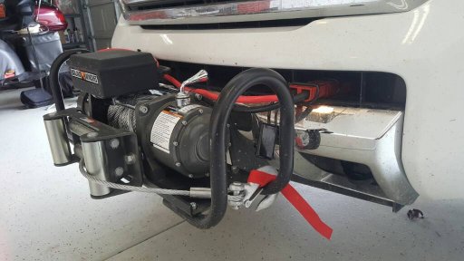

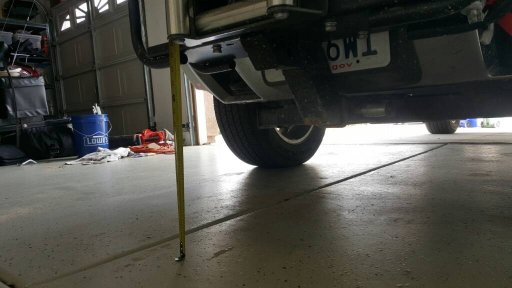

Hi there! Cliff here.
I added a Draw Tite front hitch to my truck to mount my winch. But it was too low, so I modified the winch mount by cutting off the hitch tube and welded it back onto the mount with 3/16 thick plates and raised it up 4 inches. Now the winch is 16 inches off the ground. I will be adding a 5 inch lift and larger tires to the truck as soon as I can afford to; then the winch will be 22 inches off the ground, which should be good.
After I run battery power to the rear of the truck, I will be able to use the winch at the rear.
Attached are some photos.
Good luck with your project.
