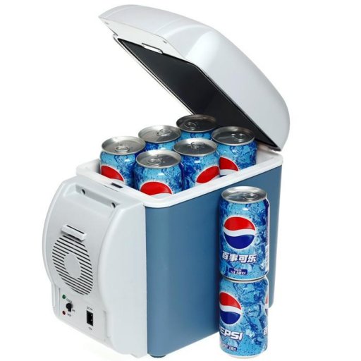

I use a small 12 volt cooler for sandwiches and drinks while I am driving, That way I don't need to pull over to get lunch out of my cooler. It plugs in to my accessory outlet. It is very inefficient so I only run it while my engine is running.
It cools with a peltier unit which is able to drop the temperature about 30 degrees Fahrenheit compared to the ambient temperature. The 12 volt cooler I run is similar to this picture
A 12 volt peltier unit draws a lot of amps and will cause your battery to go flat quickly if your vehicle is not running.
