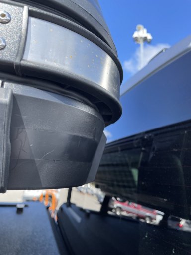

Received my FSR 55" Evolution on Dec 9, 2021, and mounted it to the Front Runner load bars on my DiamondBack HD cover. It road around with me until Feb 12, 2022, when I had the opportunity to take my first overnight camping trip with the rig and RTT.
First issue. Upon arriving at camp and trying to set up the ladder, I noticed that one set of nuts in the aluminum track were installed wrong. I could only connect one ladder hook. The fix is to remove the bottom bolts from one hinge and slide two of the nuts around, but I didn't have all the tools with me to remove and reinstall a hinge (see pic Ladder Nuts Correct and Ladder Nuts Wrong).
Second issue. The next morning, I noticed that the silver metal corners have all started to rust. This is after only 67 days of ownership. FSR made the excuse that I left some protective plastic film over the corners that is trapping moisture. I verified there is no plastic film. This has also been verified by three independent reviews of the tent by different companies. One a national outfitter of outdoor gear, one a FSR Dealer, and one a local franchise of a national body shop chain.
Third issue. This is the most concerning issue as the tent does not seal properly on one corner when closed (see pic Tent Gap 01, Tent Gap 02, Tent Gap 03). If you are not familiar with the Evolution, it is a hardshell tent with top and bottom sections connected by a metal ring in the center that the hinges attach to. Three corners of the tent seal correctly when closed and look great (see pic Tent Rear 01). I also have a walk-around video of the tent starting at the first good corner and working around to the corner with the issue.
Notified FSR of the issues on Feb 14, 2022, and went back and forth over 17 days where FSR went from stating I had minor issues to the issue at the corner is so bad I should have noticed it upon unboxing. Maybe so, but that doesn't take away from the fact that the issue still exists and is a quality control issue. As previously noted, FSR stated the rusting corner issues is due to me leaving a protective film on the corners and trapping moisture. (??) Isn't the idea of a "protective" film to protect? In any event, there was no plastic film. The response with the incorrectly placed ladder nuts was "sorry, but that's an easy fix". Again, maybe so, but not for the price they fetch for a RTT.
The defective corner is obviously the most concerning issue since the corner doesn't seal properly. FSR's first response was that I didn't close the tent properly. I verified by opening and closing the tent again. FSR then stated that this model sometimes gets out of alignment and I just needed to shift it around as close it. Then it went to, unclip the metal latches but don't open the tent. Shift it around on my truck and it will align. FSR then took the position that the corner was so bad that I should have noticed it when I received it. Again, maybe so, but that doesn't take away from the defect and that the tent has zero user damage.
FSR finally notified me on March 3, 2022, that they "are willing to go above and beyond and replace the tent", but ONLY if I cover all shipping costs of the new tent to me and the defective tent back to them. Shipping costs currently quoted at over $900. I fail to see why the customer should pay any shipping costs to replace a defective product. I now have three independent reviews of the RTT. All three companies have confirmed the issues and the corner defect in signed letters. I attempted to resolve the shipping charges with FSR, dealing with Katie (FSR Warranty Mgr.) via a phone call on March 3. Katie refused to discuss her email or the RTT any further when I asked why FSR felt that I should pay shipping when there is no user damage to the RTT. Katie instructed me to dispute the charge on my credit card and she would take it from there and she ended the call.
I have since done as Katie requested. I provided all documents to my CC including the 3 second opinions from independent companies and the charge has been disputed. I'll keep you posted on the outcome, but wanted anyone in the market for a RTT to know about my experience with FSR.

UPDATE: It's been almost a month since I initiated the dispute with my CC and 2.5 weeks since FSR received the documents from my CC company. No response from FSR. I do see that FSR has been running a sale on all their RTT's when other RTT vendors are getting full price. Interesting....

UPDATE: My CC company called on Saturday (04/16/2022). We have a response from FSR and my CC company requested a couple of additional documents before they make a final decision on the dispute. I was also sent the response from FSR. Sad response at best but speaks volumes to the type of business FSR truly is.
FSR’s defense of the issue: “Unfortunately, sometimes customers can cause the tent to become misaligned if they do not deploy the tent correctly, drop it while mounting it, or try to open the cover to the bed of their truck without removing the tent first.” Sad.
“if they do not deploy the tent correctly”??? You unclip the latches around the tent. Push up the back, then push up the front.
“drop it while mounting it” If I had dropped the tent, it would have scuffs and scratches from hitting the pavement or ground and most likely dents. The only damage to the tent as verified by three independent reviews is the defective corner.
“or try to open the cover to the bed of their truck without removing the tent first”. I have a DiamondBack HD cover on my truck. Anyone familiar with the DB HD knows it opens in a front section and a rear section. The tent is mounted on Front Runner load bars. If I had attempted to open the DB with the tent mounted, the tent would be damaged in the middle as I attempted to fold it in half. Ridiculous!
BUYER BEWARE! Here’s the real testament to FSR’s quality as a company. As I noted in one of my posts above, FSR runs multiple sales per year. Many more than other RTT suppliers. I thought it was odd until now. I purchased my Evolution during one of the FSR sales. The reason FSR states they will not offer a full refund, “We do not offer refunds for sale items.” Anyone thinking of purchasing from FSR during a sale or at one of the upcoming Overland Expos, if a discount is offered, should think again. If you sign for the delivery, IT’S YOURS NO MATTER WHAT. “We do not offer refunds for sale items.” The only thing missing from the FSR response is: We do not stand behind our products.

UPDATE: My CC company called on Wednesday (05/18/2022) to inform me the dispute was resolved in my favor. I have a full refund of my purchase price and the Evolution has been turned over to the local dealer. I was under no obligation to turn the RTT over, but I want nothing more to do with FSR. FSR has updated their “Shipping and Returns” policies on the FSR website and no longer list “Exchanges” or “Exceptions”. Curious?? So glad to have this behind me. I’m sure it’s no surprise to anyone reading this post that I would not recommend FSR for any product, EVER! Everyone have a GREAT holiday weekend.
