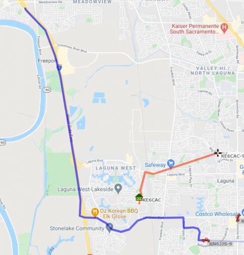

Over the past month I've been trying to track myself on APRS. After fiddling around with the TNC3 settings and APRS iOS app and my Kenwood TM-V71A, I finally found myself in real time. While looking at the map I could see a red trail following my GPS point. I went to the dentist and came back. Got to my computer and now I could see my trip on Google Maps APRS, which I wasn't able to do before, maybe because I was not near a digipeater or what have you. When I went to the last OB it sorta kinda worked but because I was messing with the configuration I did not get a consistent line/beacon like I did today.

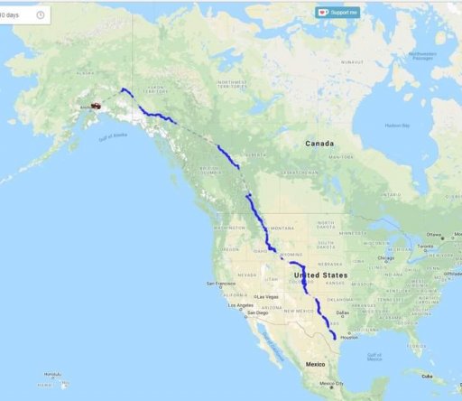

I kinda hope as more younger folks get into HAM that they pick up on APRS. I feel like the network is too incomplete to make good use of it. Don't get me wrong, it still helps once in awhile, finding repeaters and WX stations, but for group location and messaging, its way too spotty. I've done cross country trips before with fairly aggressive APRS beaconing going and it sad how big some of the gaps are.
Here is a particularly large gap between me and Denver that I always have to endure. Basically nothing there anyway I guess, but still. View attachment 190833
That's a long stretch without visibility of your caravan. I agree it does seem spotty. Not sure how to overcome that, e.g. more beaconing, better positioning of comms, etc.

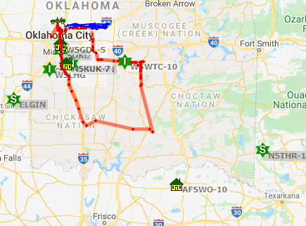

I have experience large areas of little to no coverage here in Oklahoma as well. And you can see that the only reason I have beacons noted in the SE of my route because I hit digipeaters at about 100 miles away.
Found a guy making a trip to AK running APRS, mainly tried to to message him a few times to see if we could and then looked at his track after he had made it to see what areas were bare of igates.

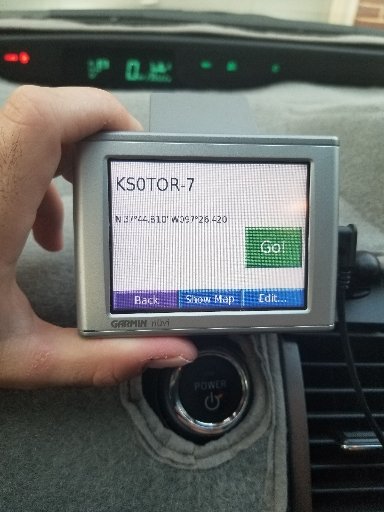

Recently began playing with APRS-IS on my Surface and tied to my FTM-400. If you haven't checked that software out, may give it a shot as you may find it useful. With a relatively simple interface cable it'll decode APRS packets received by the FTM locally. As mentioned here, that would allow for tracking outside of typical iGate coverage. Now.. the cool part is I've experimented with a 'portable' iGate using the APRS-IS software. So, if a local packet is received by my truck it's displayed 'offline' if you will, on my map. "If" I have my WAN connection with my phone tethered the APRS-IS will beacon that packet to the APRS network. Unfortunately Yaesu in their infinite wisdom did not allow for full TNC control via the interface port, so I can't configure this as a digipeater, just a receive iGate.
Could be a solution to track group progress just between you all outside of typical iGate/digipeater RF coverage locally on a laptop or windows tablet.
Can't take credit for the idea, but check this video out. Applicable to other radios I'm sure.
Also toying with an old Garmin that has fleet integration. Using an external TNC it'll display received APRS packets on the Garmin with zero WAN connectivity.
