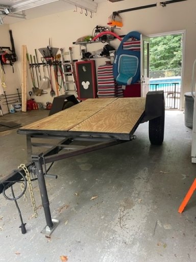

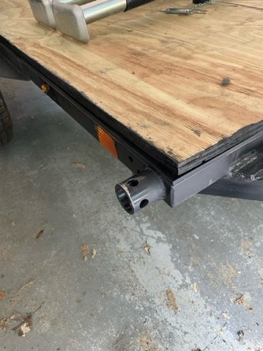

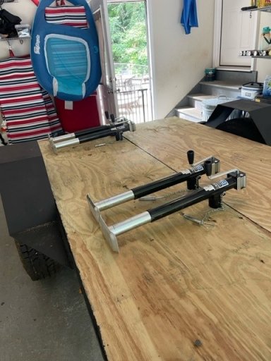

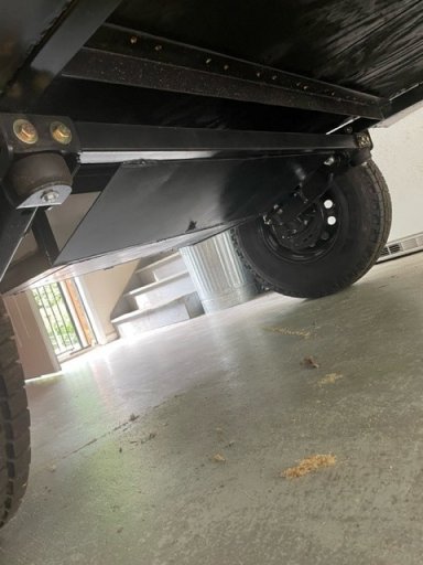

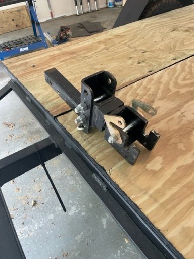

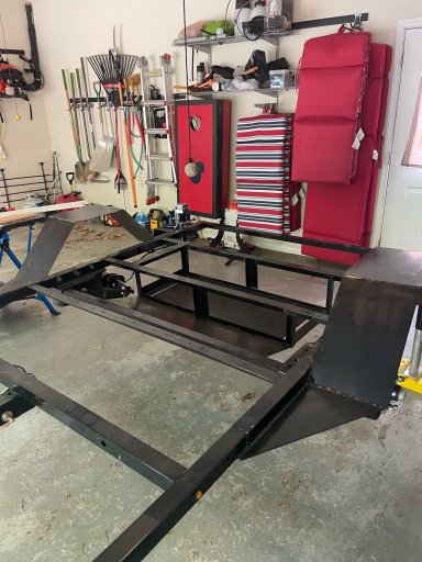

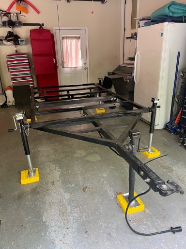

Beefed up and lifted 5x8 trailer frame with "all terrain" tires. The frame is 2" square tube....NOT....angle. I have welded on some additional angle to provide additional support, and some more length to the tongue. Also added the wheel wells, which can be stood on. Suspension is 1 Tonne HD Timbren with 4" lift. Dexter hubs with electric brakes. Tires are 235/85/R16. All 4 corners have jacks for stabilizing. The hitch is a LocknRoll, and will come with both the trailer and truck side. I have added a 21 gallon water tank; but it is not completely secured down yet, so could be removed. All lights have been upgraded to LED, and all new wire has been installed. Much, much more! Currently, the plywood is not secured to the frame. This is not the final plywood I was going to use to build upon, but was going to use for transporting lumber.
