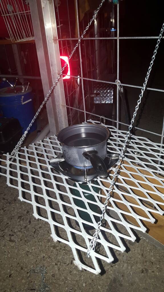

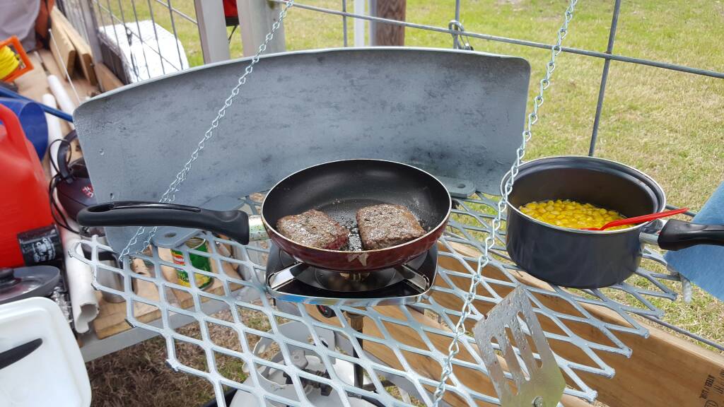

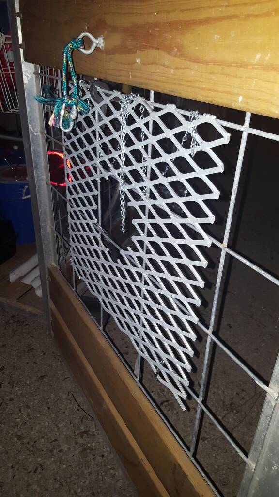

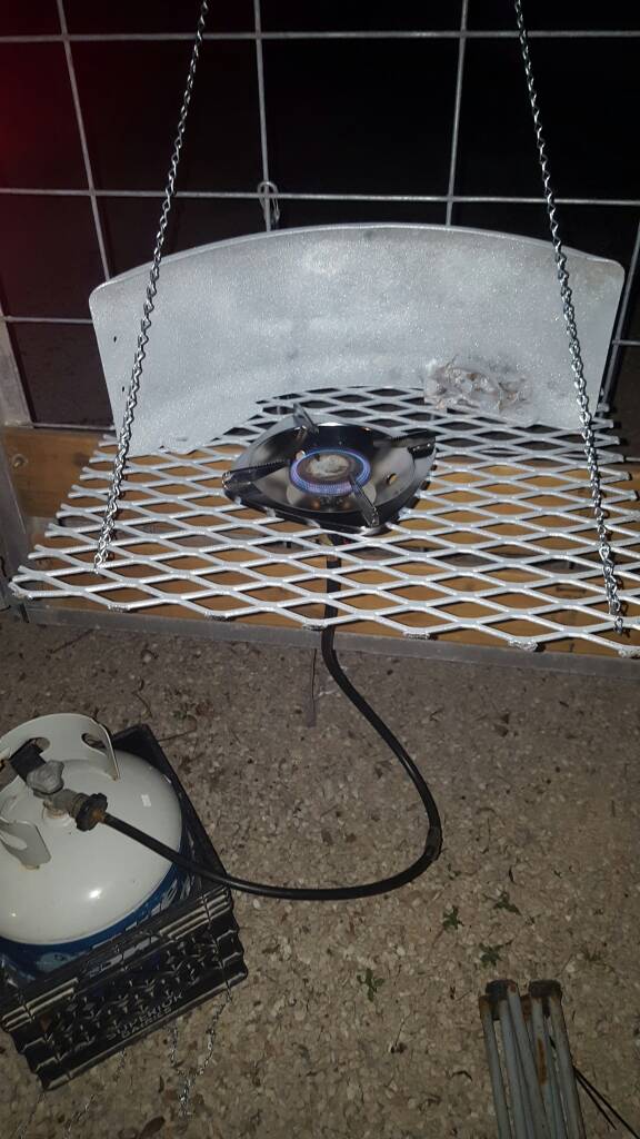

Anyone that had cooked on the cheap bottle top burners has probably watched in horror as the meal starts to lean...but it is hard to argue against the nice, uniform flame they put out.
So here was today's after work project.
Started with a square of heavy expanded metal that I cleaned up and sprayed a layer of cold galvanize (not impressed so far). Got my trusty bolt cutter and made an opening that was wide enough for the burner to drop into but be supported. Another layer of cold galv.
Then two stainless steel quick links and a few feet of chain, and it was done.
Oh, and then I got the big tank and adapter hose.

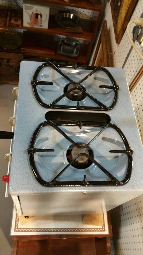

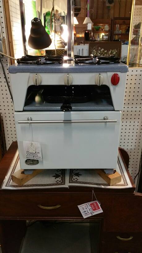

So the lowest price they would go was $300, so I had to pass on it but came across this randomly at Bass Pro Shops.
In the description it says it will run for 7 hours at 350° off a 1lb propane cylinder.

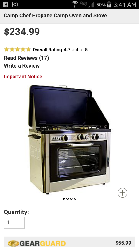

Does anyone have any input on the Camp Chef stove/oven combo?
OB 1643
that sounds more efficient more most propane heaters!
