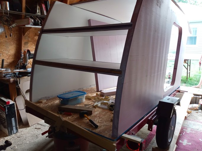

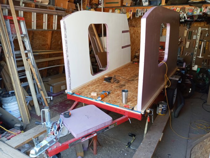

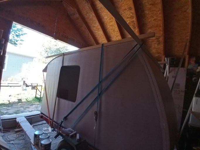

I am one of the pioneers of foamie construction which started in the early 2010 with just a handful of us. Below is my first build that I started in 2013 It came in at 510lbs.

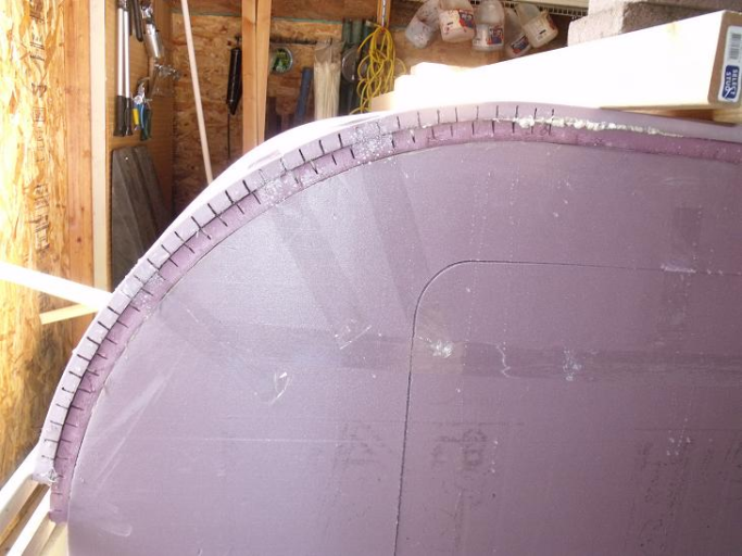

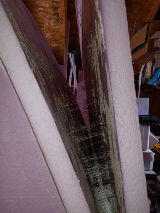

Both of these trailers are built out of 2" XPS foam and have very little wood above the floor.

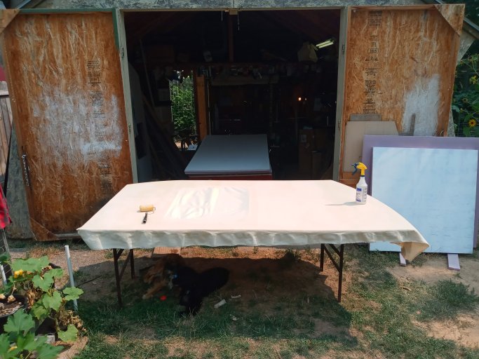

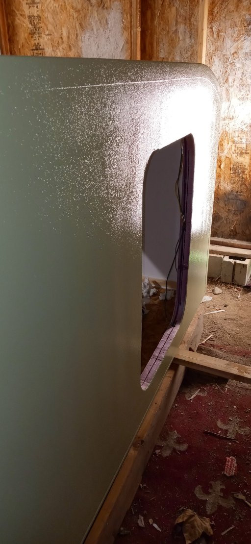

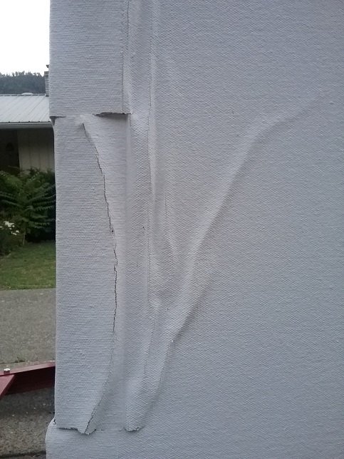

The foam is wrapped with canvas and is coated with what is poorly called Poor Mans Fiberglass (PMF).
PMF is basically canvas coated with Tight Bond II wood glue and then painted with latex paint. Makes for a super strong sock to keep the foam protected and together.

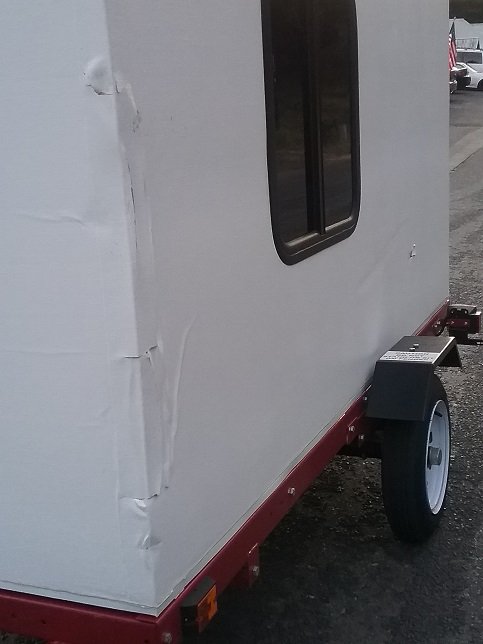

This is a picture of the foamie shortly after it's first trip out. The original 12" tires were dogs off road and this was the first off road upgrade that the Harbor Freight #1195 trailer got, 13" wheels and tires.
It's original weight was 372lbs, but I have since moved up to a 15" trailer wheel and tire. I added a 2" tube spine front to rear, #3500 axle with soft ride shackled leaf springs, rear door for extra storage access and tongue rack for spare tire and extra fuel storage. Dry weight now is about 480lbs, loaded for a trip with fuel and 8 gallons of water is about 950lbs..
