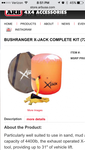

I have a bushranger X-Jack that I carry as well. Really comes in handy in the sand. Little pricey but it's a quick recovery.
http://store.arbusa.com/Bushranger-X-Jack-Complete-Kit-72X10-P3589.aspx
I second the Xjack I just recently ordered mine but can't wait to try it out and hopefully never needed on the trail.
