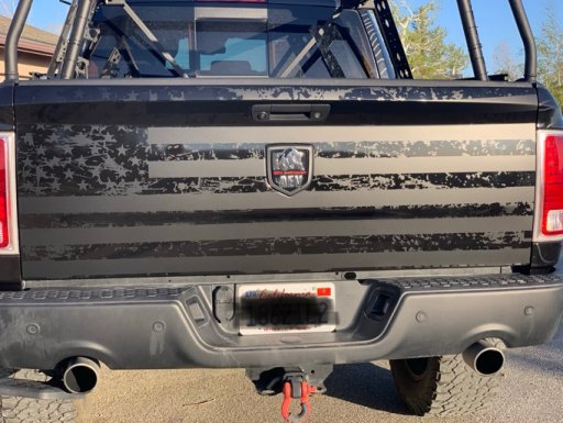

Yep, I'm wrapping if I stick with this hobby. Would be nice to wrap the camper to match.
