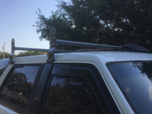

Had very similar rack on a work van. Fix will depend on the type of noise.
1) wind whooshing pitch increases with speed try:
- adding a low angle wind fairing
- rope or bungie around cross bars. Vary number of wraps see what works best
- lower cross bars closer to roof if possible
2) hollow warbling sound like blowing over a beer\soda bottle... tape over any holes. Like the ones on the towers.
3) vibration
- tighten everything re check after 50 then 150 miles
- lower bars closer to roof if possible
- add weight to dampen
