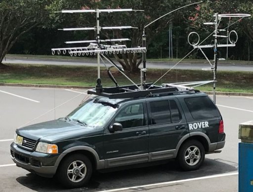

Sure you can trick out your vehicle with multiple Amateur Radio sets but how practical is that in the overlanding world where equipment is subjected to harsh climates and conditions over multiple international borders.

Antenna Overload
There is no right answer, like anything else it requires tailoring to your needs in the same way you tailored your choice of vehicle to the type of travel you expected and wanted to do and the places you wanted to visit.
