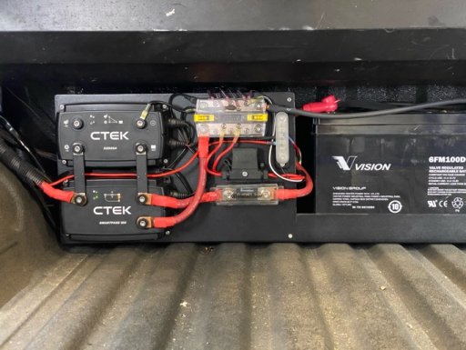

A couple of months ago, ran into a problem with my second battery setup was not charging properly. Got the CTEK Smartpass120 and D250SA checked for proper operation and then tore all my wiring out of the truck.
All brackets were powder coated, then installed back using foam tape to protect metal-on-metal contact.
Ran al new wires, added quick connectors and reorganized some stuff.
In the end, super happy with how this turned out!

Looks awesome, and you have room for another battery if you really needed some deep reserves.
Absolutely! I think that's a big advantage of the current setup. I can get a larger (longer) battery, or a second one in there. Thanks!!

Great job ... added the same items and the solar panel to my H2 very happy with it.
