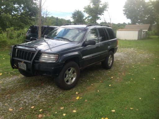

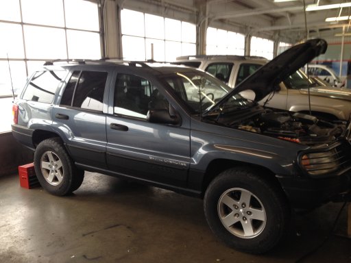

After selling both a YJ Wrangler and an XJ Cherokee, I stumbled across a deal that will probably never happen again. A 2001 Grand Cherokee Laredo with leather (in terrible shape), sunroof, V-8 and Quadra Drive. It had a blown brake rotor (someone used knock off slotted and cross-drilled), a budget boost lift, decent tires (32" on JK wheels) and a brush guard. For a whopping $100. He wanted more, I waited him out and gave $100.
A few hours later I had a full front brake job complete, as well as the build sheet from Jeep. I proceeded to put 4,000 miles on it, some in creek beds, others while towing a trailer as I moved from one town to another. All in all it was money well spent. Until it wasn't.
In September of last year I was going to dump it, since I was in it cheap and had 6 other cars, and when the buyer came to the dealership I worked at to drive it, the starter made noises like it was full of gravel. (Potentially a true diagnosis, how else do you treat a 4x4 you have under $400 invested in?) Needless to say, it didn't sell and sat in the back of the dealership for the next few months, until I took a manager job at a dealership in Bowling Green. I towed it down here from Cincinnati, and in the evenings slowly began the long journey of getting it drivable again. I decided to commit to it, even though I really wanted a Range Rover Classic for an Overlanding rig. My justification was cheaper parts, more reliability, and it checked all the right boxes.

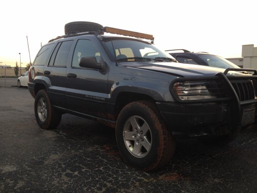

So, the plan was hatched to make this a capable wheeler that I can hop in and drive to trails and campsites through out the country. Every engine sensor, trans sensor and ECU was replaced, along with an injector, a coil pack and spark plugs were all replaced. Since the old exhaust was junk, we welded on a Cherry Bomb since it has no sharp edges that a rock can grab onto. The redneck engine noise is a lovely byproduct.

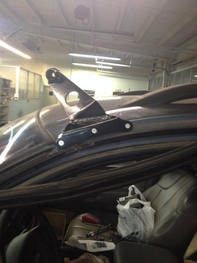

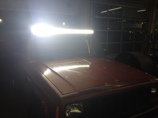

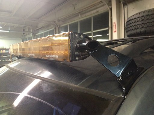

Once it was up and running (2 weeks ago), I began the fun stuff. I started with a Kevin's Off-Road spare tire carrier on the roof (HK Kratos was preferred, but the wife is 5'3" and 130 lbs.) which incorporates Hi-Lift jack mounts as well as a shovel. Sean at Bad Apple Fabrication made the mounts for my 40" Rigid light bar, a JBA CB antenna mount was added, as were a bunch of light cubes from Amazon.

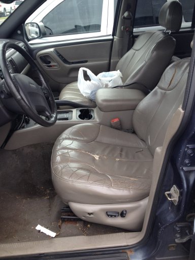

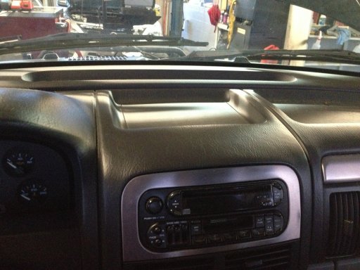

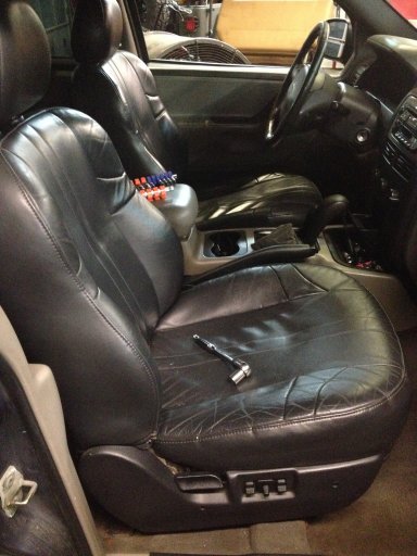

One of our stores took a 2002 GC in on trade with a much nicer interior, and a crap engine, so I did the interior swap for aesthetics and comfort.

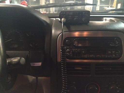

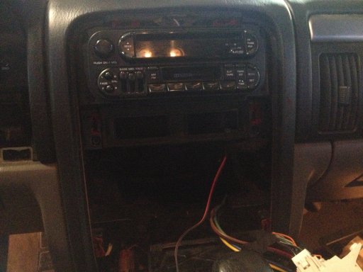

Thanks, Laud! Yes, I'm ready to deal with death wobble, surprisingly it has only done it once, and it was with a trailer behind it, so you can imagine the pucker factor. I'll finish wiring the rear lights and bumper lights tonight, and help a dude with his XJ light bar. I'm hoping to get to mount my CB permanently, as well as the GPS tonight. Apparently I need to chase down the electrical drain.

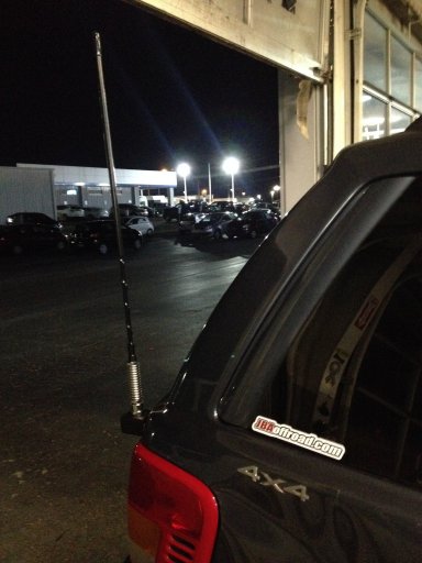

Down the driver side and out the DS tail light area. Have to build an antenna mount and trim the light housing a little.
I have the JBA antenna mount already on, just debating do I run it up the center and drill a hole in the top of the dash, or route it up the passenger side and use the cable as the seal for the tweeter cover?

Really like your WJ! Those new seats really spruced up the interior a lot. Do you know what lift was on it? I'm trying to decide what lift I want to do. I'm trying to decide if I really need a 4" very complete kit or just a more budget minded kit.
