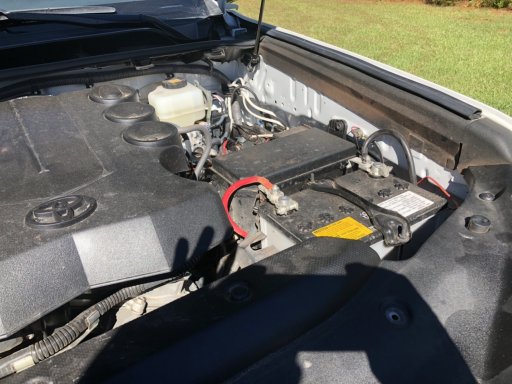

I am installing a power tray, Switch-Pros and dual battery in my 5th Gen 4Runner. Does anyone have any suggestions on an pure sine wave inverter? The market is filled with them but I prefer to get some advice before purchasing one.

Ok cool. so you just move the stuff that's there over. then what drop in a battery tray then strap it in. Nice I like that. Hey thanks I appreciate it.
Dwrld
646
Saint Augustine, St. Johns County, Florida, United States
Dennis
Gibson
7571
Almost that easy if you want to charge the battery with the engine an ACR (automatic charging relay) is needed. Make sure it can handle your alternator output. Adding this ensures your main battery doesn’t drain and leave you stranded without enough power to start your vehicle. They aren’t expensive.
