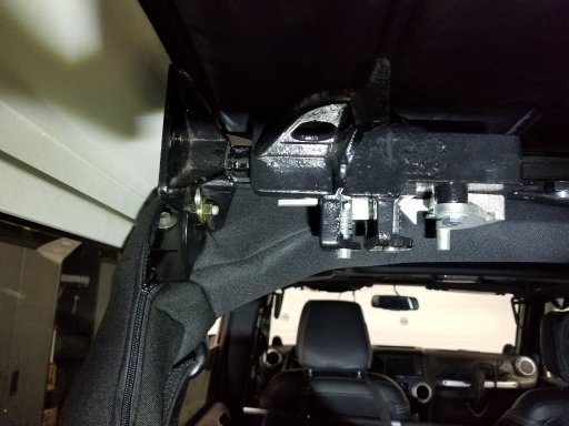

I wanted to add a 48" Hi Lift to the Jeep inventory and opted for an internal rollbar mount from Dominion Offroad.
Here is the mount: http://www.dominionoffroad.com/jeep_jk_hi-lift_mount/index.html
The mount is rock solid with pins that slide into the rollbar and a securing hole that uses an existing factory bolt so the install was easy. Since I do not have a "Hi-Lift" (rather just a generic farm jack) and since the screws on the mount are fixed and non-adjustable, I had to drill additional holes into my jack base for the install. Still . . .no problem . . . Moreover, if you still wish to zip up the cover, you'll have to cut a slit in your rollbar cover to allow the mount to pass through.
And a photo of the right side with wingnut closure:

Overall the entire set up has performed flawlessly with zero issues and zero slop/rattle with the main point being that the DOR base mount made the whole thing possible.
