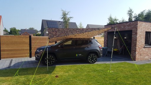

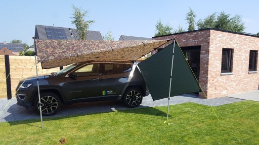

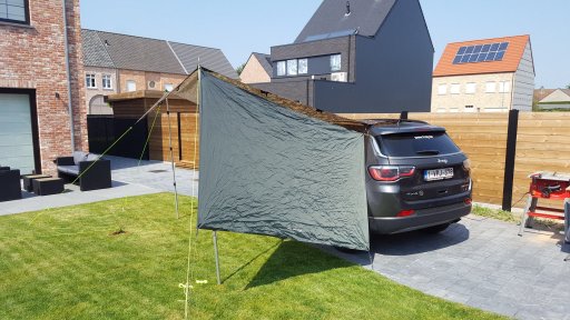

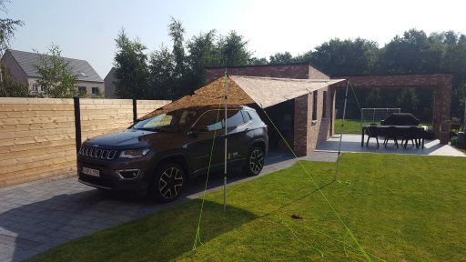

Hey,
I recently DIY'd something like thqt myself, use my 3x3 DD hammocks clight weight camping tarp and a DD hammock magic carpet.
tied it over the car to the wheels and used 2 telescopic camping poles (got these at the outdoor shop)..
Works really good and is pretty quick to setup once you get the hang of it. + really lightweight and compact since the tarp fits perfect in an 8 liter drybag and you can compress it really small.
Setups are endless, just use your creativity, no trees needed but if there are it only makes much more possible! Some paracord with some knot skills and you are set ;)
Enjoy :) IMG-20190826-WA0005.jpegIMG-20190826-WA0019.jpegIMG-20190826-WA0018.jpegIMG-20190826-WA0006.jpeg

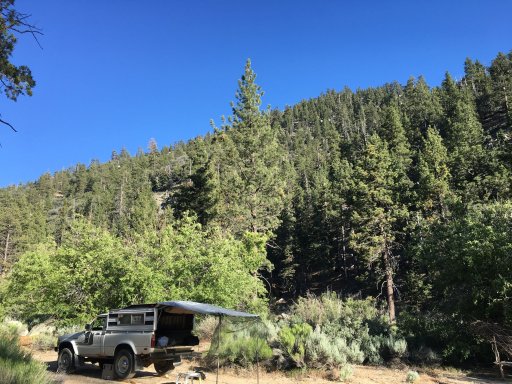

Here’s my setup. I screwed eye bolts into the camper, and use carabiners to attach it. For the poles, I use my load lock bars, and some paracord as guy lines. I can go off either side, or off the back. Counting the poles, The whole thing was less than $60.View attachment 114258
I love your Toyota pickup. Simple and clean. So cool...

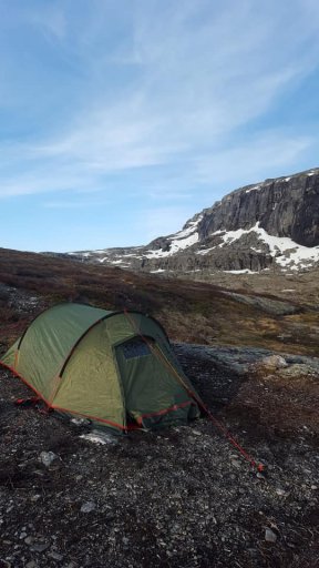

I think you will be fine with a heavy duty nail stake on gravel. It could feel loose in the grond and then just place some extra weight like a block of wood or rock or anything on top of the stake. Buy enough stakes cause u mind go damage them rather quick in hard packed surfaces.. + in heavy winds you just use extra tie down points to spread the stress wind puts on everything.
Did the same on this hiking trip in Norway (Trolltunga), spike hammered in the a crack in the granite and then a granite block on top of the stake (or the rope just around a heavy block).
Head some heavy wind that night and no problems at all.
(I know its not the same with a tent cause a tarp catches much more wind..)

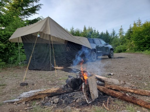

I like the popup canopy's, you can pick them up pretty cheap on sale and easy to move where you need them to be. No complicated rope tying either! Of course Harbor Freight sells one pretty cheap without a sale!
Search Results For "popup" canopy
They also sell an enclosure for them as well, screen or solid sides !!
1,685
Pacific Northwest
Claggett
U. S. Army
Is this a complete package with tarp, poles and screen room ?
Yes, all poles, pegs, rope you need to setup. Well made in USA, they run sales time to time and you can save $50 +/-.

Hey,
Enjoy :) View attachment 115876View attachment 115877View attachment 115878View attachment 115879
Nice set up. can you give more info on the tarp and poles (name and brand) . What is 3x3 DD Hammock ? Can the items be bought in the USA ?
Is it similar to Slumberjacks products ? It looks like a slumberjack awning. Real nice place you have, I'm an architectual nut and like seeing architecture from other countries. Your lawn is beautifully kept !
Hi!
DD Hammocks is the brand of the tarp. 3x3 means 3 by 3 meters, I think u can get them in the US Products . The poles are telescopic twist locking system I bought at the local camping store so nothing special, many different brands. For cordage I use 550 paracord.
The architecture in Belgium is pretty decent ;), and so is the eye for detail! If u like to see more pm me. The grass was still pretty fresh laid a couple months before the picture . But it is still very nice and green! Thanks!
If you like to know or see more let me know.
Happy to help!
