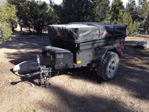

image.jpg image.jpg I was lazy.... So i just made a simple rack. There are some rails you can source from truck outfitter companies. Thule for example did have a aluminum extruted rail that came in 3' lengths.

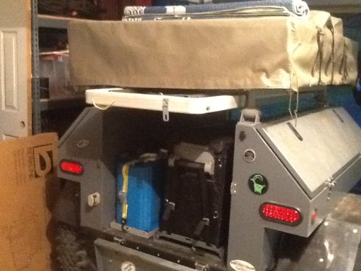

image.jpeg image.jpeg I made a simple rack with 1" square tube and bolted the tent to that. The table is mounted under the tent. This pic is the rack uPside down when I added the table rack.
