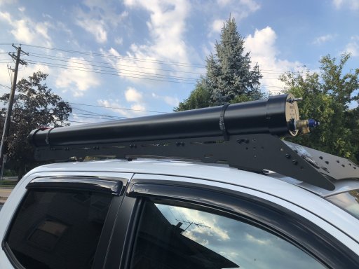

We purchased the gravity fed solar shower bag.. Still have yet to use it. I've seriously considered one of these tubes..for ease of carrying.. I also would probably use fuel cell foam to put into the tube to help prevent the water from sloshing around as much while driving around..
@Zeroviz, what type of roof rack is that?
