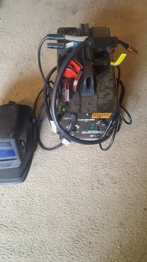

Is your welder the old 90 amp or the newer 120amp? Ive got a newer one. Do use th hf wire or a better mfg?View attachment 140794

90 amp and the first thing I did was toss the HF wire in the garbage and get a new spool, what little welding I did with the HF spool was a mess, no matter how I adjusted the unit I couldn't get a clean weld, apparently that's a common complaint with the unit is the spool that comes with it, is garbage.
I've burnt though a couple of spools by this point the current one I have in there is whatever brand Lowe's carries.

Did you do the dc negative conversion? That supposedly makes them weld like a hobart. No splatter. I planned on trying to tack weld everything into place and get it welded professionally but i suppose ill try and give it a good bead and see what happens, i know im not paying a welder $650 for it.

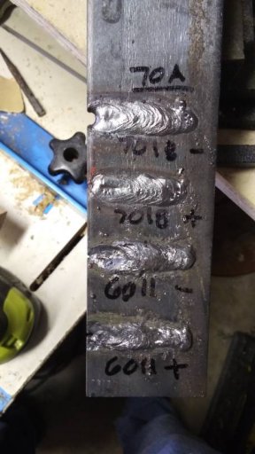

Get some extra pipe and practice. Mig can be tricky but you'll get it figured out. Get a piece of scrap and cut notches to weld back up (and take notes). Test a variety of wires, amps and polarity to find what works. We used to butt weld two pieces of flat together and bend it over until it broke to see if we got the wild right.
I never got the hang of mig. My high school welding class only had one to share among 12 students and the rest of us used stick. I just didn't have the inclination to learn it back then because I wanted to get my projects done.
My little 110v stick welder does pretty good with some 3/16" 7018s though. I need to practice with the 6011s though.View attachment 140825View attachment 140826

@Boostpowered i havent done any mods to mine. Just welded stuff with it. Theyd need to be conveted to DC since they are AC welders out of the box.
