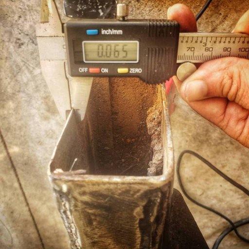

Got my supplies in to finish patching the holes in the frame. After blowing a few more holes on the inner frame (even with my welder on its lowest setting) I ground the endcap off to get an actual measurement. 0.065, roughly 16-15 gauge, channel is what's welded on the inside. I don't feel like that will be structurally sound enough to tie my frame extension into. The outside channel is 10 gauge, so that'll be fine. Now I'm replanning how to go about building this....IMG_20191104_152224_217.jpgIMG_20191104_152224_218.jpg

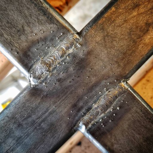

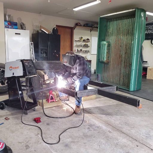

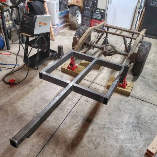

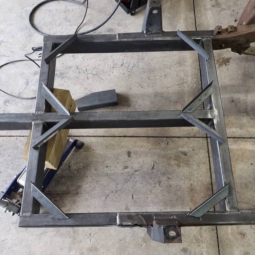

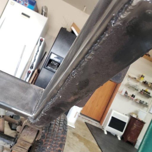

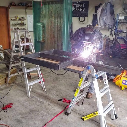

Picked up a 20' stick of 2"x4" 11 ga. rectangle tubing and had it cut to lengths for me. Double checked my measurements and cut a few pieces to make them fit properly. Mocked up the new frame extension and tongue. Then took it all apart and welded everything up. I don't have much welding experience, but this little Mig welder with flux core wire does a great job! Tomorrow I'll weld the two frames together, cut and install some gussets on all the corners, and hopefully get the hitch built. I'm really liking how this is coming together so far. 20191105_123539.jpgIMG_20191105_132515_193.jpg20191105_135149-01.jpg20191105_135205-01.jpg20191105_142103-01.jpgVideoCapture_20191105-164548-01.jpg20191105_164335-01.jpg20191105_174314-01.jpg20191105_174328-01.jpg

It’s looking good! Anymore pictures from where you added the receiver at the front?

Sleeving the new into the old is genius, man.. that is gong to be bomber when you get it all zapped together. Nice work!

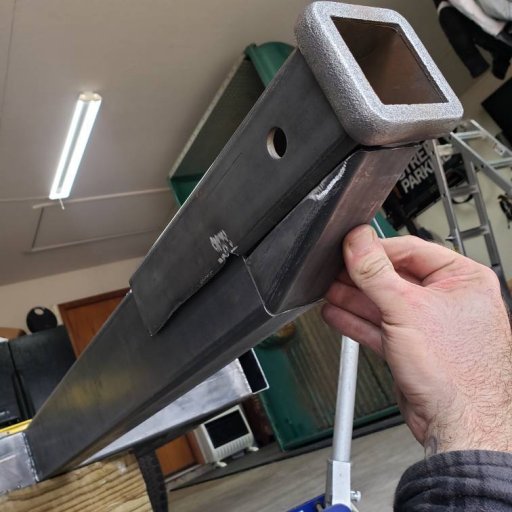

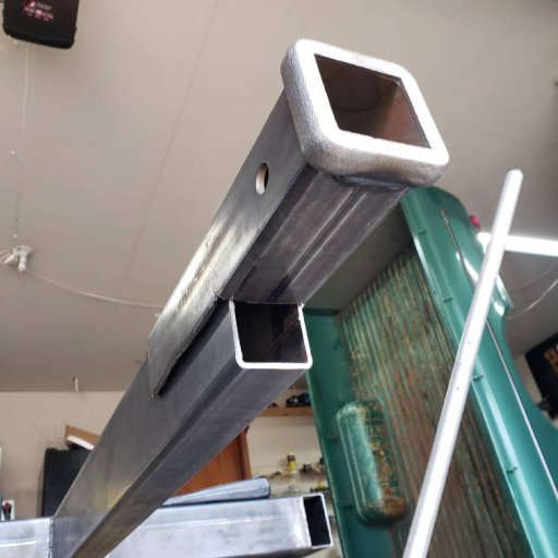

Now for the hitch. I ran the center joint 32" out from the front of the frame. No, this is not far enough for me to turn a full 90°, but I'm not done yet. I then took a 2" receiver tube and "notched" out roughly 6.5" so that it could set down over top of the 2x4 center frame rail. Once I got that piece setting level, I took a spare piece of the 2x4 tubing and cut a triangle shaped piece to weld in from the bottom of the center rail up to bottom front point of the receiver tube. Once I got all this were I liked it, I welded it all together and it isn't going anywhere! This put my receiver hitch pin hole at 35" from the frame. Once you add the length of the actual hitch (8"-12"), the tongue will be setting at just under 48". 20191106_113945.jpg20191106_114026.jpg20191106_114111.jpg20191106_114131.jpg20191106_114224.jpg20191106_121244.jpg20191106_122641.jpg20191106_114418.jpg

Nice at work. At this point you might as well should have just designed a whole new FRAME though. Instead of having to cut and weld so many pieces together to fit into the trucks frame.
I seriously thought about it! But two factors kept me from doing so; 1) price - that would have cost me another $100 in material, & 2) functionality - I want to utilize the original suspension and change of frame elevation for different aspects of the trailer.
