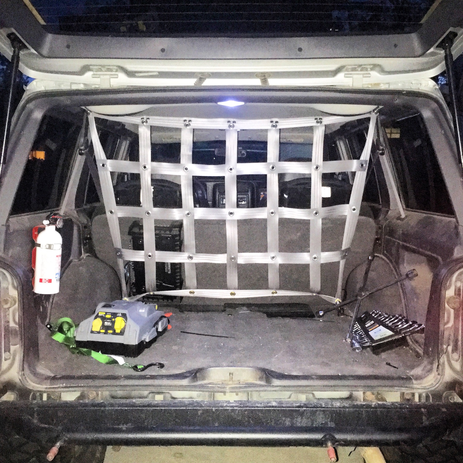

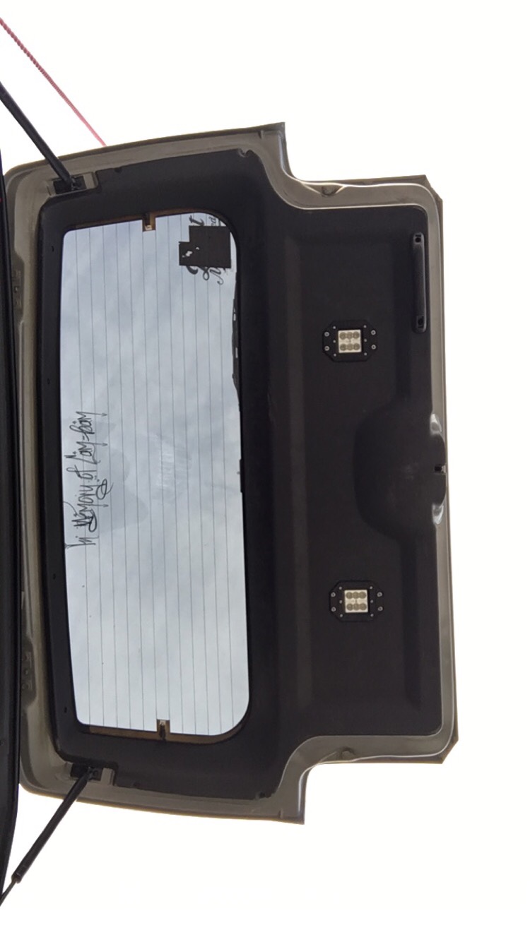

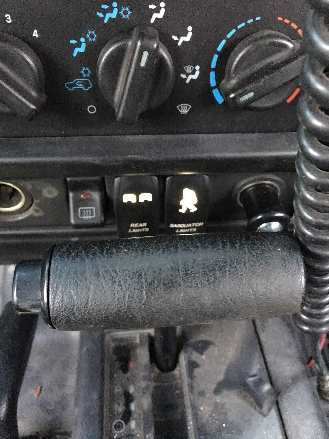

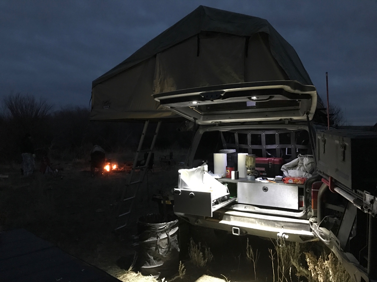

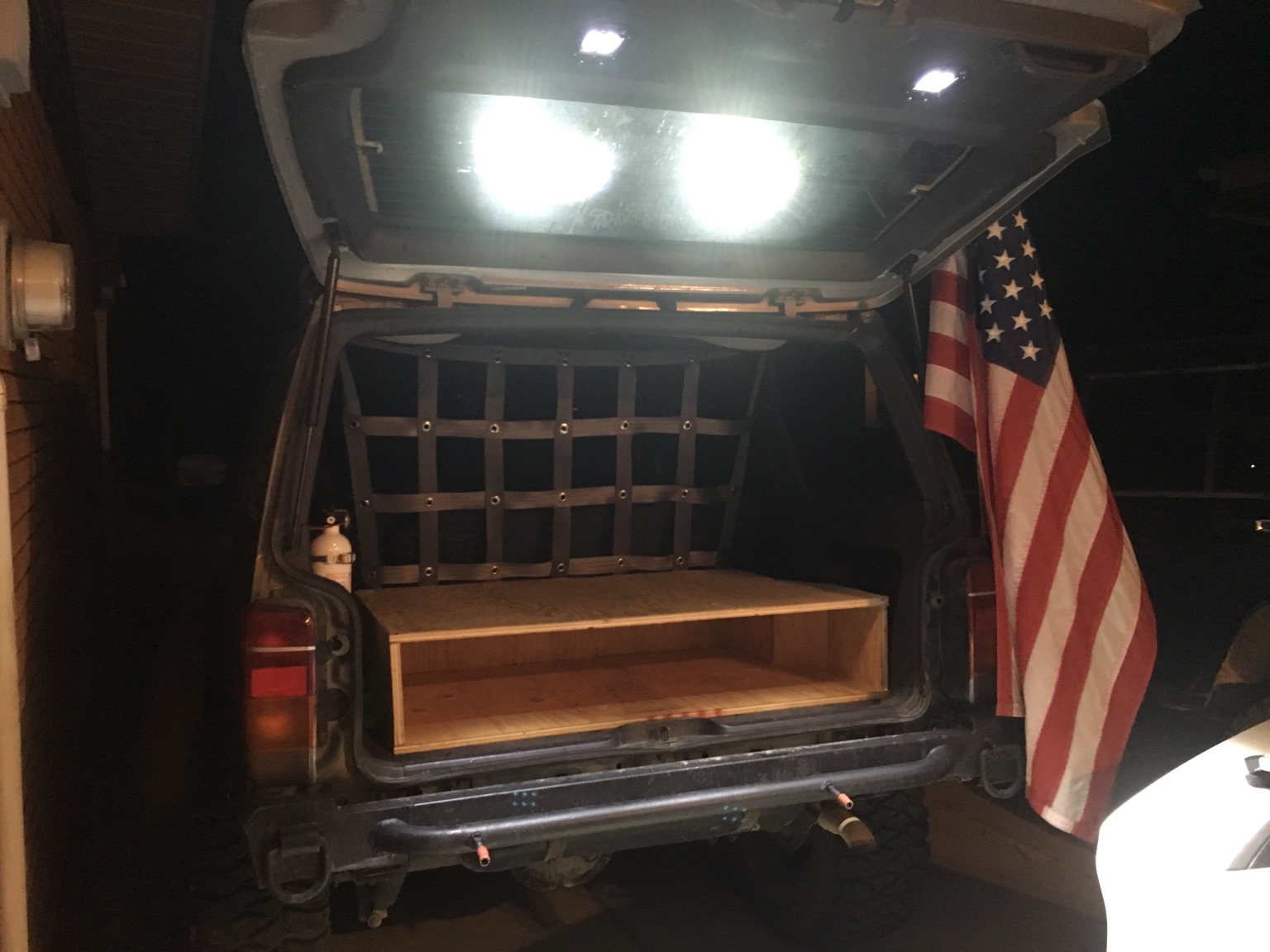

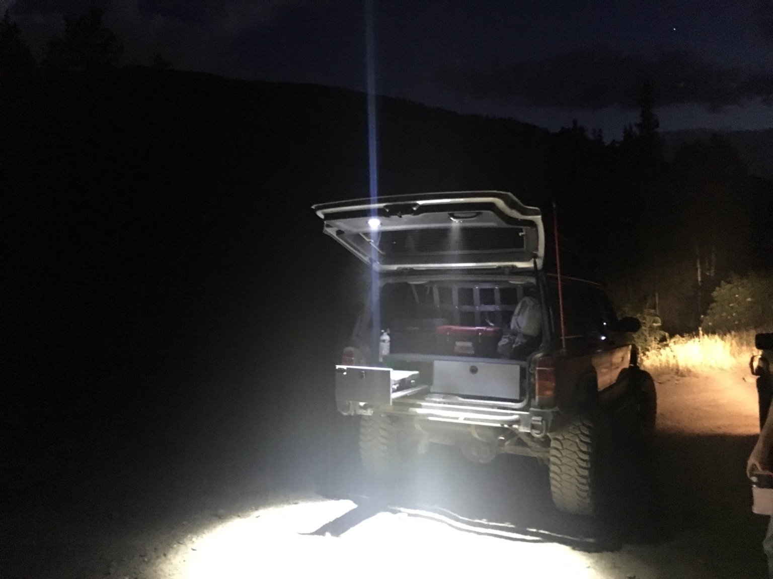

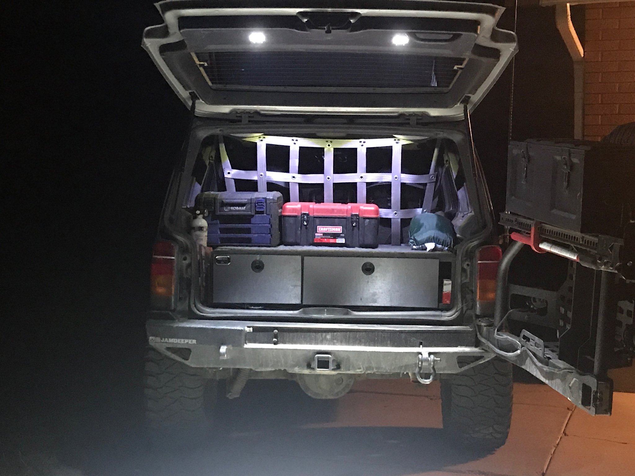

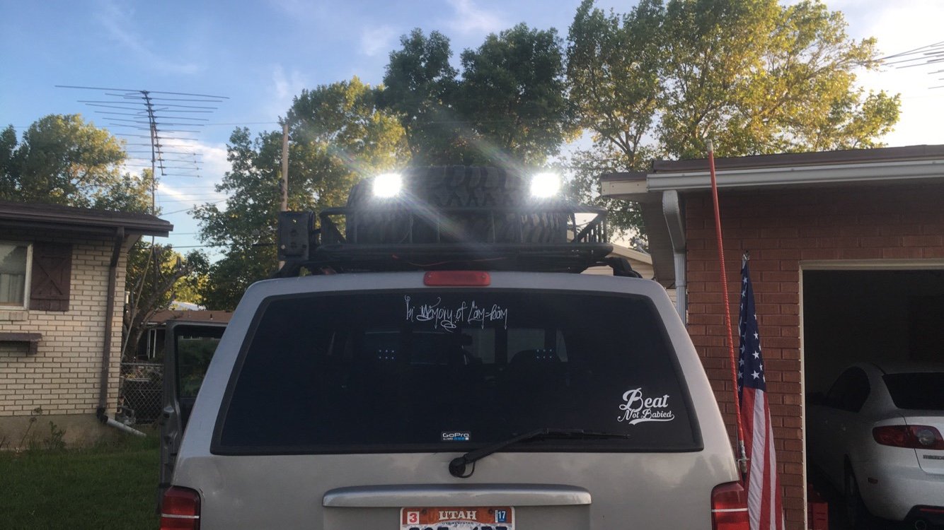

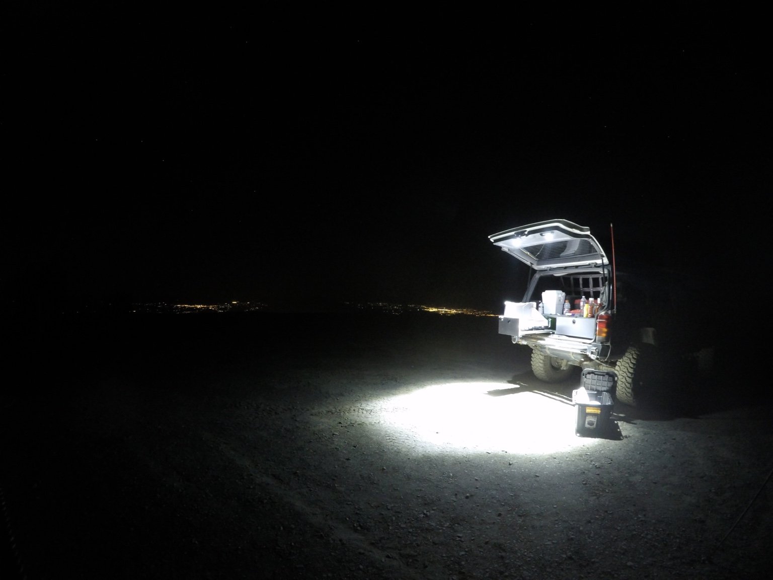

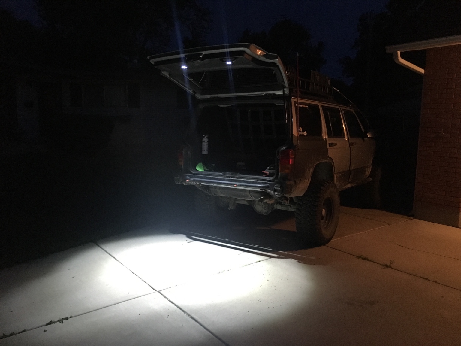

Tonight I installed more lights in the rear of the jeep. The hatch lights are more external than I'd like, so I put the same lights I used under the hood in the top trim piece of the rear hatch. They ended up being pointed a little higher than I wanted, but it's much better than before.

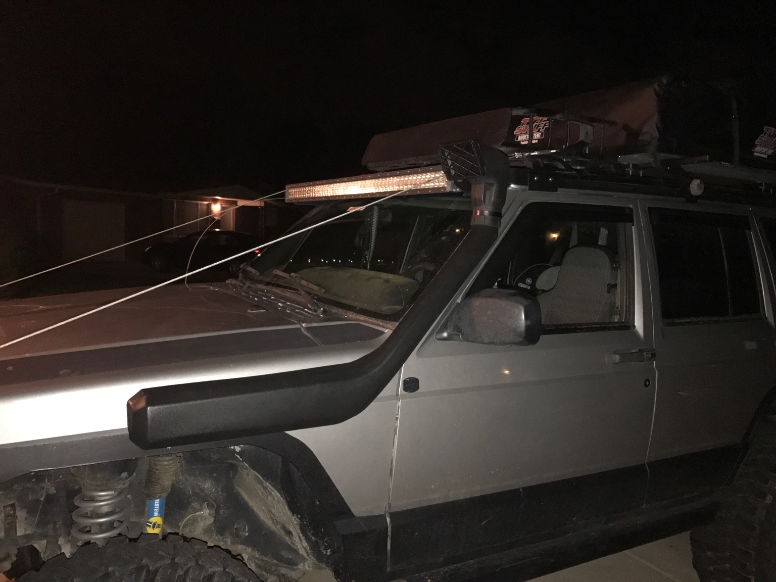

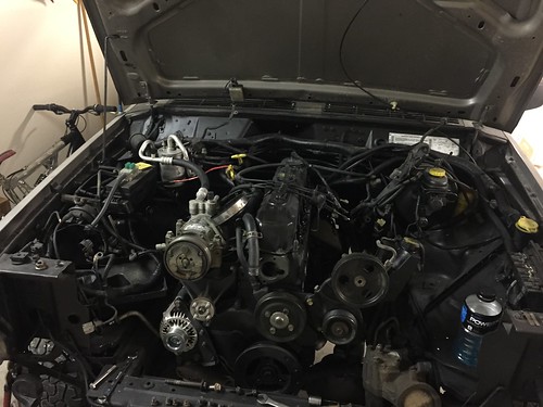

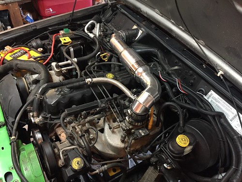

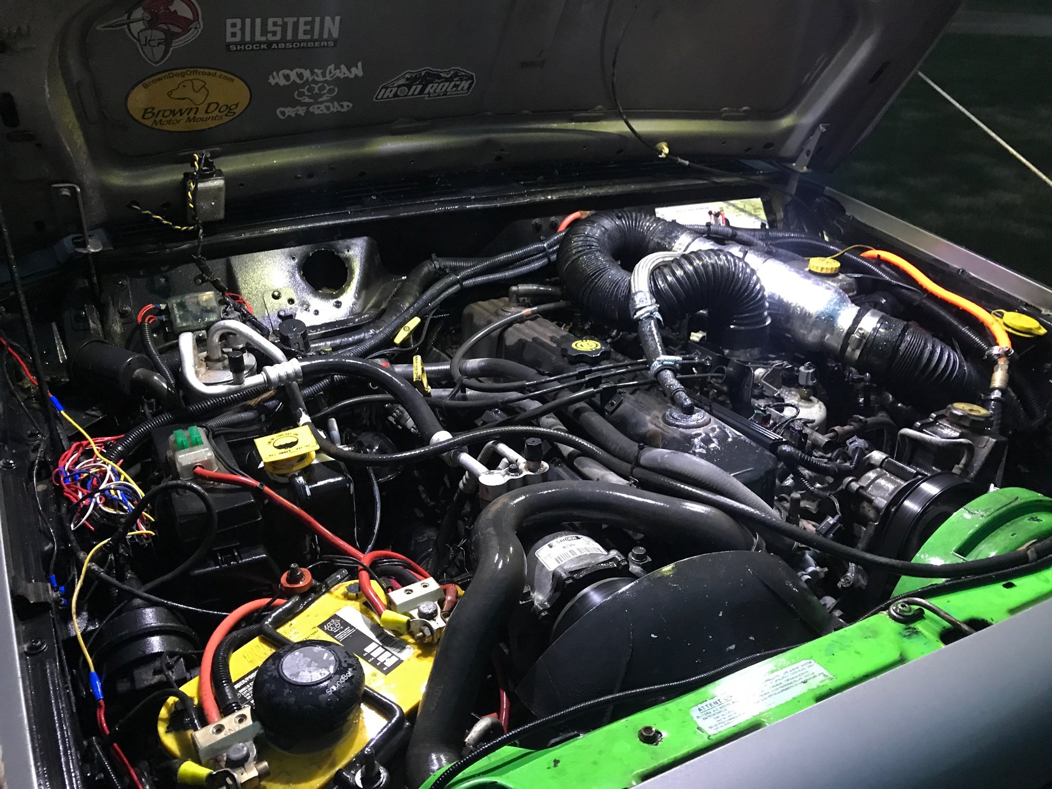

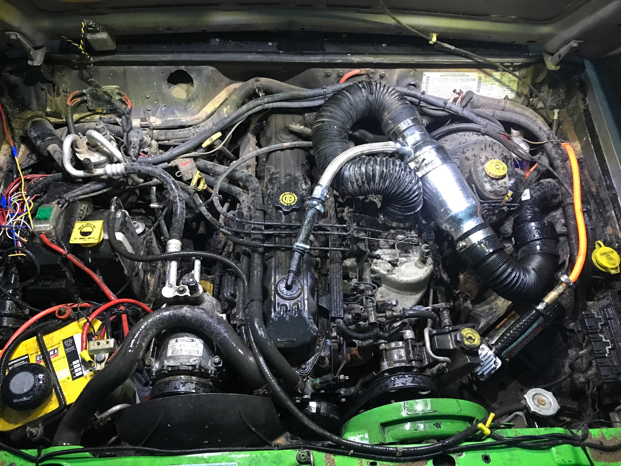

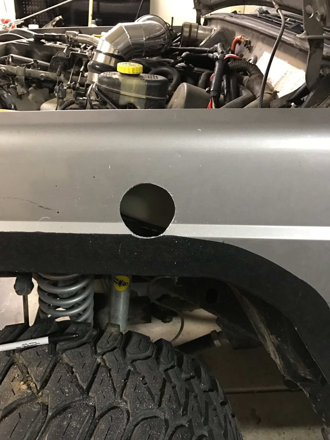

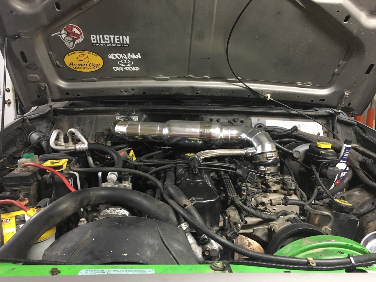

Finally got around to re routing my intake hoses under the hood. I ended up taking my spectre cowl intake and cutting the filter part out of it. Then took a flex tube at each end from the intake to the snorkel. Doesn't look too great, but it'll do.

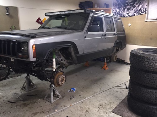

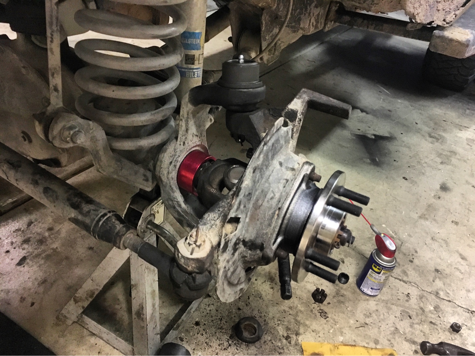

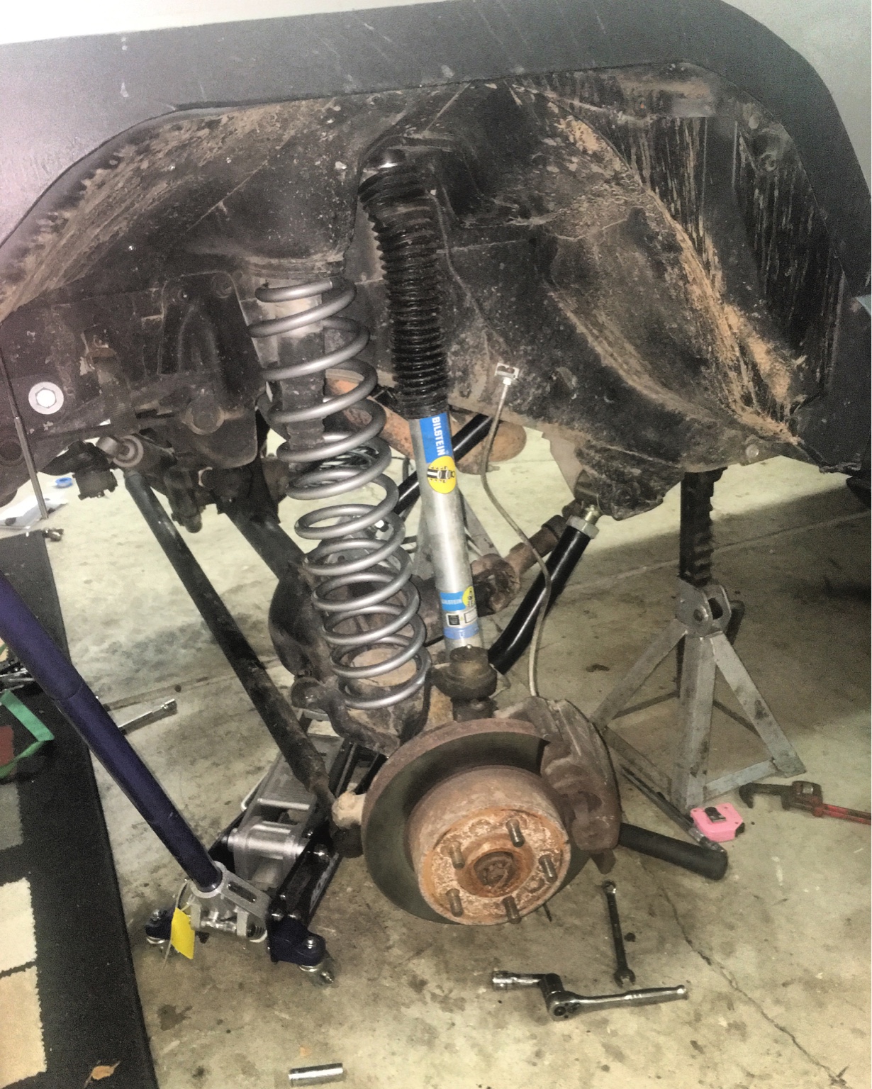

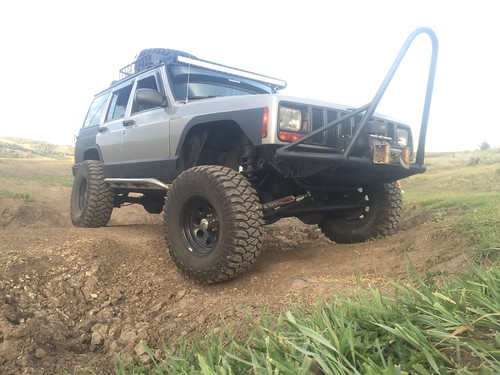

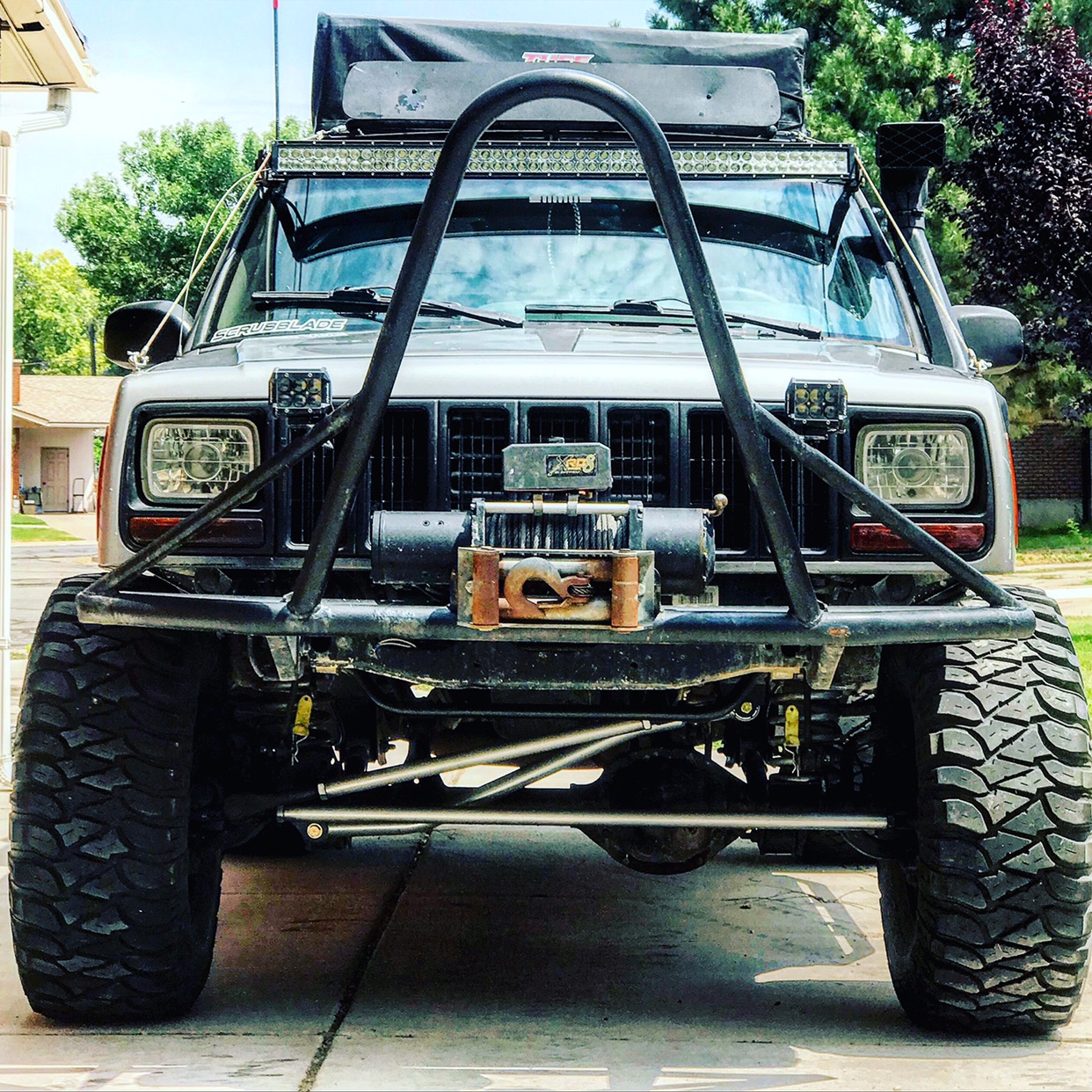

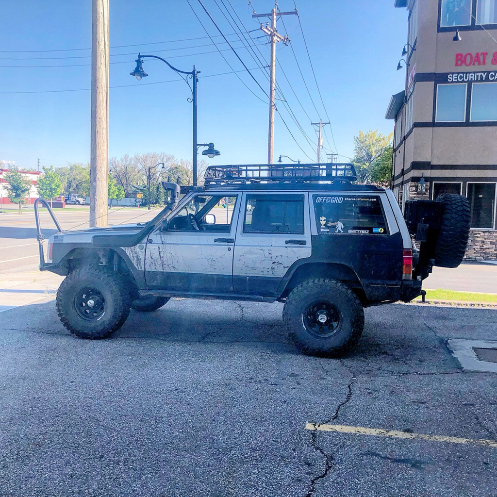

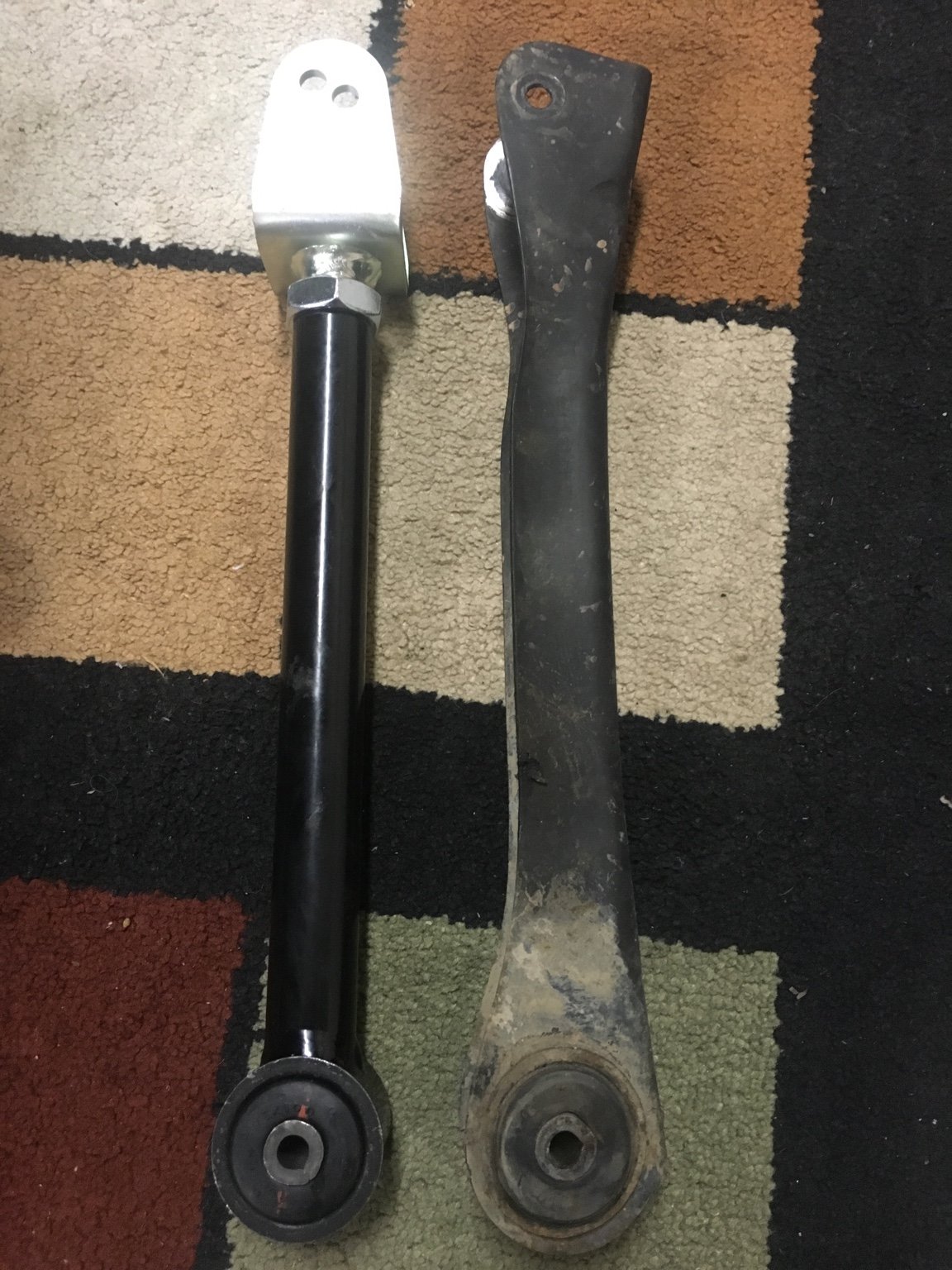

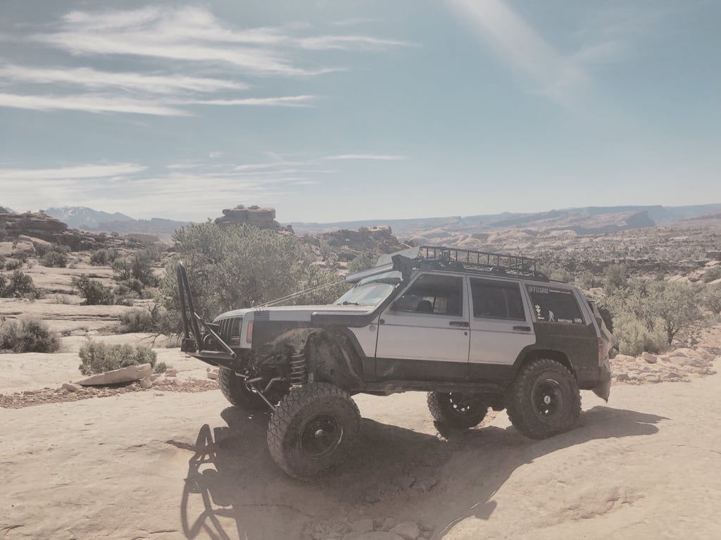

Got a chance the other day to finally swap out my track bar. As of now, everything has been replaced on the from end since last March. From control arms to hubs. My steering has been completely changed and I feel like I’m driving a different Jeep!
I also made a video on the pros of a new trackbar with before and after-jeep videos.
Also took er out for a shakedown run for an overnighter. Man I love this setup.

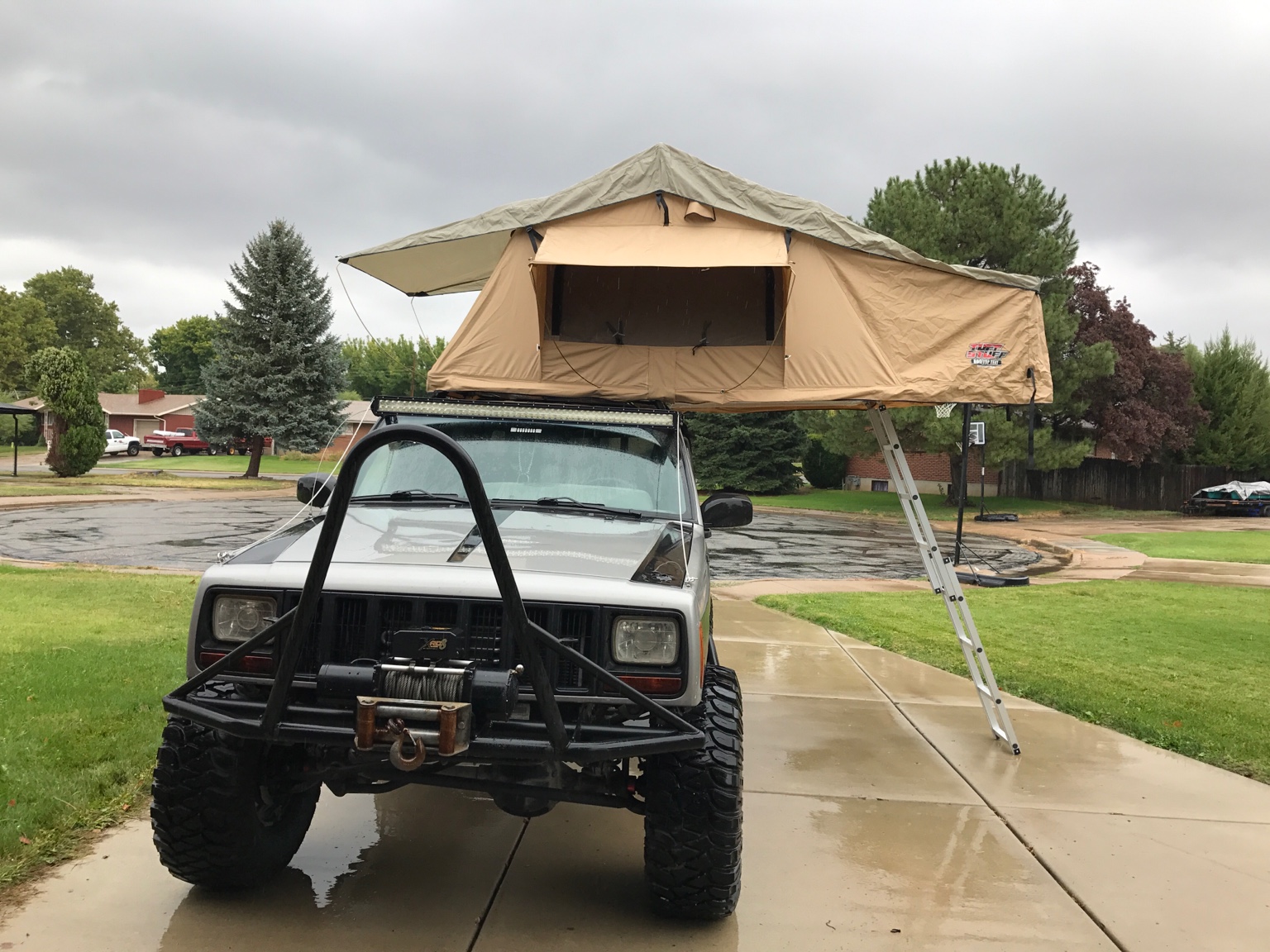

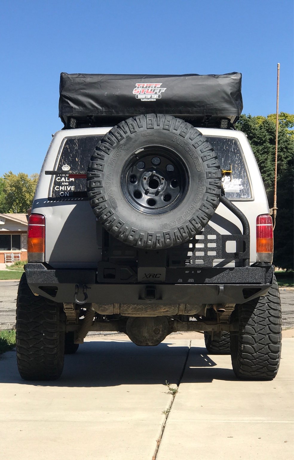

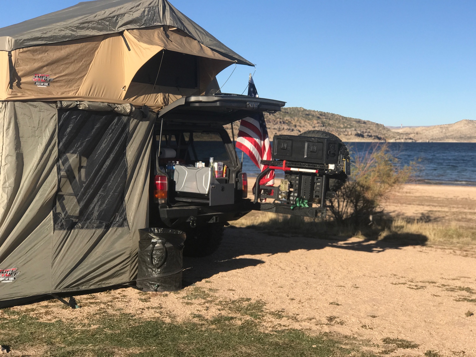

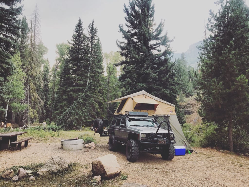

What are your thoughts on the Tuff Stuff tent? Really want to pull the trigger on one because of the price and what it comes with. Just wanted to know from someone who has one.
jamdeeper
1,402
Ogden, Ut
Easily the best addition to the rig. The cost is the answer in itself. The quality is top notch. I have not had 1 issue with mine.
In fact. I am eyeing up the double wide tent now that they sell it. I need more room for the whole fam to go. I would definitely recommend it.

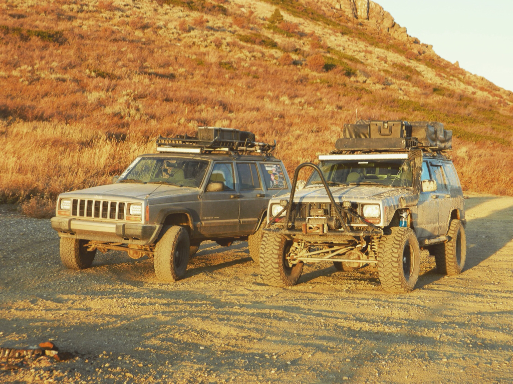

Haven’t been on in a while. Still cruisin around. Here’s a few tidbits since I’ve been gone.
Went camping
Took a drive
Another drive
It snowed
Bought 2 more jeeps and a dog

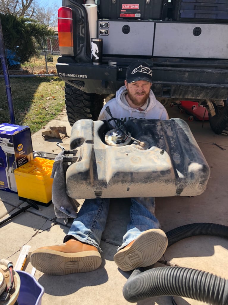

Changed fuel pump
Bought a drone

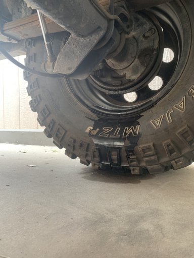

Bought new tires MTZ 2s

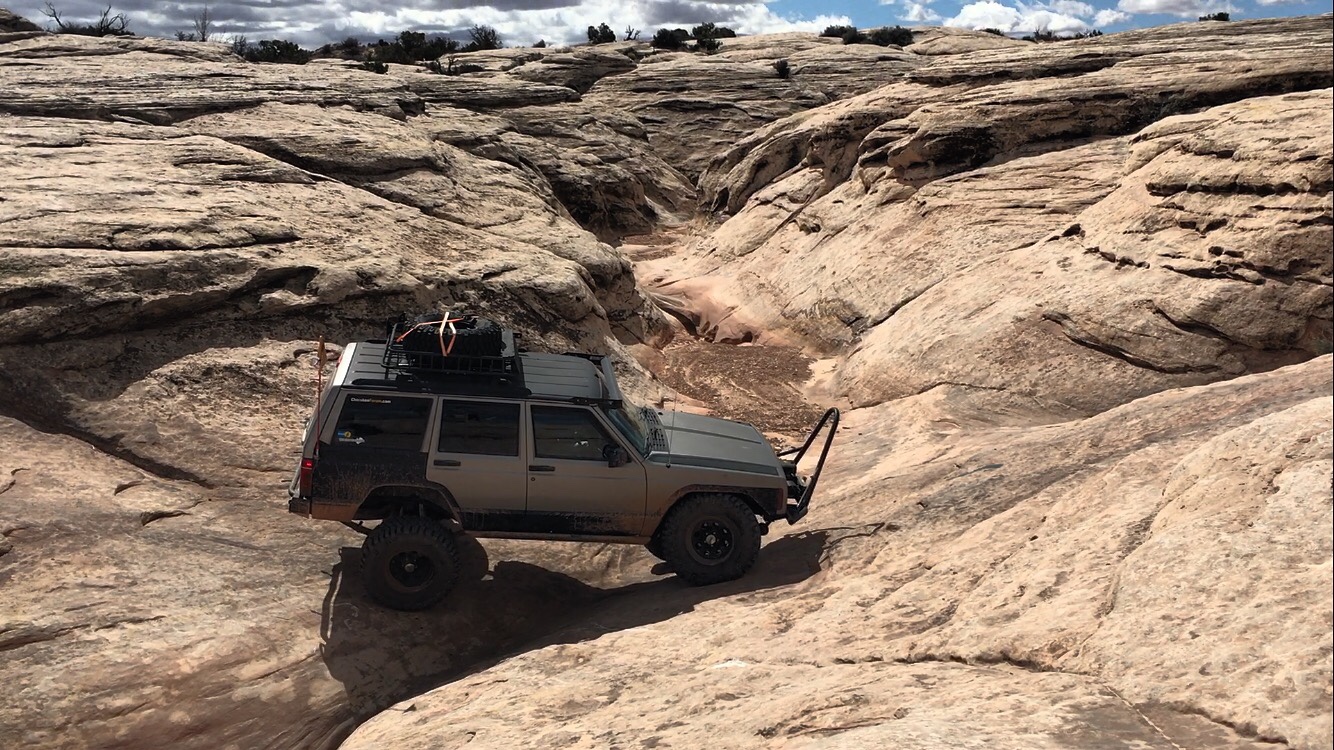

Went to Moab Easter safari
Easter Jeep Safari Vlog
Took another drive
Bought another jeep
This was last week
Been pretty busy with work and life and everything else adults do. Not much new with the jeep besides the fuel pump.

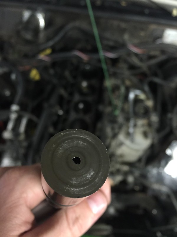

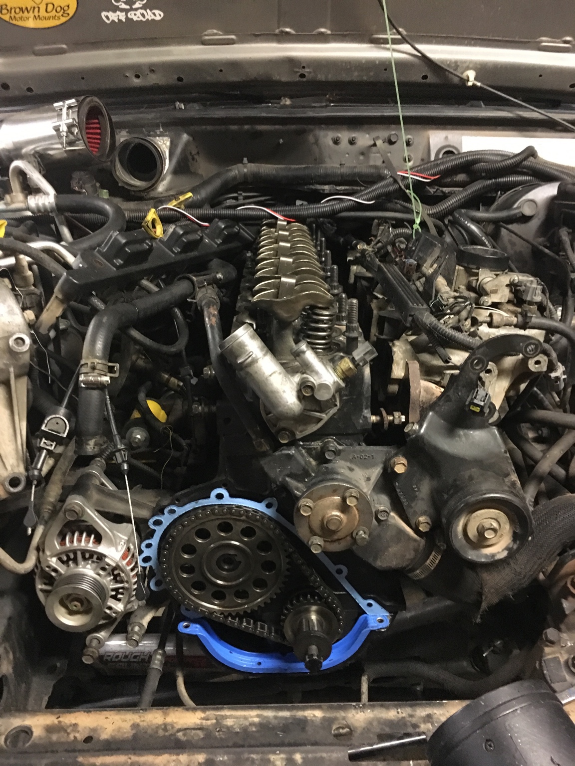

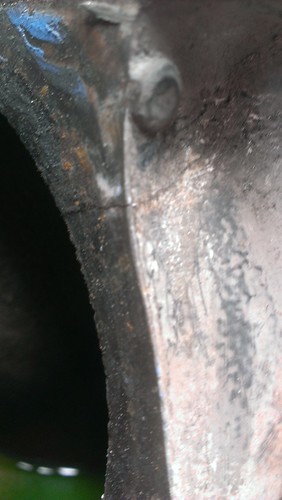

For 7 years I’ve had this jeep and it has had a check engine light on since the day I bought it. Evap leak- something I could ignore.
Well, I finally fixed it. Found out the Evap can had a huge hole in it after taking it out and seeing it was smashed in. Went to the junkyard and pulled one out for $5.50- 3 bolts later and the light is finally gone. [emoji1360]
Next up was the airbag light. Since rebuilding the engine, it’s been on from when I replaced the steering box and broke the clock spring somehow. Swapped that out and now all wheel controls and horn work.

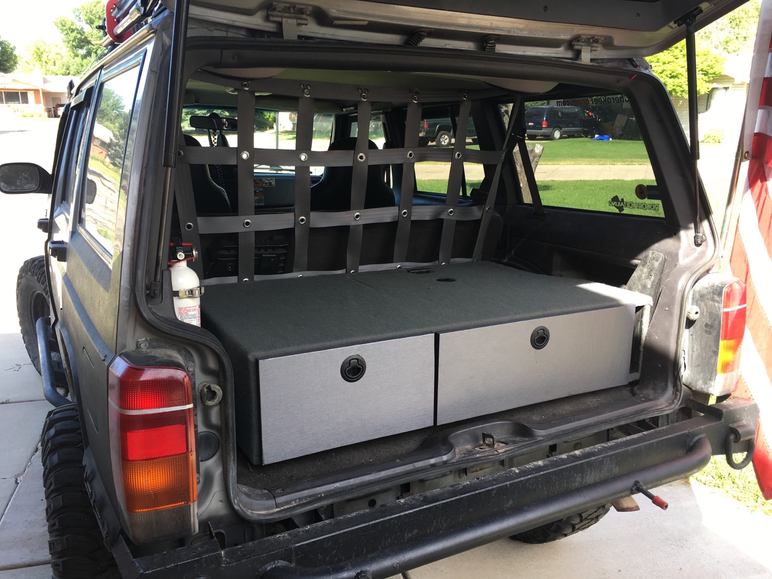

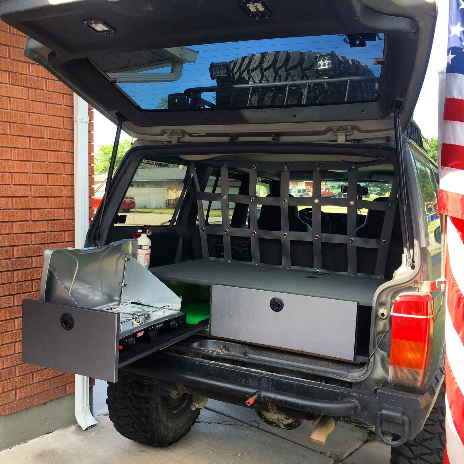

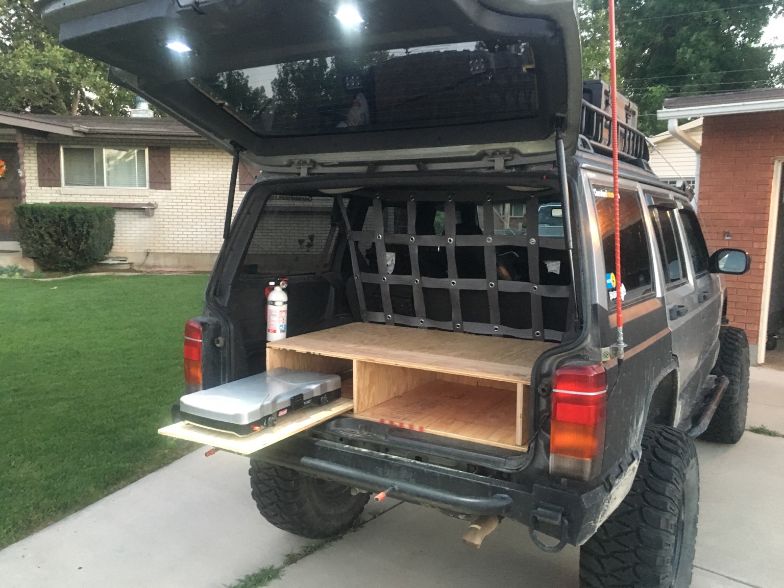

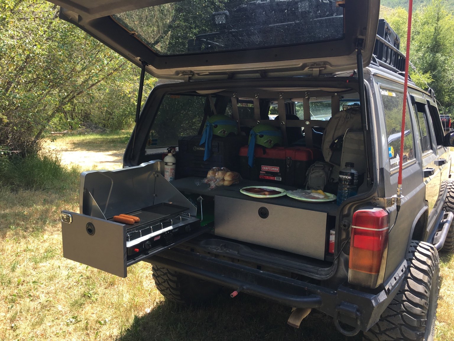

On a kinda sad note, I’ve sold my rear drawer setup— I feel it’s time for something new. I’m going to attempt to do one of the double slide drawers for the stove on one side, with just storage on the other. I’m also hoping to do something a little slimmer since now we have a full grown lab that we’ll be taking with us and he has a hard time sitting up with the taller box in the back.

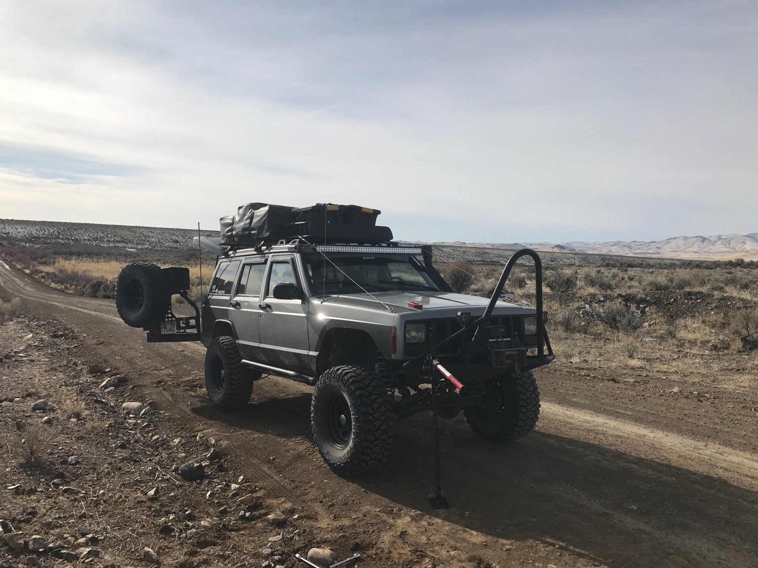

Took a trip a few months ago up the northern Uintas.
It was the first trip in about 2 years without my drawer setup and it only wanted me to get making another one. (Easier said that done.) it’s coming soon. Just want to get everything in order and all ideas on the table.

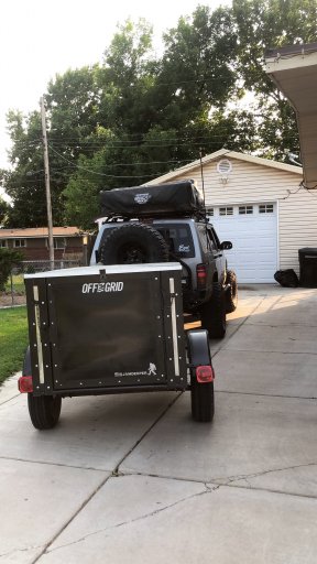

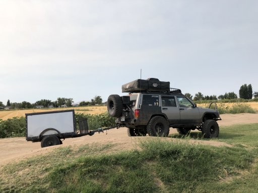

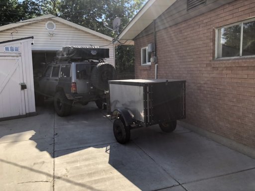

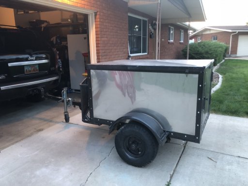

In the mean time- I came across a sweet little trailer and couldn’t pass it up.
First order of business was flipping the axle. It ended up giving me about 3 inches:
Next I threw some lights on it, not a huge deal, but with future plans, I didn’t want the jeep lights to be obstructed and get the law dogs after me.
Next in line is a new axle- nothing wrong with this one, but the fact it’s 5x5 lugs on a weird size hub rated for about 5500 lbs?
With a new axle set to be about 8” longer (4” each side) I plan to get it all set up for some 33x15” tires and wheels to match the jeep. Tie that in with some jacks and a roof tent rack and I’ll have a ~$800 adventure trailer ready to roll.

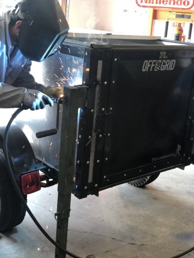

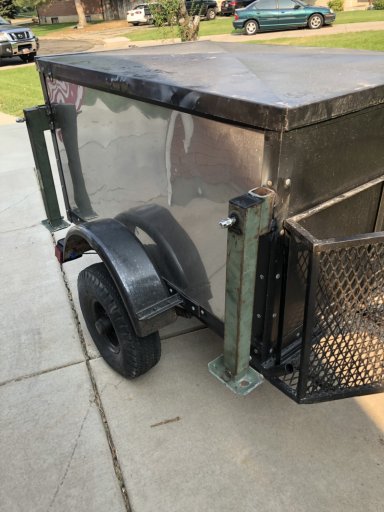

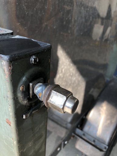

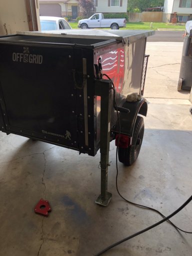

Took a minute today to throw the jacks on all corners. Once installed I realized I’d hate to hand crank all of them so I cut the handles off and welded a lug nut on the gear drive. I will carry a 12v drill with socket for quick jack deployment. [emoji1360]
Next will be a paint job as I wait for the new axle setup. As well as figuring out how to turn the roof into a lift hatch. Stay tuned [emoji1598]

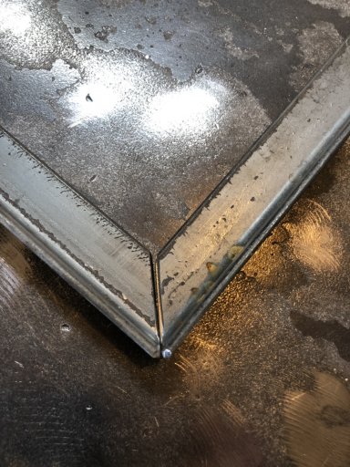

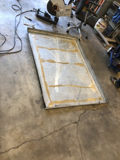

Little progress on the trailer yesterday.

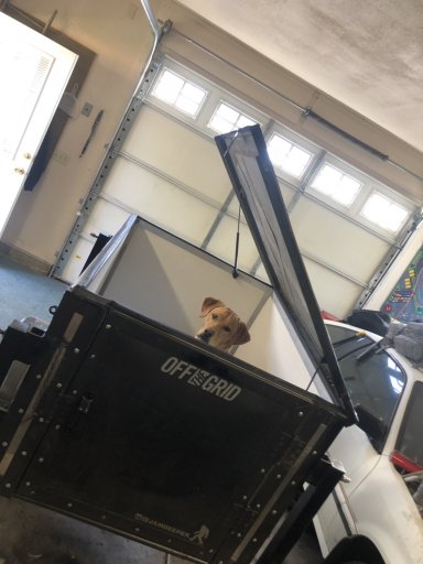

First framed out some 1” 90 for the lid.
Welded on some hinges and set some gas struts. Voila.
Going to be a few weeks before the tent rack can get installed. Hopefully I get the axle and wheels before camping this next weekend. [emoji573]
