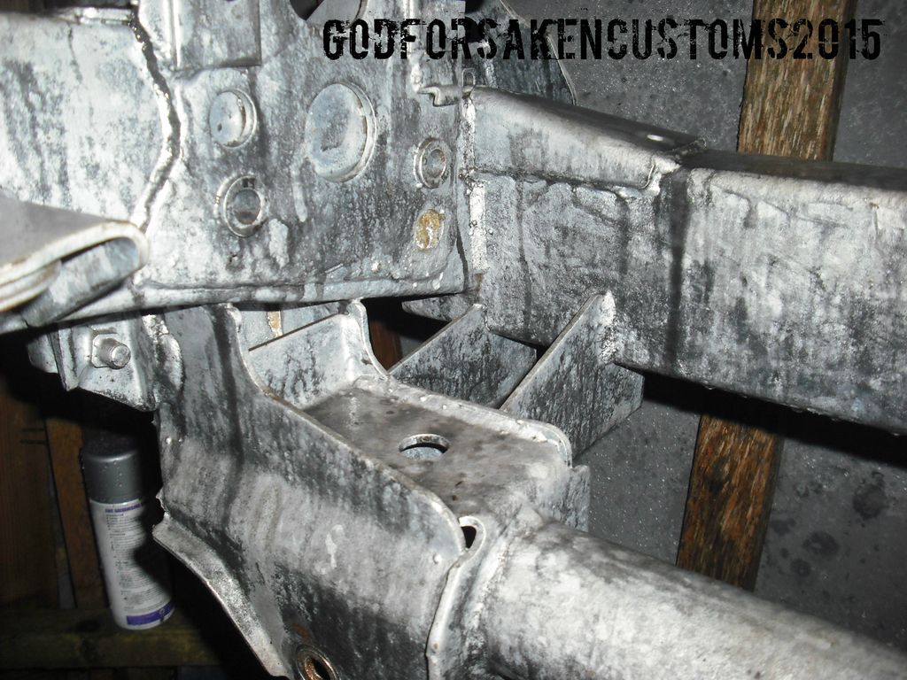

So with regards to the build, knowing the weak spots of these trucks (I've saved and buried a few now) I managed to source a galvanised chassis (hen's teeth), and was given the donor in return for doing some work on a friends farm. The donor had been damaged and left to rust being used as an agricultural vehicle but that didn't matter with what I had planned. Please excuse the shanty I am working in!

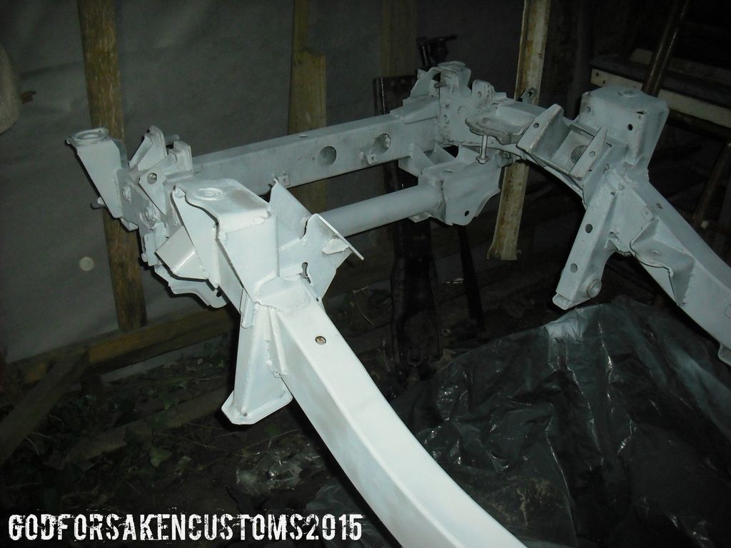

The chassis came with axles and steering gear, but this had to come out as I wanted to paint the chassis, just not a fan of the look. This process first meant reaming all the drain holes and re-tapping all the threaded holes to remove the zinc deposits. Then the chassis had to be degreased, washed, dried, then a Mordant solution applied (phosphoric acid) to etch the surface, washed, dried, acid etch primered, dried, and top coated black.

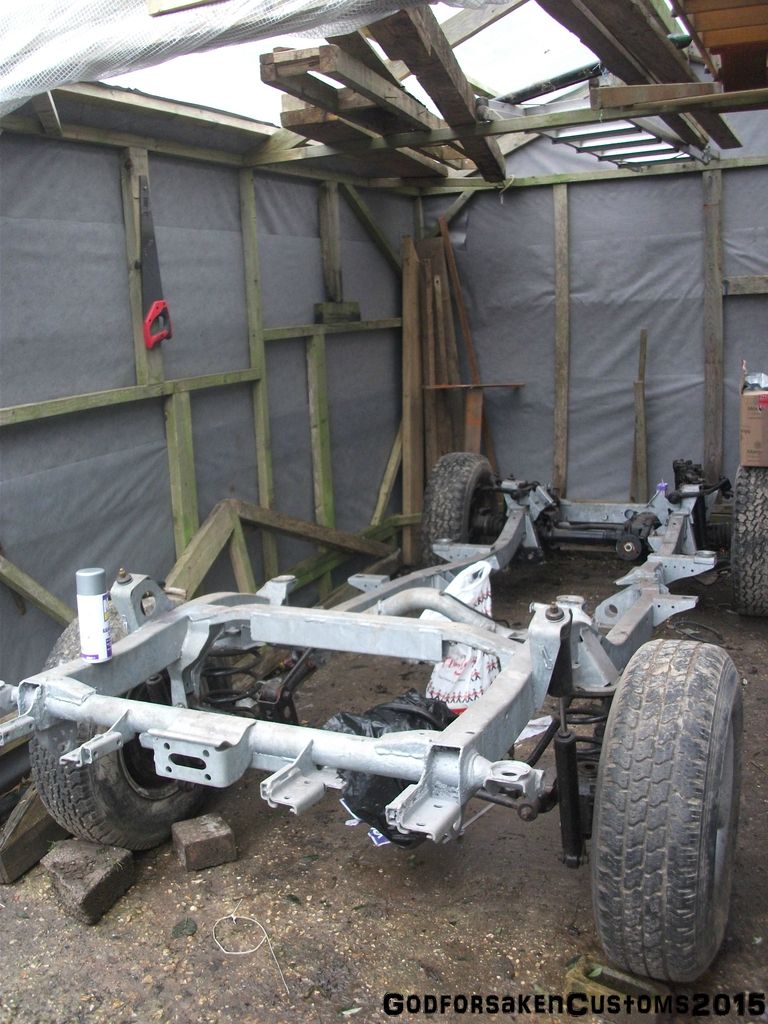

For now I've loosely put the axles in and wheeled it back into the garden. I'm documenting everything on Youtube if anyones interested, its a bit easier to detail certain things, the videos do get better as they go. I can post links as I go.

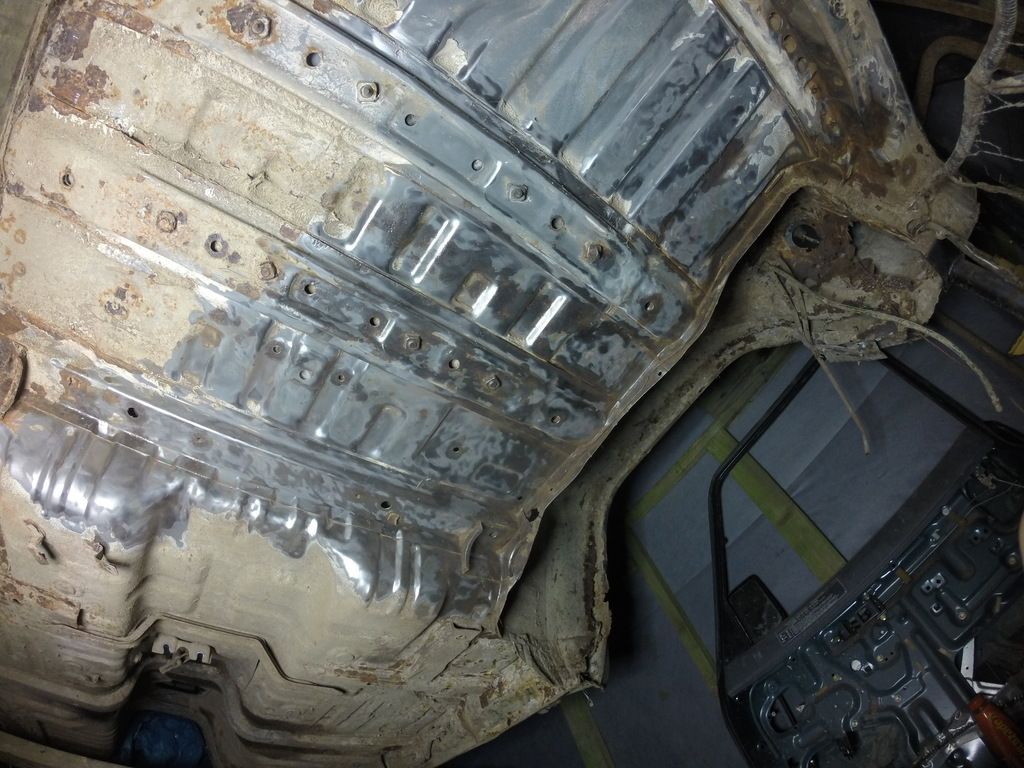

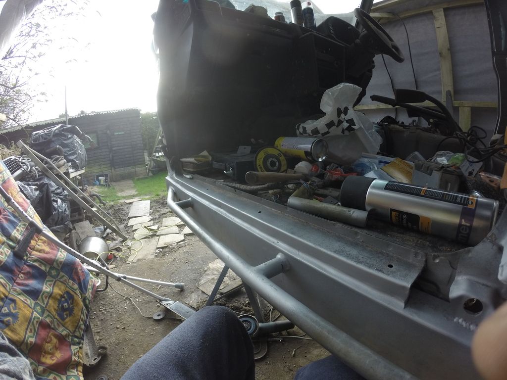

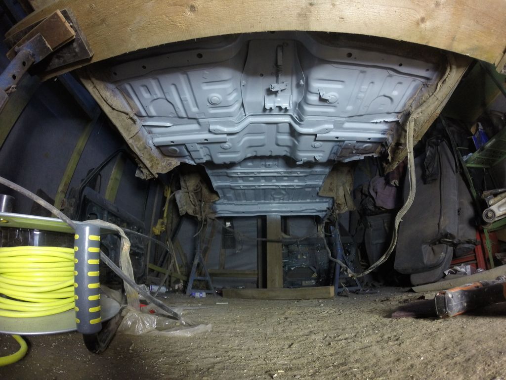

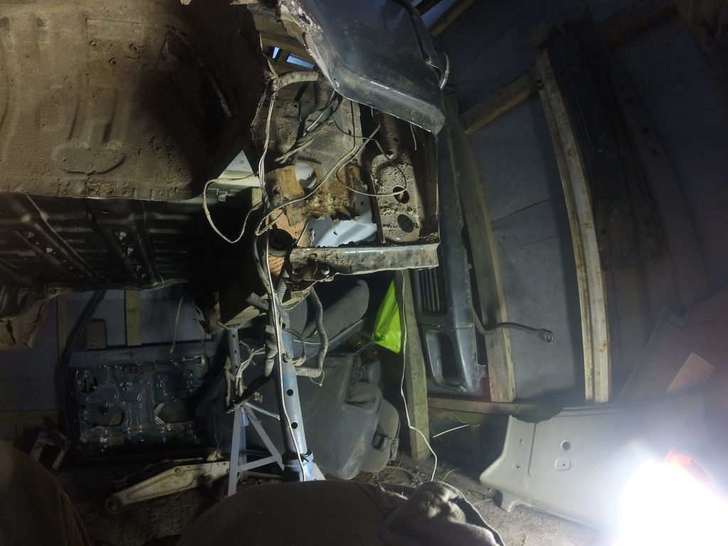

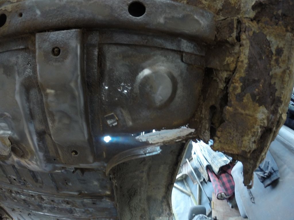

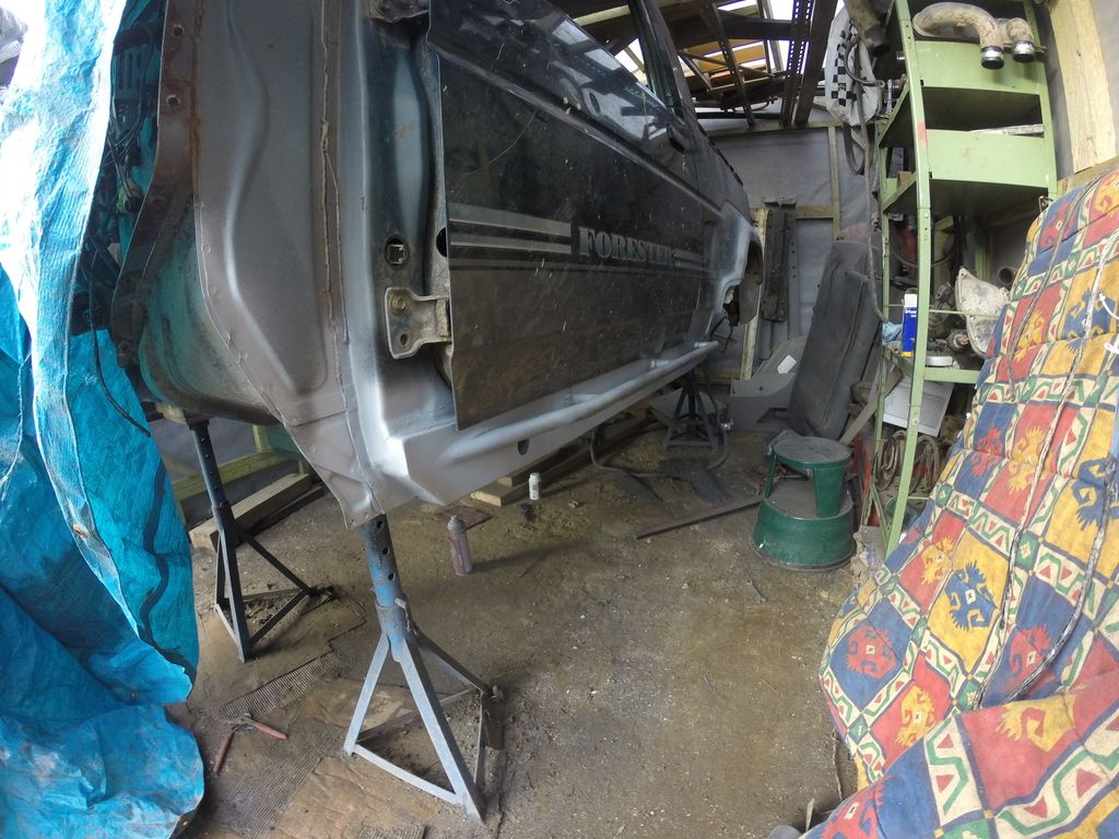

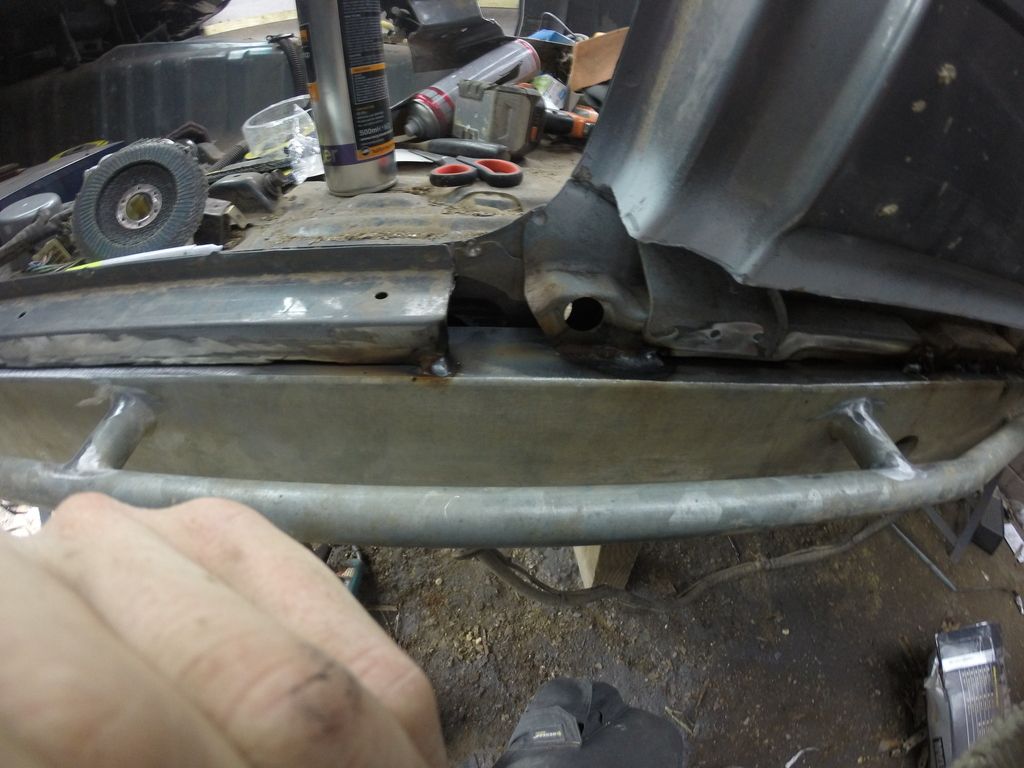

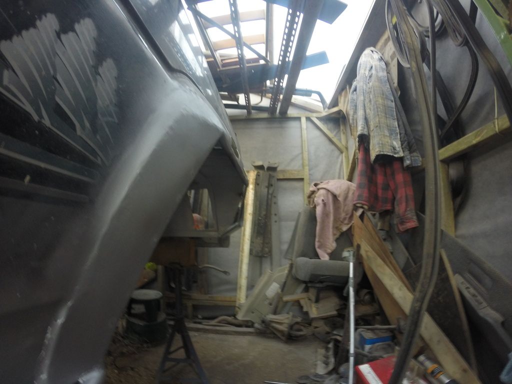

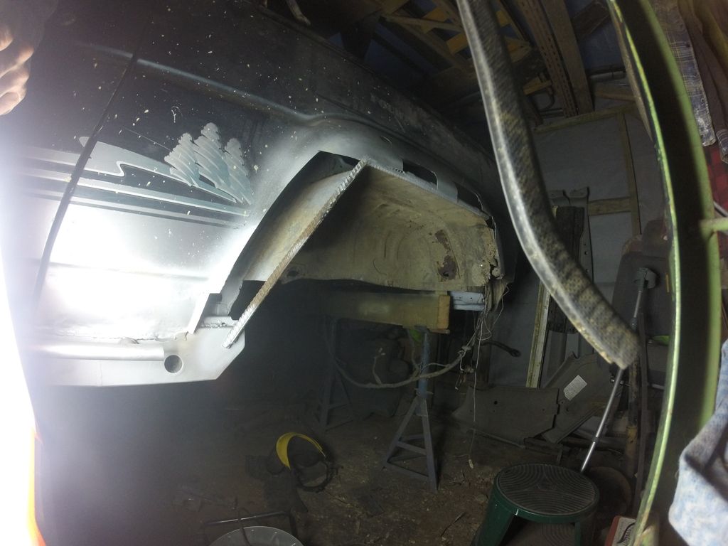

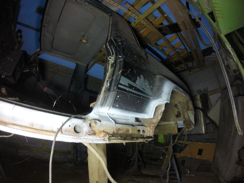

The next task was stripping the donor down and removing the body, not an easy task on your own with a jack and some stands.
