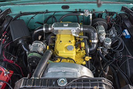

Hollingsworth67
Just wondered if you made any progress on the ISB 3.9. I work for a company that does nothing but diesel conversions, (mostly Cummins, some VW tdi) and the biggest challenge with the ISB 3.9 was actually getting a tune for it, but I think we've finally solved that. The 3.9 ISB is also not a small package. I have one on the shop floor right now that we're dimensioning as a potential donor for an early Range Rover. We have used them for conversions (pictured is a 66 Ford ISB/Allison we did a year or so ago) and if the tune/turbo trans package we have now works, it's going to be a great swap. We've also used the new Cummins R2.8--(we're an installer) which to my understanding is not the same engine is the much maligned ISF2.8 and hasn't had near the issues. I'm not here to sell any one engine over another, I was just curious if you decided on an engine or were still doing some research. small.jpg
