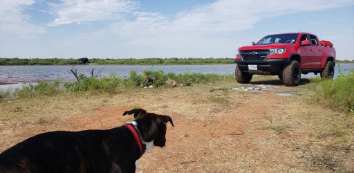

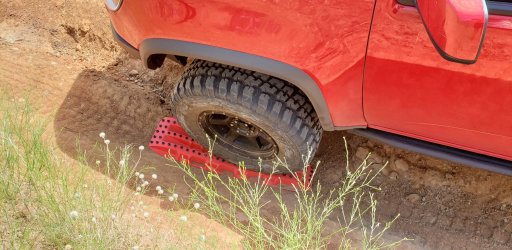

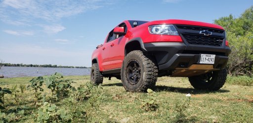

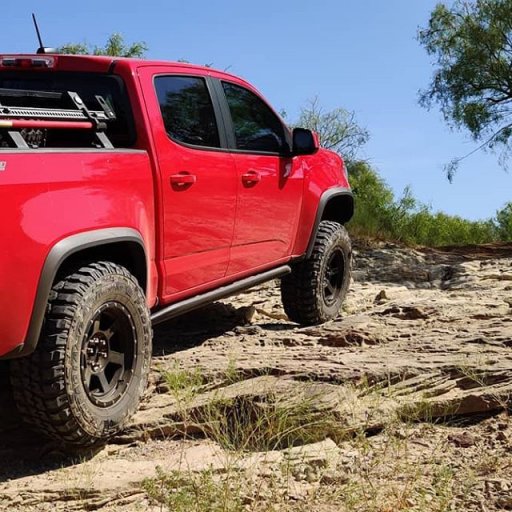

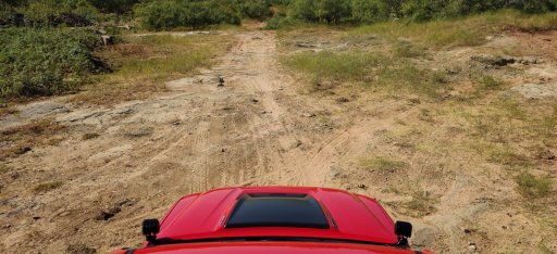

Here are few more pics from Last weekend! I'll have even more from this weekends Overlander meet in Coppell! And I may even have a few cool things to reveal as well!!

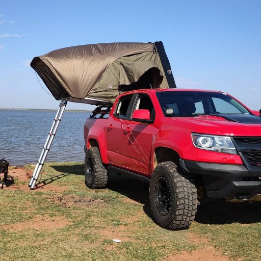

Awesome News!
I have placed the order for my new tent! I am working with Crusader Overland to bring in a tent that has not been seen in the industry to date! This is going to be a Game changer. Stay tuned to see what it is Once it arrives, and as soon as we get it we will be opening up pre orders as well. This is a huge void in the industry that is about to be filled. especially for those of us with trucks

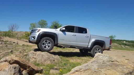

Im not sure what your definition of travel is then, i dont have a zr2 i do however have the z71 duramax and a 3 inch lift all around using spacers up front and shackles in rear. Ive offroaded in fairly large rock gardens and havent had anything hit, or rub and i havent noticed one tire off the ground at anytime, the ride on the highway is no different. The only time my tires have been off the ground is the one time i high centered on a steep small hill and when i jack the truck up. If you only do spacers and dont also do the diff drop, steering rack drop and the swaybar drop yes you will eventually run into problems, the cvs will wear quicker, the cv length and angle will limit the suspensions ability to take advantage of the spacers, the sway bars will bind, and tie rods will not be able to reach their full potential and all of these would have undo stress at all times. So in a way yes if you just put the spacers on its crap. On the otherhand if you did it the right way you just lowered stuff that will be able to hit sticks and rocks easier and may break.
Boostpowered
4,879
Hunt county, TX, USA
Justin
Davis
14684
Zoom in and you can see the difference in my control arm positions the rock on drivers side was about 1 ft higher than the passenger side rock if that helps you see the flex.
Same position on the rocks from driver side. Note the tire isnt stuffed into the wheel well with the 1 ft difference and the truck is still relatively level
