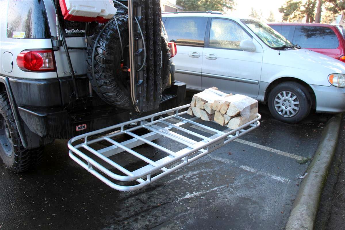

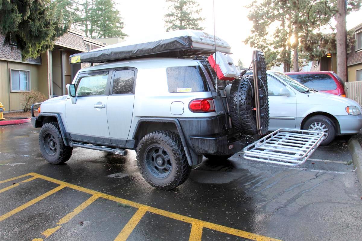

When I got the item earlier in the week, it would not go into the receiver all the way, and the owner got a hold of me, and a lot of the receivers out there are open in the back that points forward to the front of the rig.
Not mine, mine is a bolt on receiver by ARB for the ARB rear bumper.
The solution was to hacksaw off around 3/4" of 2" square aluminum stock, and that did the trick.
Only took me around 40 minutes non stock hacking away with a new hacksaw I bought last year.
It added about 2,300 steps to my Fitbit tracker I wear too, nice...
I only had two bundles of firewood to test, but there is room for eight bundles total laid down flat like the two in the picture.

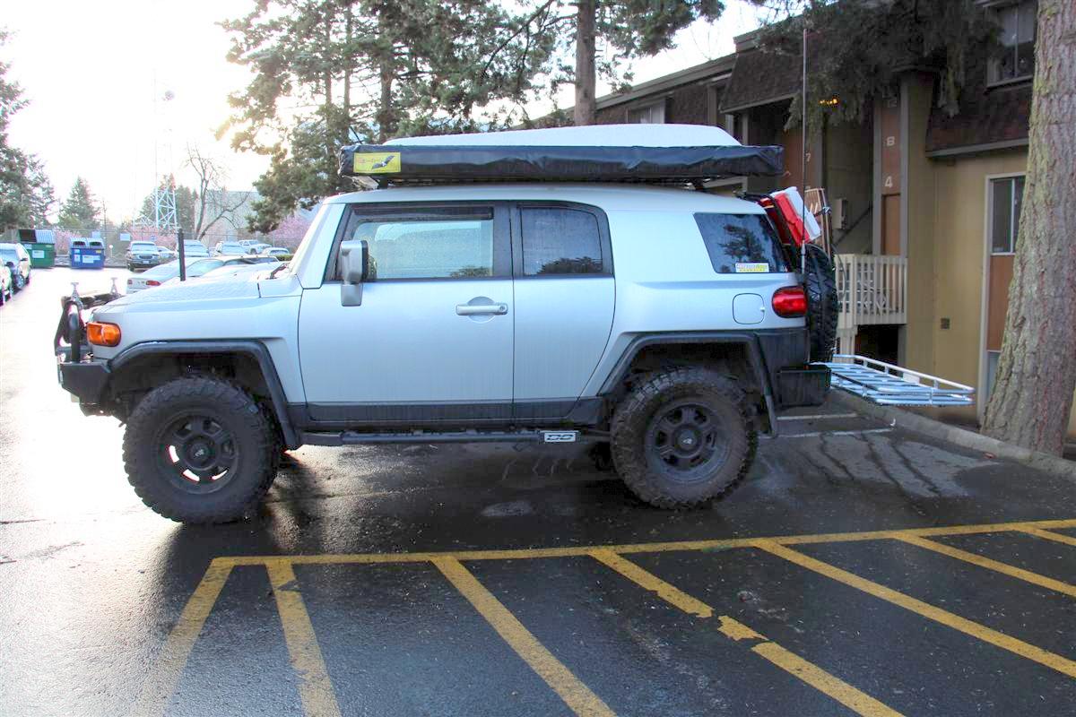

Side shot, extends out some, hope the @sshole tailgaters stay back
Will add a trailer light to it to connect to the factory trailer package wiring at a later date
Test fitted with two bundles of wood, there is room for eight total laid in a single layer flat
Plenty of wood for several days, plus I can look for downed wood on forest service land for free.

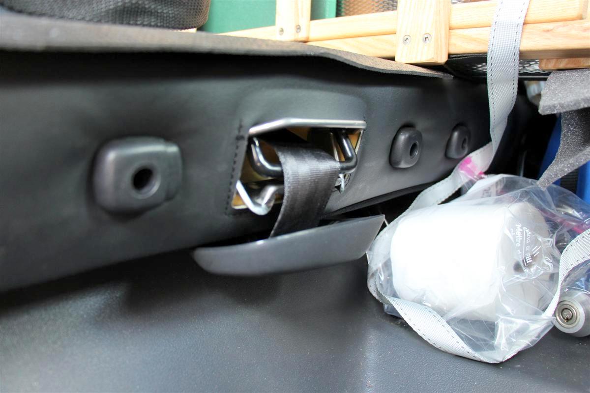

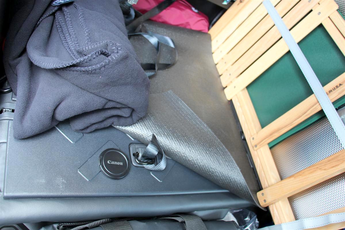

Previously I was using a D ring built into the folded down seat back, but the problem with that was it was actually underneath the gear.

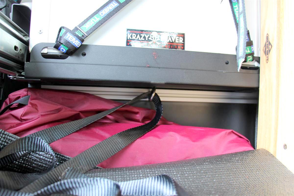

I discovered today there was a plastic cover over the seat belt by the head rest inserts, and when I removed it, there were two different heavy duty bars there that I could use to secure one of the Bihlerflex hooks to.

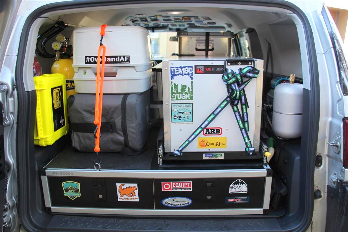

The other end of the bungee goes to a Goose Gear Module Anchor ring that goes into their tracks on my cargobox from them.
You can also see one of the Goose Gear rings in the picture from the rear door view.
I like how you can use a second bungee and shorten it and then have it looped into the other bungee that is fully opened/extended.

The stock Toyota D ring I was using, but it let gear slide around a bit due to it not being outboard from the gear, but underneath of it
Removing the plastic cover for the seat belts reveals two nice heavy duty anchor points for a strap or a bungee

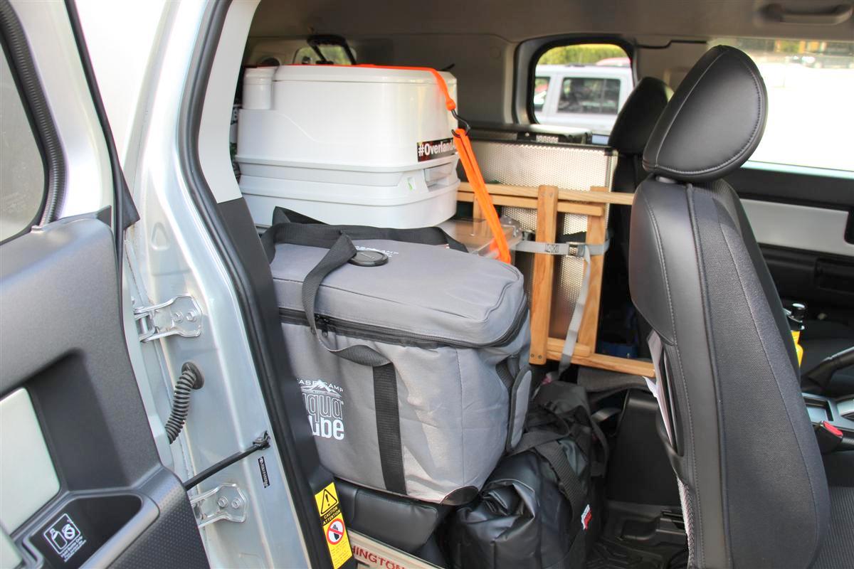

Two bungees in place over the Thetford toilet, and the 60 liter Alu-Box that contains all of my dry food
Next to it in the gray case is my propane Mr Buddy shower/kitchen faucet setup that I am going back to this coming season.

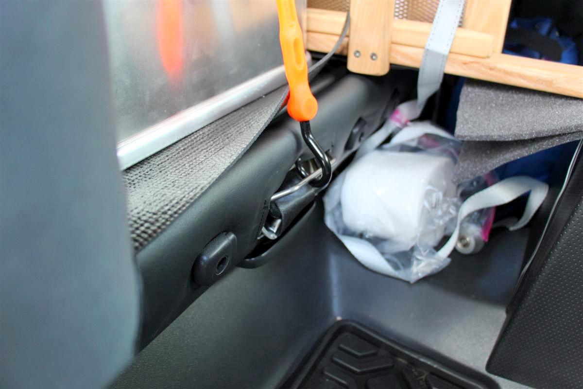

Bungee hook over one of the bars, very secure with tension on the bungee
