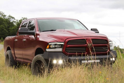

I Also drive a ram 1500 with the 5'7" bed. I have a roll up cover that is nice to keep everything in the bed covered and clean when mudding. But I have been browsing for about a year for (used) camper shells or racks for it, only to come up short..... literally. It is so common to find anything for the 6.5 bed but not very much for ours. Also it seems like anything new is just as expensive or more for the short beds vs the 6.5 or 8 foot beds.received_462929264108147.jpg

I Also drive a ram 1500 with the 5'7" bed. I have a roll up cover that is nice to keep everything in the bed covered and clean when mudding. But I have been browsing for about a year for (used) camper shells or racks for it, only to come up short..... literally. It is so common to find anything for the 6.5 bed but not very much for ours. Also it seems like anything new is just as expensive or more for the short beds vs the 6.5 or 8 foot beds.View attachment 117725
Maybe the better way to go is with a trailer of some sort. Might be easier to load and unload too, keeping your truck free of the massive stuff like RTT etc. !
Reactions: MOVE.OVERland
