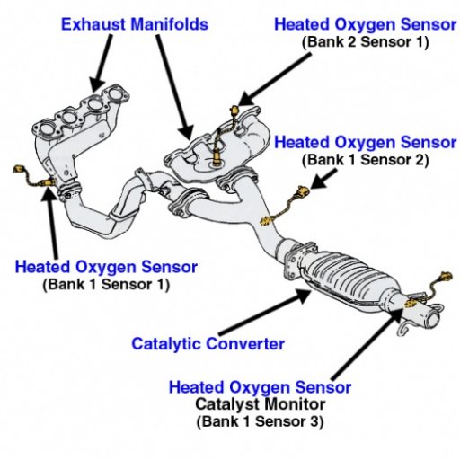

I am assuming you have the 4.0 inline 6 that Jeep put in most of their vehicles. I would start by checking all of you spark plug wires. (Check for rubbing, burnt sections, or even crimped and cuts.) From there replace the coil packs if you haven't. If this hasn't solved the issue I would start following all of the wires around the exhaust manifold. I had a wire loom there on my jeep that had come disconnected from a bracket that had fallen on the manifold and burnt a hole through the loom and some of the wires. (depending on year the side of the engine bay can change this.) After that I would take and ohms meter and test the O2 sensors. On the Jeep I would put in Mopar o2 sensors. (after market ones work but don't tend to last from my experience.) The o2 sensors will be located on the exhaust. (see image) I would also check the fuse panel for any blown fuses. (there are more than fuse panel. I dont' know where they all are on your xj.) Most of the fuse panels on jeeps I have worked will have one in the engine bay, another in the glove box (idk if this is also on xjs or not) and sometimes near the drivers side under the left side of the steering wheel. From there I would start checking sensors. Hope this helps. If you have any questions Ill try and answer them.
Hey, thank you for your response. I recently figured out the issues, it was the cyl 2/5 fuel injectors/sparkplugs, the head gasket, and the thermostat sensor/housing. However, and maybe you know better than me, my cyl 2 is still misfiring (sometimes it throws a code sometimes it doesn’t) and it throws even though it runs smooth, starts up smooth, and has a smooth idle. Someone mentioned heat soak, I’m worried it’s carbon build up. But it’s ONLY cyl 2.
