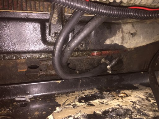

Last weekend I got a smittybilt xrc 9000lbs winch installed. I used a smittybilt winch plate for a 87-06 wrangler knowing the frame rails are wider on a wrangler I could cut it down.
Before I cut the winch plate I noticed that how the power steering cooler was mounted the winch would not fit so I bought a generic transmission cooler, ran 1/2in hose from the cooler to the original lines an h and made a mount to attach to stock mounts behind the grille.
I cut the winch plate on the inside of the bolt holes, I also notched the lip on the back of the plate to fit inside the fzj frame rails. I attempted to drill new holes to line up on the frame holes but it ended up being too much of a pain and I just welded the plate on.
The smittybilt xrc winch has 3 mounting points for the control box only two will work with the stock bumper but both made it very difficult to plug in the controller, so I mounted the box to the passenger frame rail.
Because of the shape of the bumper the fairlead could not be mounted completely straight on the rope rubs on the fairlead, so I decided to strengthen the bumper so when pulling at weird angles the bumper is not bent.
