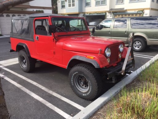

Thus started my long search for a CJ-8. It’s amazing how stupid expensive they can be. After about 10 months of searching I found one relatively local and for a reasonable price no less.
I count myself lucky that the search was that short. While it was not in excellent condition, it drove. It will make a great base for the awesome build I had envisioned.
The first things I did to it were to install a CB and a cheap Harbor Freight winch. As well as a cheap 20” light bar. I immediately started wheeling it. It did surprisingly well despite being open diffs.

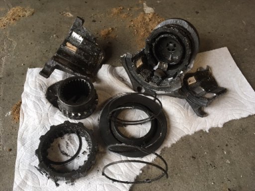

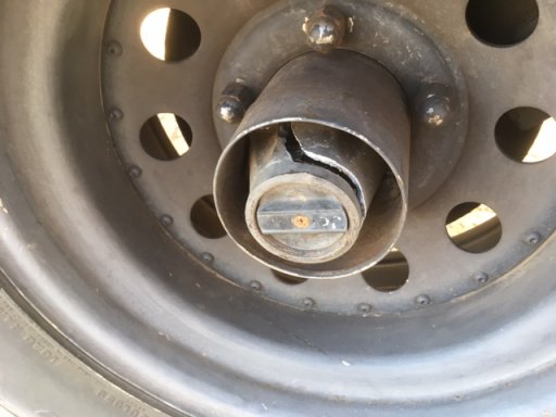

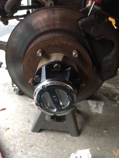

Fortunately in between the gremlin fighting, I have been wheeling and subsequently breaking things. The first thing to go was the front locking hubs. After some research I found that this is a rather common issue, and if you were to have anything fail on you, that’s what you want to fail. Some people call it a torque fuse, and it’s super easy to replace. Of course I didn’t have a spare one on me so that ended my wheeling for the day. I replaced them with Makers Mark locking hubs, and those things are way beefier. I guess my axles shafts will now be the torque fuse! Also I now carry a spare locking hub, although I prob won’t ever need it.

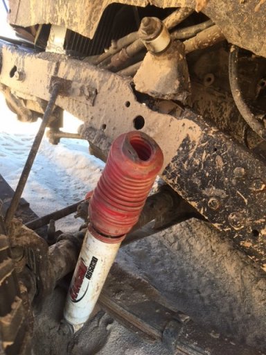

The next thing that broke on me was my driver’s side shock and shock mount. Somehow at some point the head of my shock sheared off and the whole shock mount basically tore off the frame.
Clearly this was an old break as there is mud covering the edges of the break. I hadn’t noticed that anything was wrong as the ride so rough anyways. I discovered the destruction after I had dug myself into a hole out by the blow sands in Ocotillo Wells.
(my dad just so happen to call while I was trying to extract the broken shock)
Walking around the vehicle to inspect how bad of a predicament I was in, I noticed that the driver’s side front shock dust boot looked remarkably like a limp noodle. Thus I found carnage, and more concerning a completely taught brake line. Also I noticed that the frame was actually cracked as well. This is great, just great. I gently recovered myself, and proceeded to drive the 2hr drive home. Ignorance is truly bliss. I have no idea how long I have been running around with a broken shock, cracked frame and a brake line doubling as a limiting strap, all the while truly happy as a clam. Now I couldn’t drive home more carefully. I was sure that any pot hole would do the frame in.
